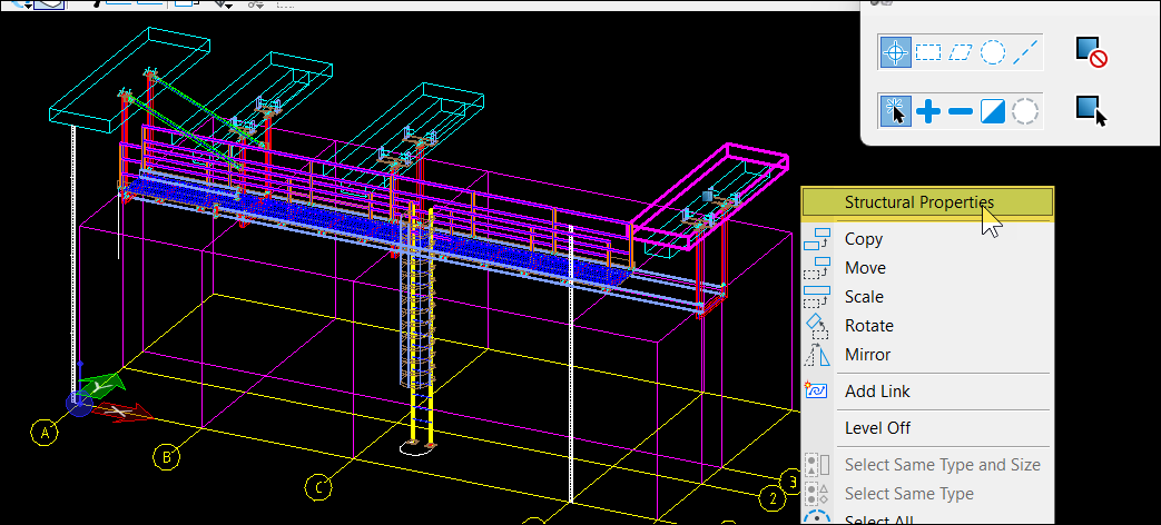

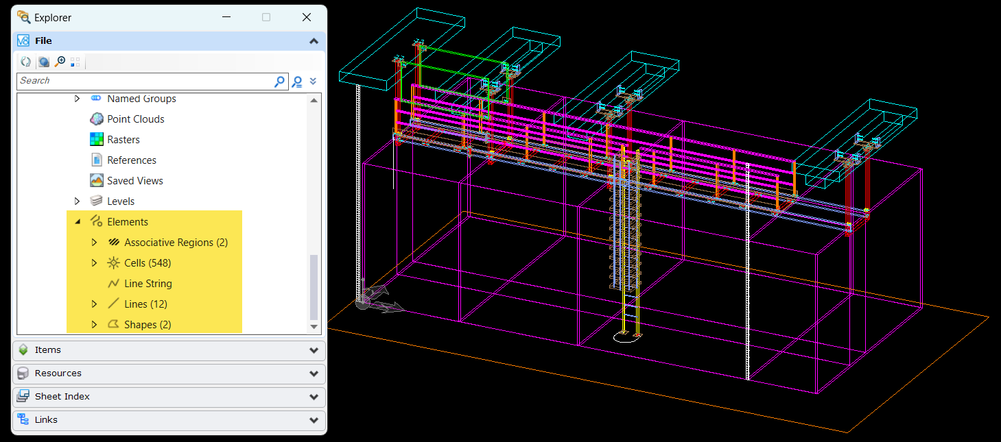

When opening/importing ProStructures for AutoCAD DWG file in ProStructures 2024 all objects are showing as cells, please refer the below snapshot from ProStructures 2024.

As a solution, you need to use either ProStructures Update 7.2 or ProStructures 2023 which supports the upgrade process of old ProStructures for AutoCAD based dwg files to the dgn file without any issues. Once the file is upgraded to dgn then you can use this dgn file in the latest version.
NOTE: You can have both versions (U7.2 and 2023 and (or) 2024) installed in the same machine as ProStructures 2023/2024 supports side by side installation.
