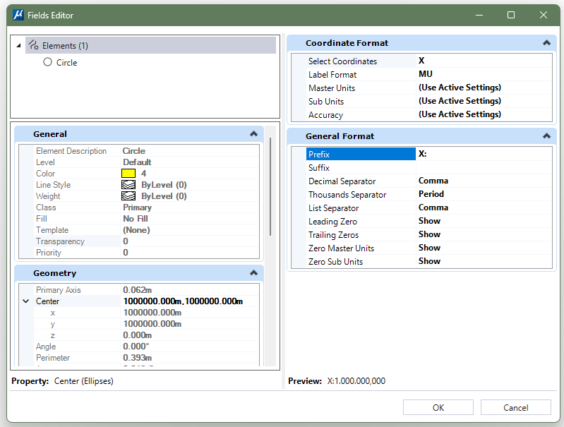

Here we demonstrate creation of a cell utilizing a Placeholder Cell Properties type Text Field to achieve functionality similar to that of the Label Coordinates tool.
'decimal comma' formatting is achieved through formatting options (Decimal Separator, Thousands Separator) specific to the Text Field.   As Text Field use involves de-facto display of the  Text Field background, we conclude with demonstration of some options applicable to Field display modification.
* An alternative to Placeholder use, could be Element Properties Field Type applied to another element expected to exist within the resulting cell. (e.g. Center property of a Circle element).  Also shown: Prefix and Suffix can be applied wholly within the Text Field if desired to streamline the element formatting, e.g. to allow for use of contrasting field background border.
