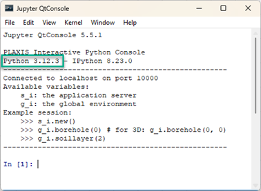

To avoid conflicts with the Python modules which PLAXIS is using (encryption, security, etc.), you are advised to use the same Python version as the one PLAXIS delivers.
For example, in PLAXIS 2024.2 the Python version is 3.12.3.
To find the Python version PLAXIS is using, you can go to Expert > Python > Interpreter and check the version mentioned in the first lines in the Python console window.

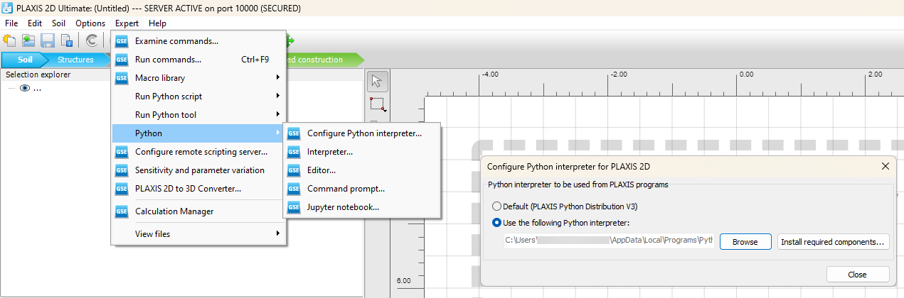

9.      Start a new project and open the Expert > Python > Configure Python interpreter menu option.
10.    In the Configure window, select the Use the following Python interpreter option, and Browse to the directory of the python.exe file from your custom Python distribution:

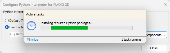

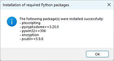

11. Click on Install required components.
12. A prompt window will inform you that all necessary packages have been successfully installed.
