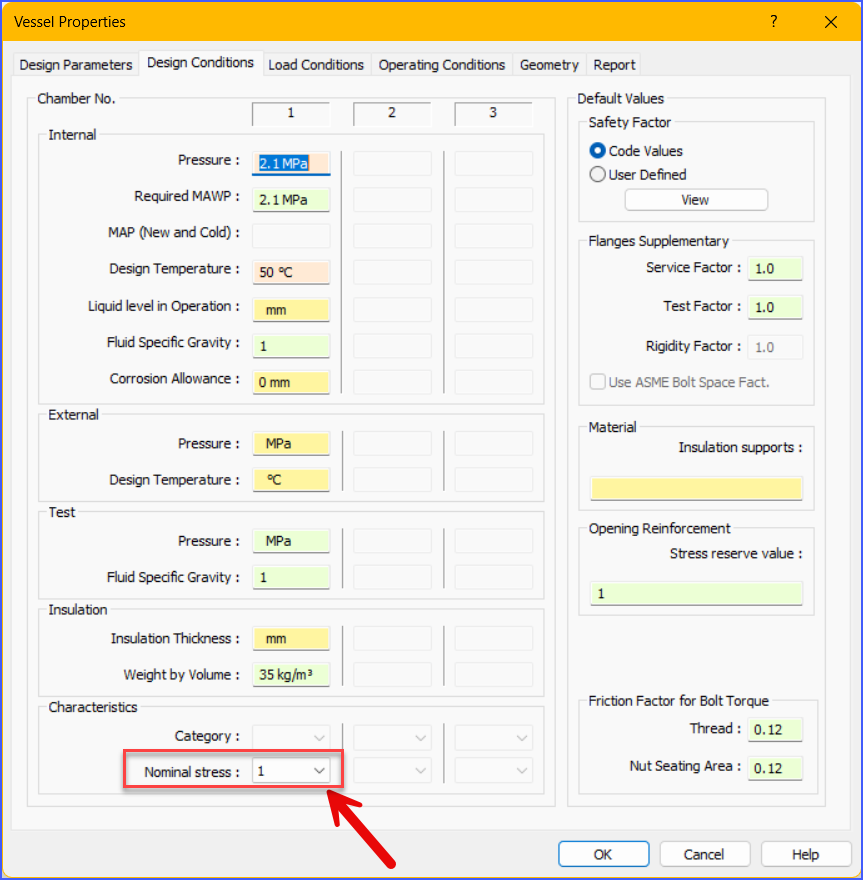

53. What is the meaning of Design Conditions> Characteristics> Category Nominal Stress?
Product(s): AutoPIPE Vessel
Version(s): ALL
Area: settings
Date Logged
& Current Version
Oct 2024
45.00.02.004
What is the meaning of Design Conditions> Characteristics> Category Nominal Stress, when design code = AD 2000?
Please refer to Code document, AD 2000-Merkblatt W 10, section on stress categories.
Example: 2020 edition, Clauses 3.1 to 3.3.
