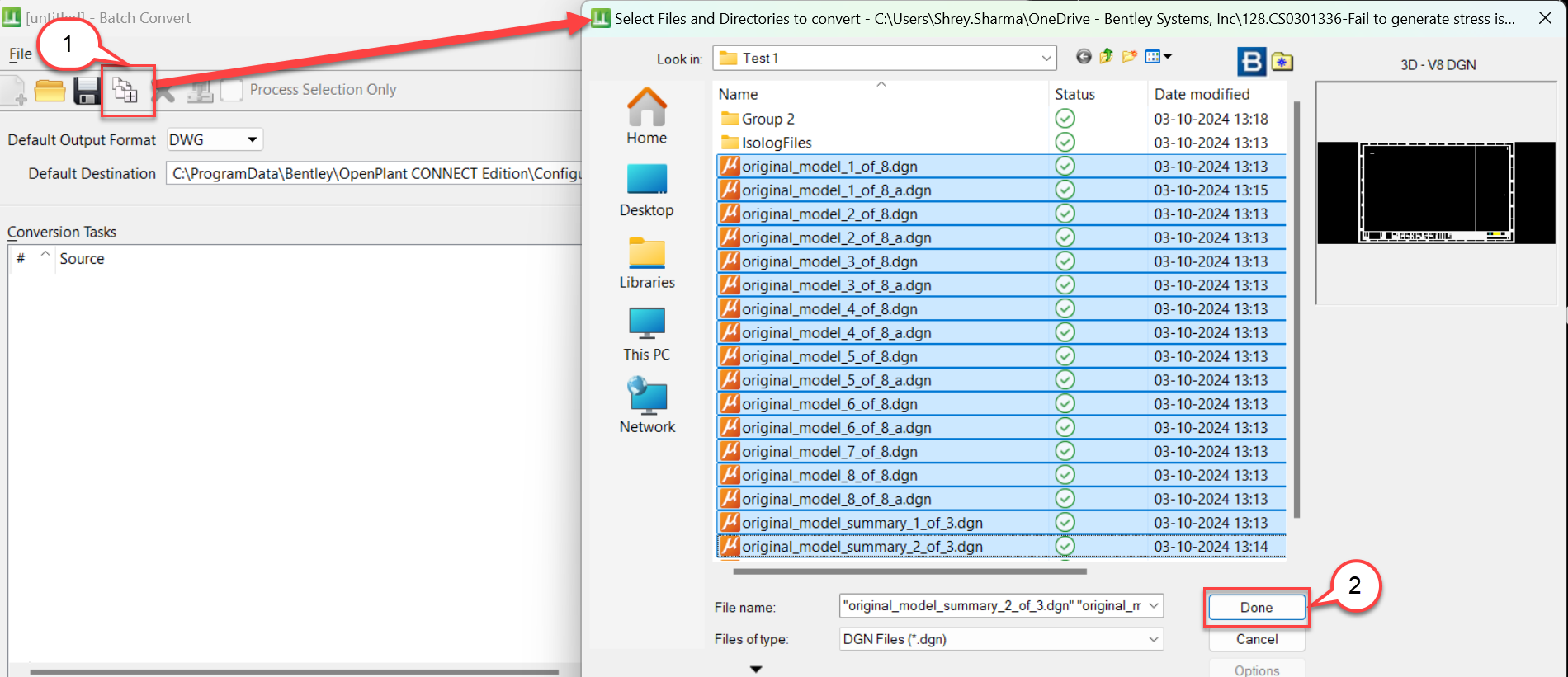

5. Now, Set the Default Output Format as a DWG. See below image.
6. Set the location to save all the converted DWG files.
7. Browse and add all DGN files into Batch Convert directory. See below image.
8. After clicking on Done all the DGN files will get added into Conversion Tasks.
9. Click on a "Process Batch Convert Job" button, "Files to Convert" dialog box will open and then click on "Convert".
10. Wait till process is done, after successful conversion click on Done button.
11. When we click on Close button it will ask to Save Batch Convert Job. Save it at required location.
12. See the output files in the below image.
