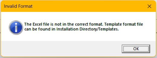

The following is shown when importing an excel file in with Imposed Support Displacements command:
Invalid Format
The Excel file is not in the correct format. Template format file can be found in Installation Directory/Templates.
OK
Why and how to avoid it?
The reason for this message to appear is that there is an issue with the format of the data that is trying to be imported. This file format needs to be 100% correct. Otherwise, the message above will continue to appear.

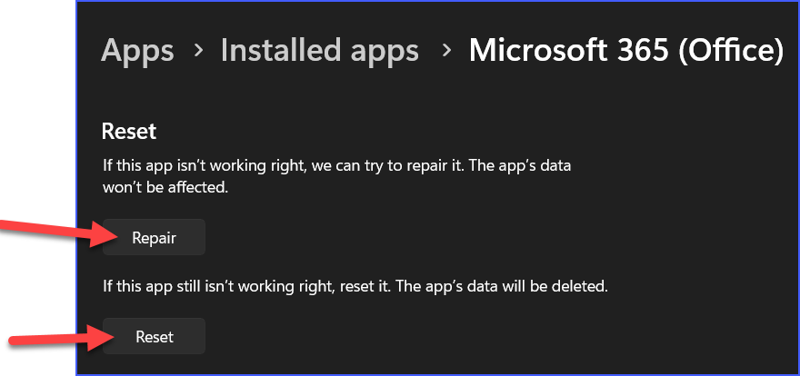

As a general set of instructions:
1.Repair Microsoft Office / Excel
a. Reboot your computer.
b. Open Installed APPS, Microsoft 365 Office and press the Repair and then Reset buttons.
c. This may take period of time during which you should not use any application.
d. After the message mentioning "You're all set!" appears, try to again import the Excel file into AutoPIPE.
