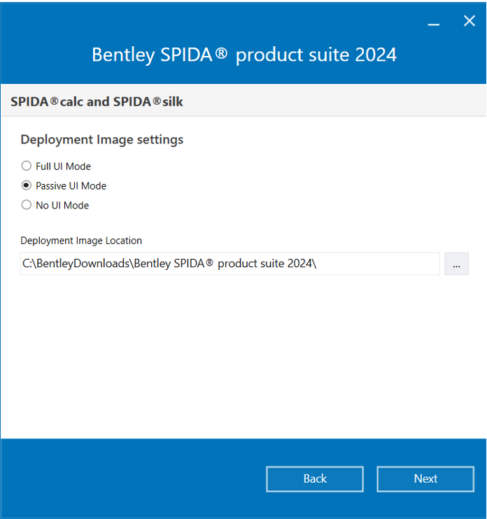

-layout Create a local image of the bootstrapper. **

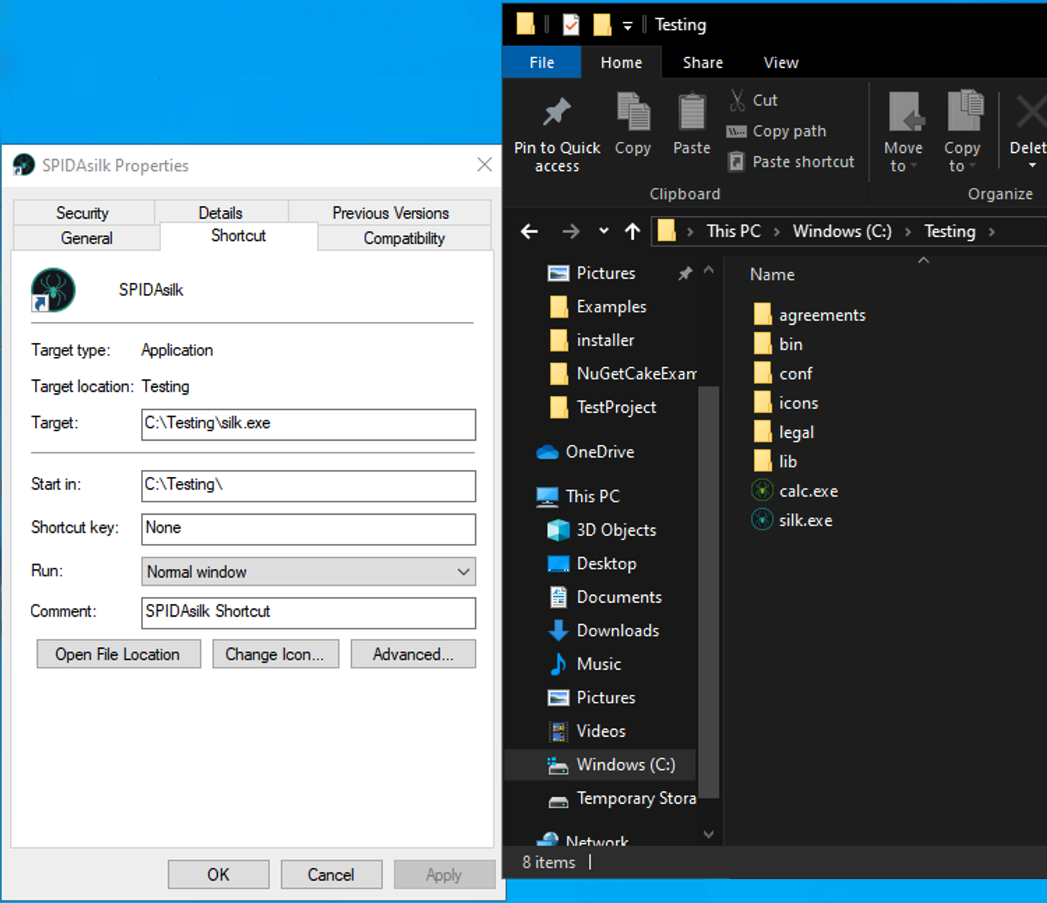

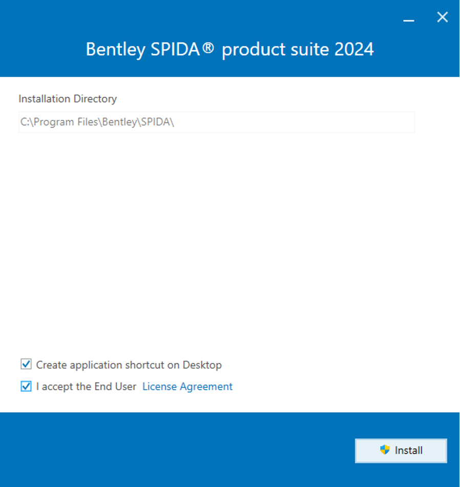

* To perform a silent install with a custom directory, use the form Setup_SPIDACalcx64_24.1.0.124.exe InstallDirectory=<CustomDirectory> -q, e.g., Setup_SPIDACalcx64_24.1.0.124.exe InstallDirectory=C:\Program Files\Testing -q
** Using the -layout option, system administrators can control install locations, desktop icons, and the installation UI. A silent installer that doesn't need a command line argument can be created.

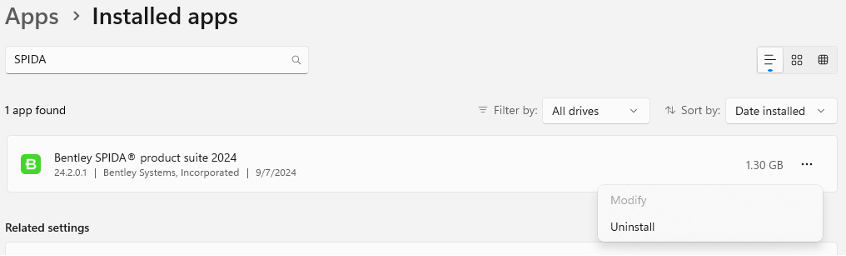

The SPIDA MSI file checks for the existence of a previous installation. If present, the software can not be installed using this MSI file. In contrast, the bundle installer can silently uninstall the previous version and proceed with the installation. If the uninstallation fails and the registry entry still exists, the installation cannot continue.

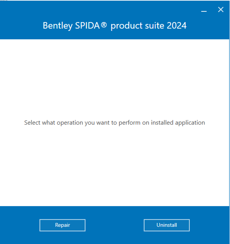

There is a workflow change compared to the installers for SPIDAcalc and SPIDAsilk v24.0 and older. Now, if the same version of the product is already installed, running the installer will present the user with a repair/replace dialog box.
In the Windows "Installed Apps" section, there will be no option to repair, only to uninstall.
