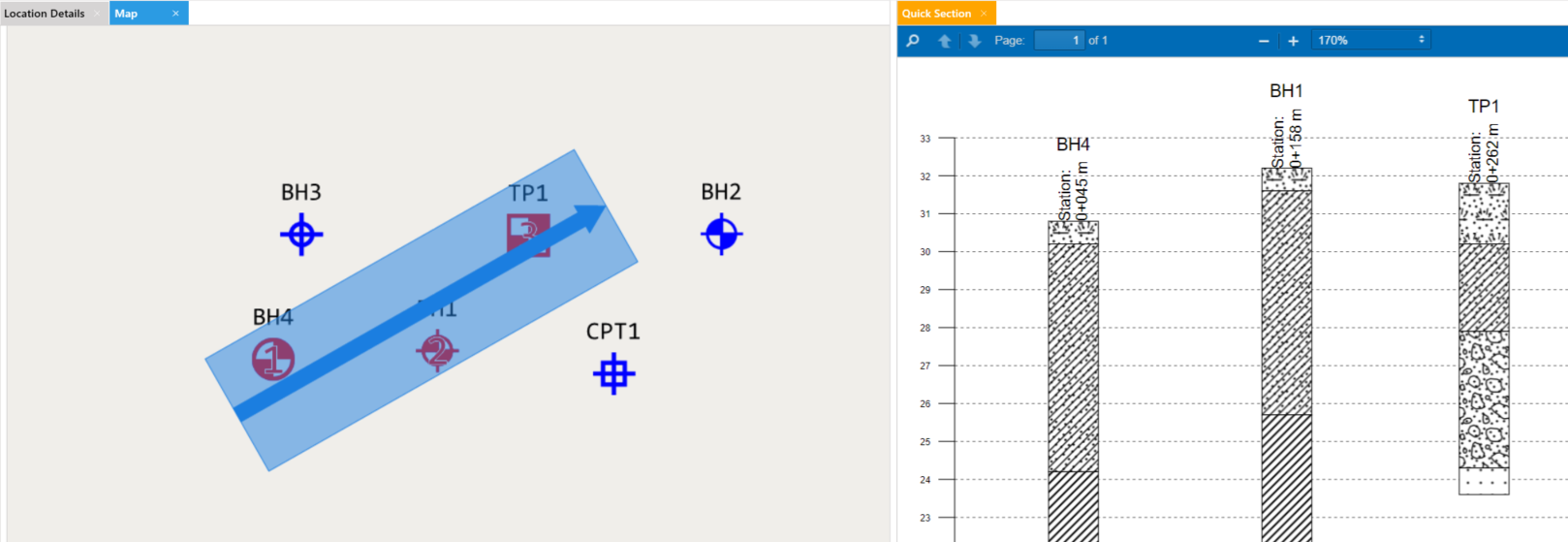

[Section.Offset]

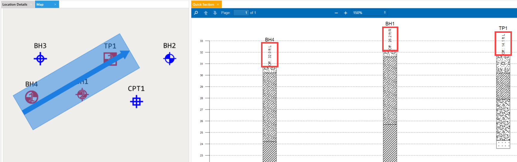

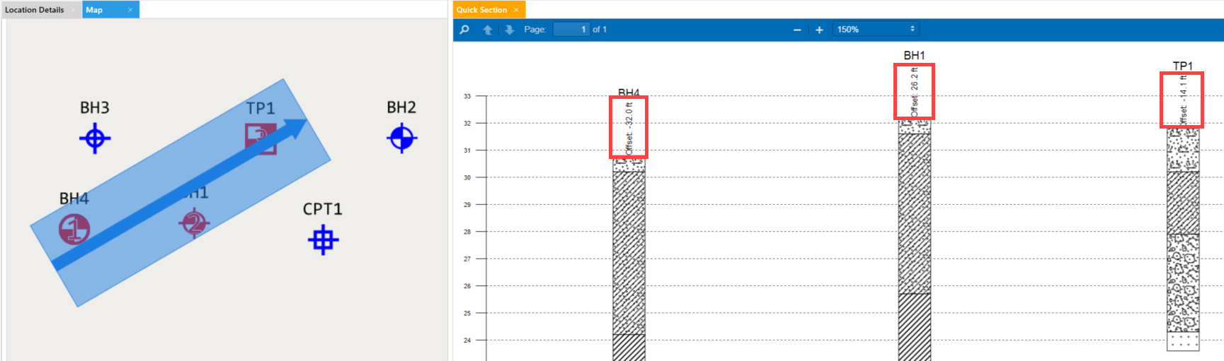

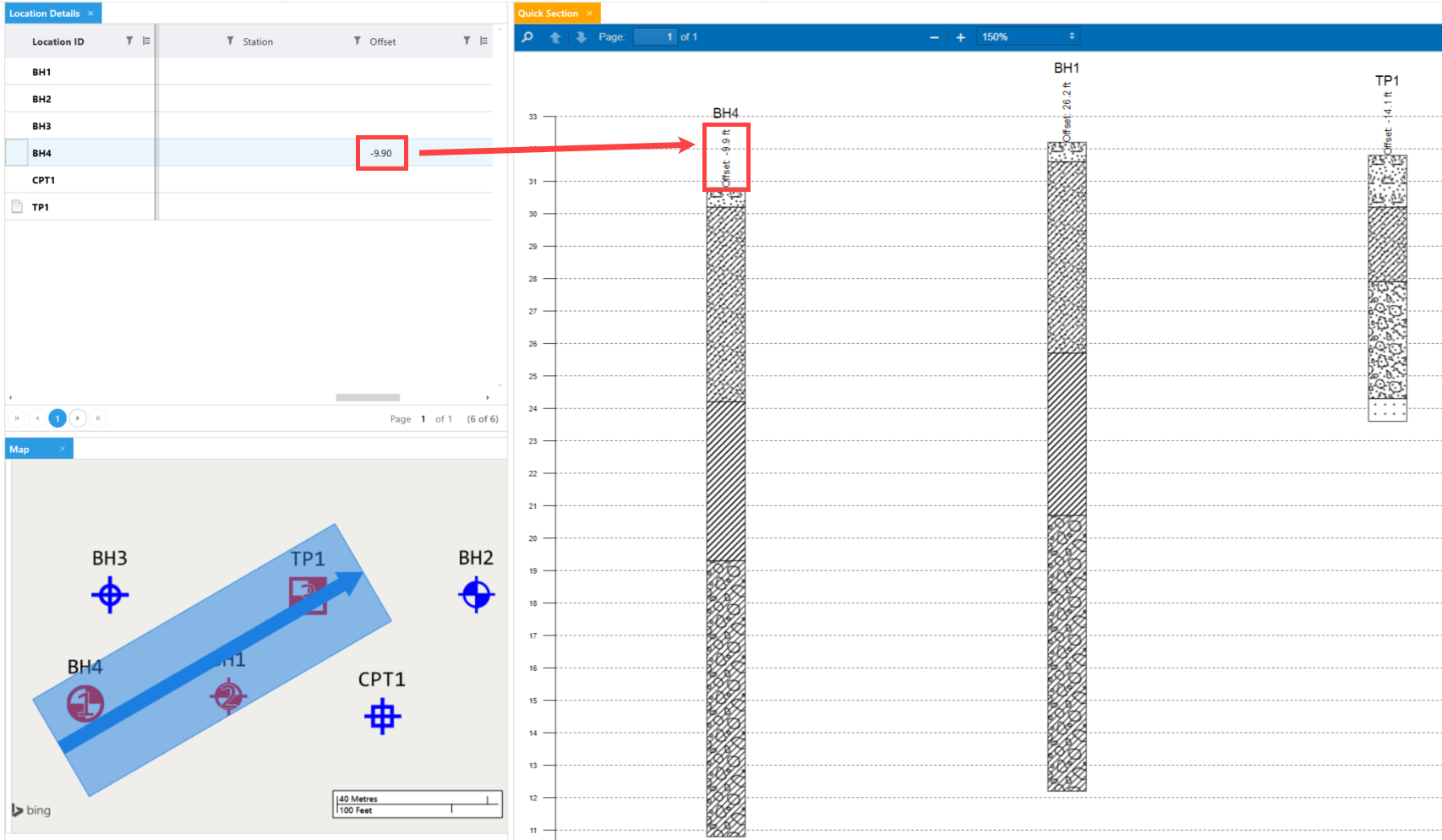

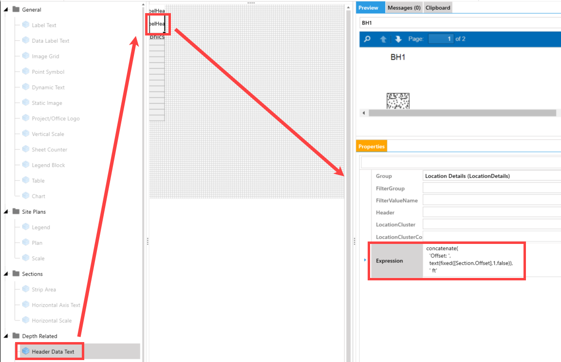

[Section.Offset] can be used on a Quick Section Strip to return the perpendicular offset of a Location from the Quick Section baseline.
Basic usage
This expression will return the offset for each Location to 1 decimal place. In this example (and others below), it is used in a Header Data Text item in the header area of the Strip. A positive offset indicates the Location sits to the right of the Section Line and a negative offset to the left (looking along the Section baseline from starting point to end point).
concatenate(
  'Offset: ',
  text(fixed([Section.Offset],1,false)),
  ' ft'

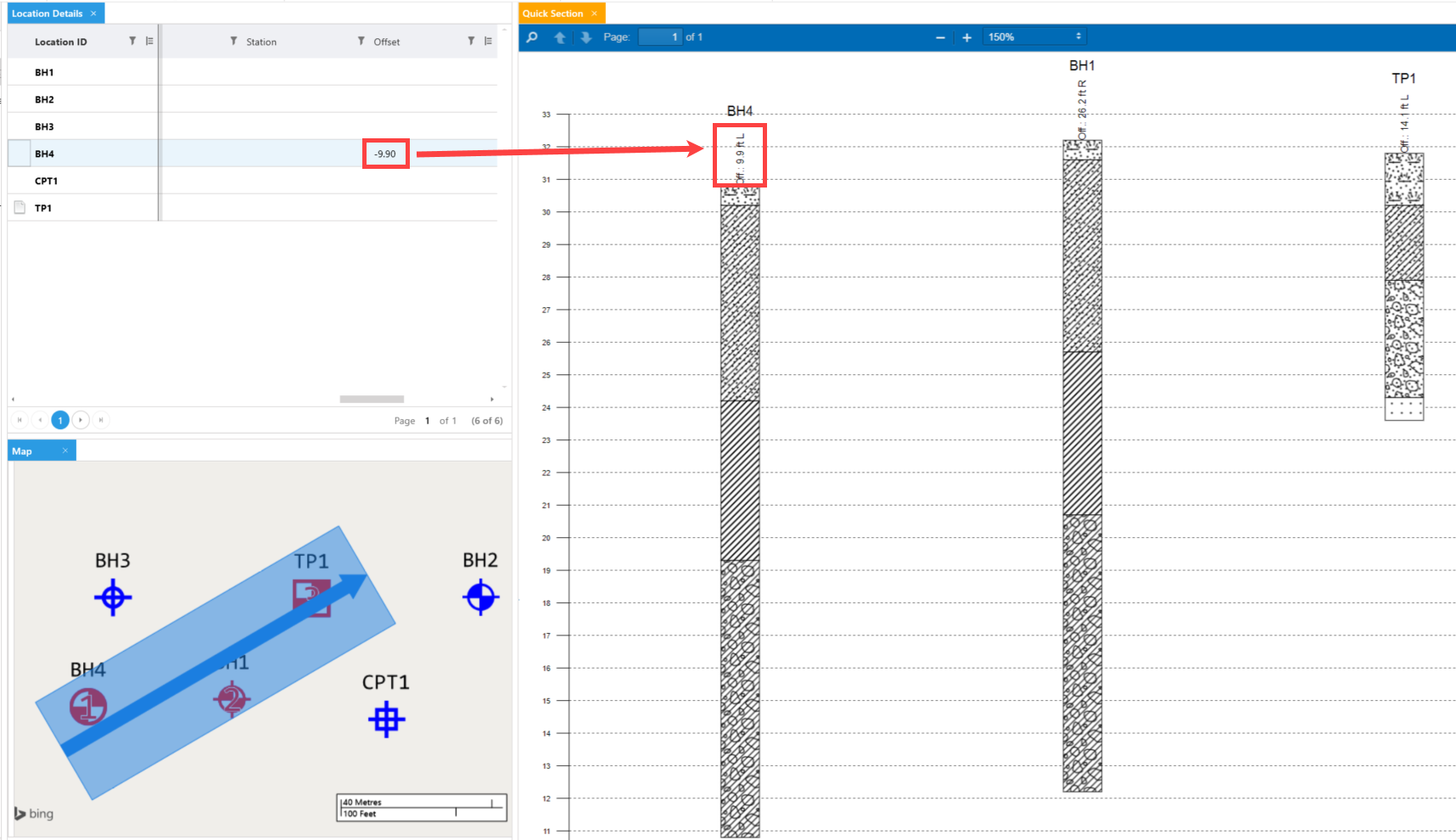

Reporting Offset as Left or Right of Section Line
This expression will report the offset as left or right of the Section Line rather than as negative or positive.
concatenate(
  'Off.: ',
  text(fixed(abs([Section.Offset]),1,false)),
  ' ft',
  if(
    value(fixed([Section.Offset],1,false))>0,
    ' R',
    if(
      value(fixed([Section.Offset],1,false))<0,
      ' L',
Overriding with Location Details Offset
An offset can also be stored in the Location Details group. The expression below can be used if you'd like to report [Section.Offset] only when this value is blank. (Essentially, the value from Location Details will override [Section.Offset].
This version of the expression will report the offset as negative or positive:

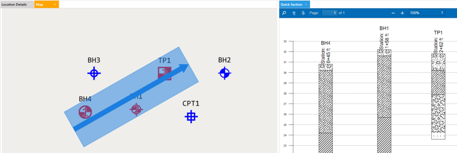

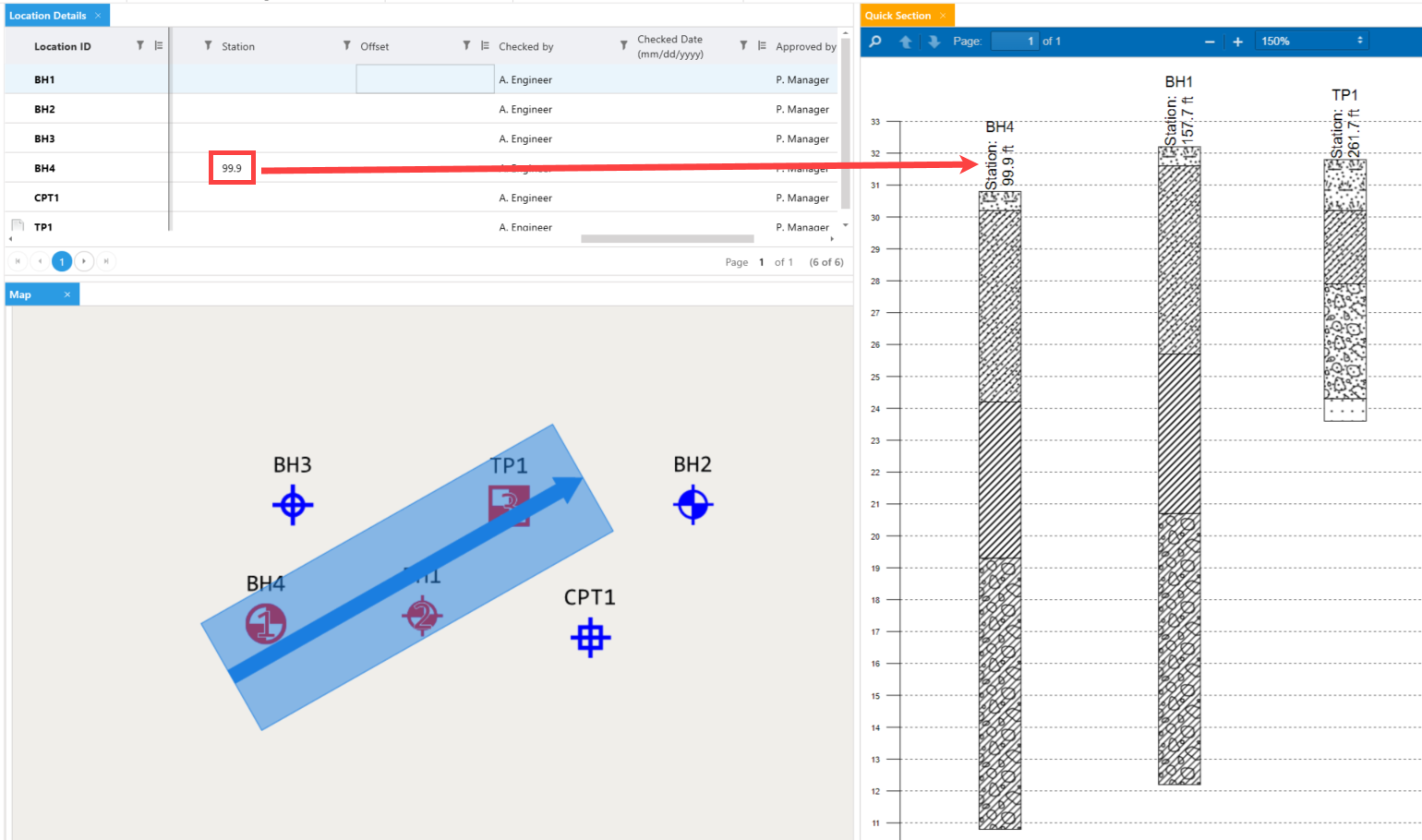

[Section.Chainage] can be used on a Quick Section Strip to return the distance of a Location along a Quick Section baseline. This is commonly referred to as the 'Chainage' or 'Station', depending on what part of the world you find yourself.
Basic usage
This expression will return the distance along the baseline (Station/Chainage) of each Location to 1 decimal place. In the example below, it is used similar to the examples above in a Header Data Text item in the header area of the Strip.
concatenate(
  'Station: ',
  text(fixed([Section.Chainage],1,false)),
  ' ft'
Overriding with Location Details Chainage/Station
An offset can also be stored in the Location Details group. The expression below can be used if you'd like to report [Section.Chainage] only when this value is blank. (Essentially, the value from Location Details will override [Section.Chainage].
Note the database name for this header is LocationDetails.Chainage, but it might be labelled as Station depending on which configuration pack you are using to reflect local terminology.
concatenate(
  'Station: ',
  if(
    isblank([LocationDetails.Chainage]),
    text([LocationDetails.Chainage])
  ' ft'

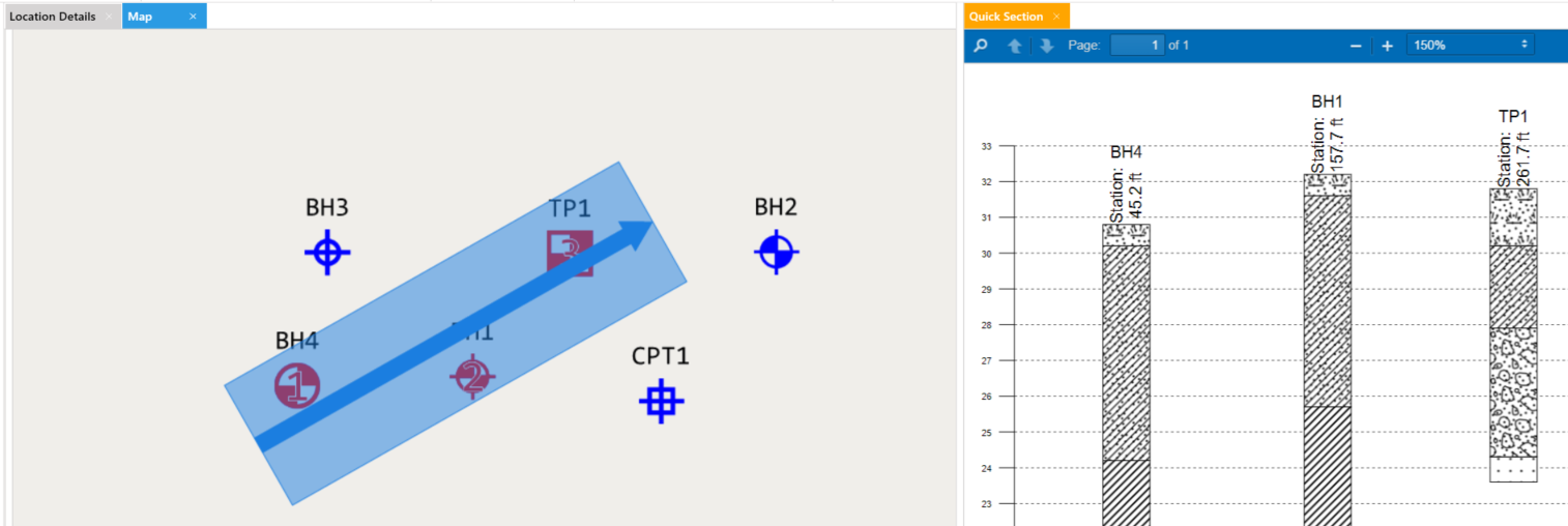

Station formatting
It is common in many parts of the world to report stationing with special formatting. For example, a Station of 1400 ft may be formatted as 14+00 ft.
The expression below can be used to report [Station.Chainage] in this format. This expression can be modified, such as to report stationing with additional decimal places.
concatenate(

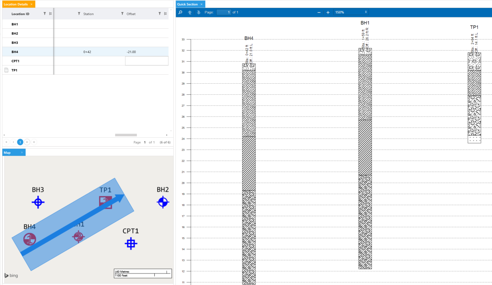

Putting it all together for Chainage & Offset
The expression below combines the above examples for [Section.Chainage] and [Section.Offset]. It will report values that have been entered into Location Details, but otherwise use the Section Functions. It will report offsets as left or right of the Section Line, and it will also format [Station.Chainage] using station formatting.
concatenate(

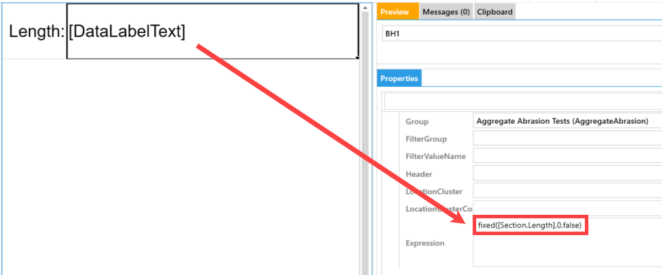

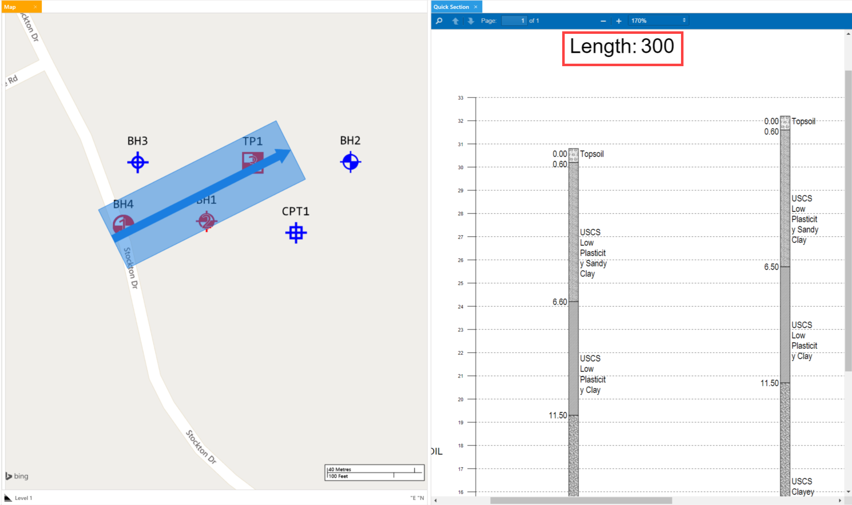

[Section.Length]
This function returns the length of the Section Line (or portion of the Section Line if the Horizontal Start/End properties are used) used to draw the Quick Section.
For example:
fixed([Section.Length],0,false)

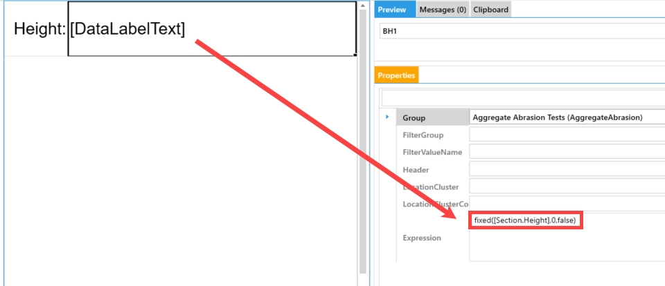

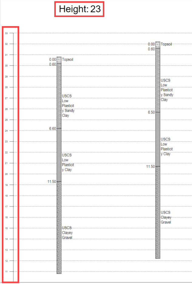

[Section.Height]
This function returns the vertical height of the Quick Section (in depth/elevation units).
For example:
fixed([Section.Height],0,false)

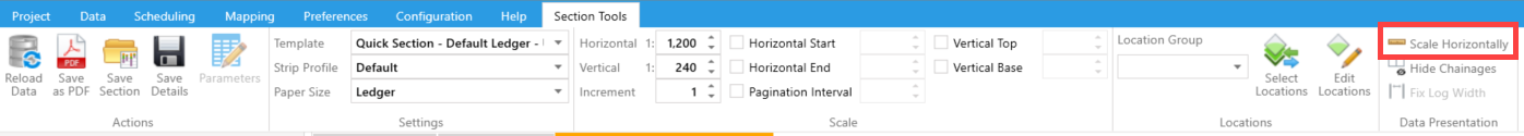

[Section.HorizontalScale]
[Section.VerticalScale]
[Section.HorizontalScale] and [Section.VerticalScale] can be used on a Quick Section template to return the denominator of the Scales.
For example, a 1:100 scale would mean that 1 m on the Section would represent 100 m in real life (or similarly, 1 ft on the Section would represent 100 ft in real life).
In this scenario,
or
would return 100, the denominator of the ratio.
This function is useful for setting appropriate Grid/Tick Intervals on Strip Areas. For an example, please see the Grid Tab>Interval topic within the Strip Area article.
Please also see additional examples in this guide to working with Imperial units/scales on Quick Sections.
Note: If the Scale Horizontally option is not used, [Section.HorizontalScale] will not return anything.
