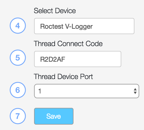

Adding a Roctest V-Logger
Ensure that the THREAD is turned on and connected to the V-Logger via one of it's Device ports.
1. Navigate to the Network Module
2.  Press the  button directly on a THREAD to add a Device to it. If your THREAD does not appear here, you may still need to Add Your THREAD as a Connection.
3.  You may also add a device from the  button in the Devices & Sensors Section
4.  Begin by typing in "Roctest V-Logger" and select the name once it autocompletes in the search boxA logo with blue lettersDescription automatically generated
5.  Type in the Connect Code of the THREAD that the Device will be connected to. It will already be pre-filled if the  button on the THREAD was used.
6.  Next, select the THREAD communication port that the device is plugged into, Device 1 or 2.
7.  Press   A blue rectangle with white textDescription automatically generated  to write the settings
sensemetrics will automatically detect the V-logger connected and will bring in serial number, number of channels and model number.

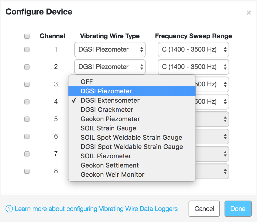

MUX Configuration
The Vibrating Wire Channels on the Datalogger will now need to be configured to the specific VW you are using. Click the "Edit Configuration" button under VW Mux Information.
If you have exited device configuration, click back into the Roctest V-logger by finding it in the Devices & Sensors list on the right hand side of Network. This will open the Device configuration settings.
Select the type of vibrating wire that is on each channel and the suggested Frequency Sweep will be automatically filled in.
Click "Done" when finished and make sure to click "Save" to write the settings.
Once saved, the configured vibrating wire sensors will populate beneath the Roctest V-Logger Device and can be viewed by clicking the drop down arrow.
Additional calibration factors will need to be entered for some types of vibrating wires, see the Vibrating Wire article for details.
