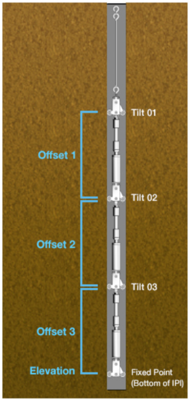

1.  Allows the device configuration for segments, fixed end, offsets, elevation, etc. (can be completed after discovering segments).
   1.1  Fixed End - Determine if the movement will be measured from the first segment (near) or the last segment (far).
   1.2  Mode - Determine if the ShapeArray is installed vertically or horizontally.
   1.3  Segment - Segment number.
   1.4  Offset - Distance between each segment.
   1.5  Elevation - Elevation of each segment.

3.  The distance between 2 reference points. Examples include the total height of the structure from its base or the distance between the 2 anchor points of the beam the tilt sensor is mounted to.
