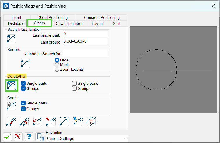

1. Open Positionflags and Positioning tool located at Steel Workflow > Drawing Production > Positionflags and Positioning.
2. Go to the Others tab and under Delete/Fix section select your desire options say Single Parts and Groups and click on the delete icon that appears.
3. A window will appear in which you can Choose all or Filter the objects as per your requirement.
