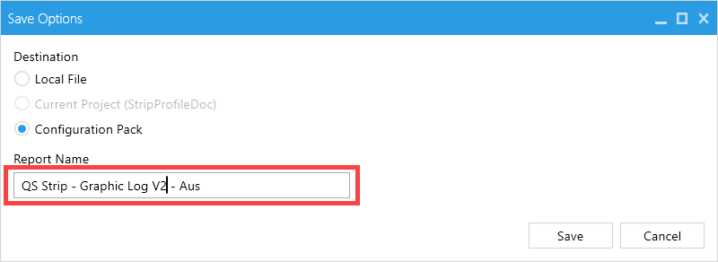

Making a Copy of Your Strips
If any of the considerations below apply to your existing templates, and you need to make design modifications, you may want to make a copy of your existing templates. This will ensure your existing Strip and Quick Section templates continue to work as they currently do should you need them in the future, and then you can modify the copies of the templates.
To do this, click Save and give your template a new name, which will effectively create a new copy that you can modify.
You may want to do this for both Strip and Quick Section templates.

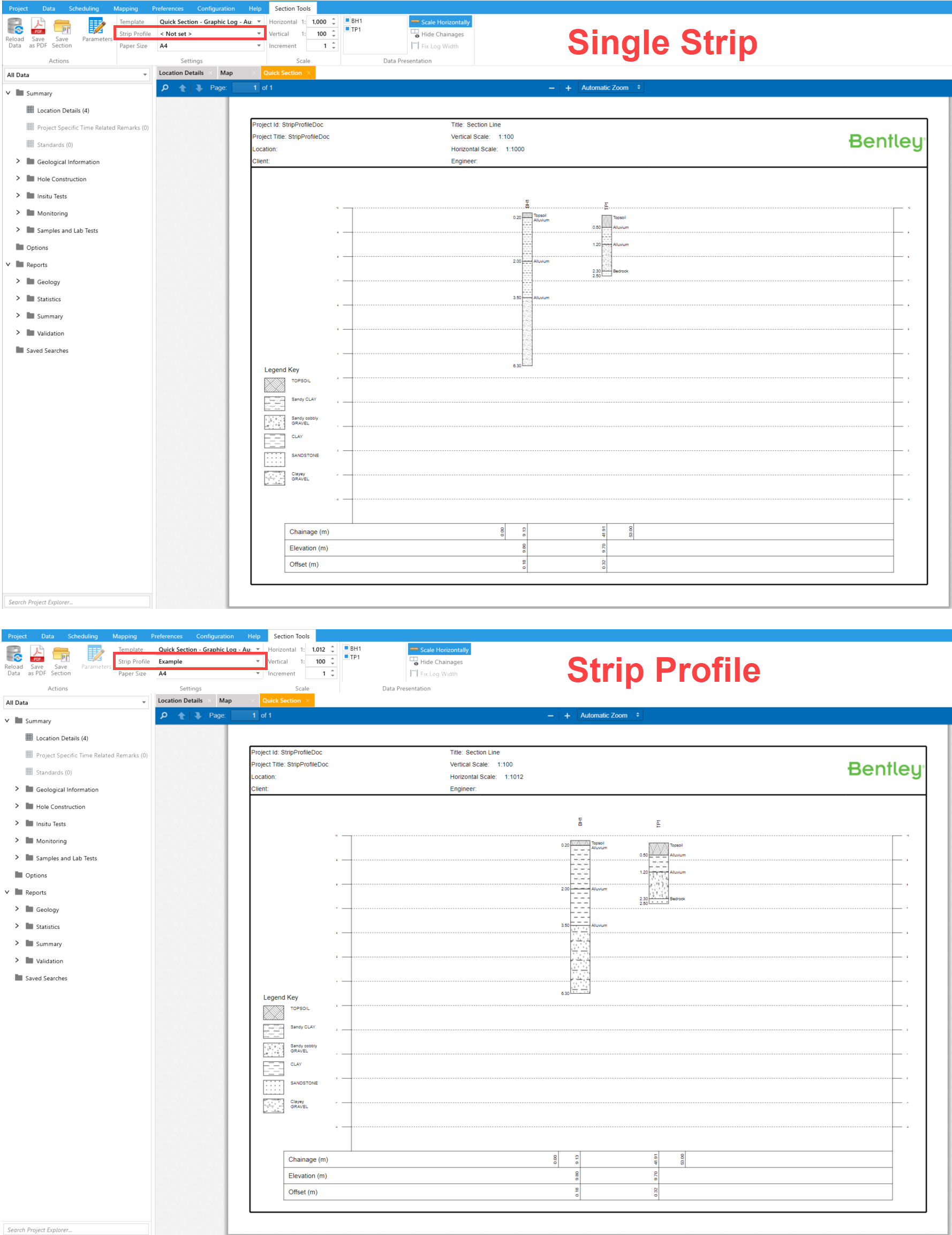

The impact of this is that if you use an existing Strip in a Strip Profile, it may end up plotting much wider or narrower than you are used to.

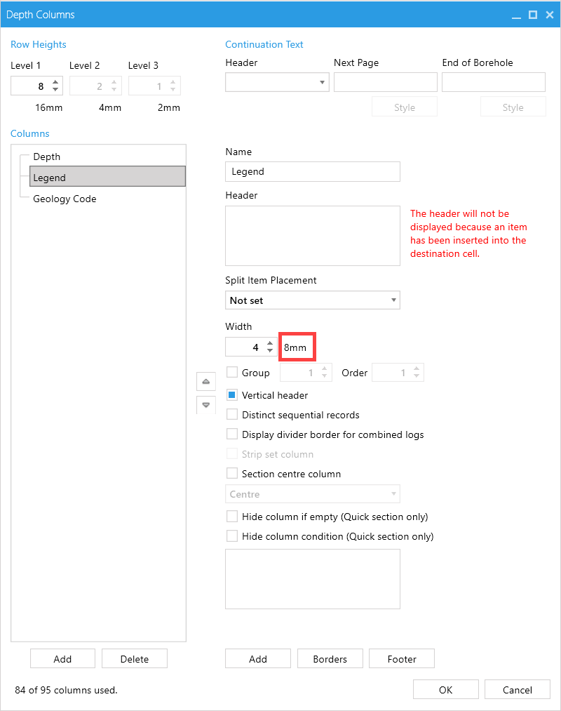

For example, below the same Strip is used on both a single-strip Quick Section and a Quick Section using Strip Profiles. The Graphic column is designed to be 8 mm-wide, as it appears using Strip Profiles, but is 4 mm-wide on a single-strip Quick Section.

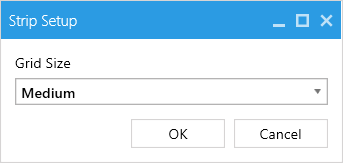

The reason for this is that legacy single-strip Quick Sections do not properly respect the Strip template column widths if the Strip and Quick Section templates use different Grid Sizes.
In the example above, the Strip uses a 'Medium Grid' (2 mm-square cells), but the Quick Section templates uses a 'Small Grid' (1 mm-square cells). When the Quick Section is generated, it uses the Small Grid size for the Strip even thought it is designed with Medium Grids, so the Strips end up plotting at half the design width. The Grid Sizes are defined when you create the Strip template, and can not be changed afterword.

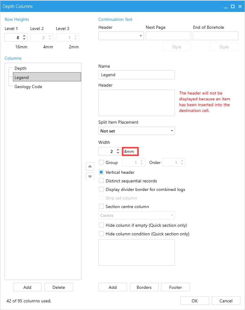

If this occurs for you, you can adjust the column widths by opening the Strip template and going to Design>Edit>Depth Columns. In the example above, the widths could be reduced by half to get a more familiar appearance.
Note that this issue should not occur using single-strip Quick Sections if the Strip and Quick Section templates both use the same Grid Size.
Strip Profile Quick Sections should always respect the Strip template column widths and shouldn't be impacted by the Grid Size of the Quick Section template.

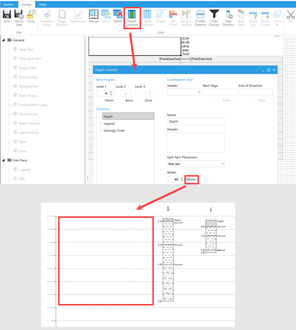

We've observed that some Strips have been designed excessively wide, in which case you will see an unnecessarily large offset.
For example, below there are 80 mm-wide columns to show the Depth and Geology Codes, which results in a large offset.

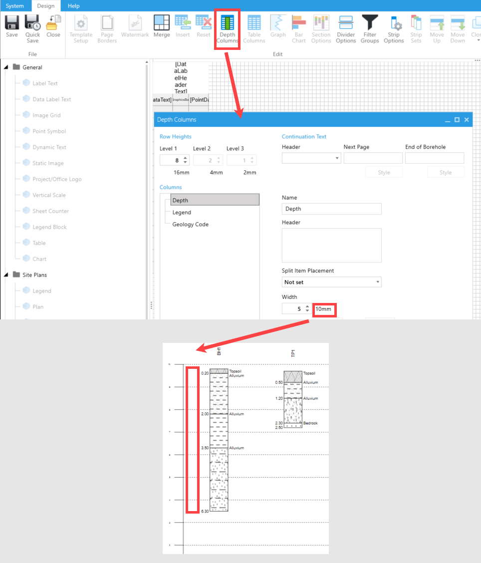

These columns would typically just be short text strings and don't need to be this wide. If they are narrowed, such as to 10 mm-wide, the offset reduces accordingly to a more reasonable amount.
Important - You may need to re-save any Quick Section templates that use the updated Strips for these changes to have an impact (i.e. re-save the Quick Section template itself and not just the Strip) .
