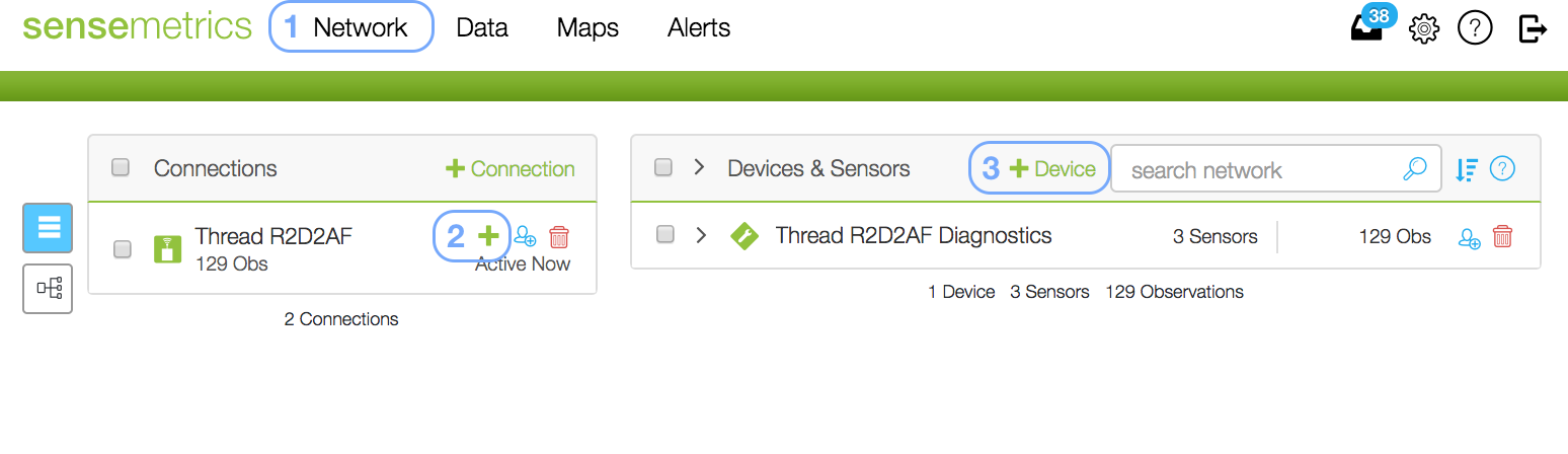

Ensure that the THREAD is turned on and connected to the C3 via one of it's Device ports.
1. Navigate to the Network Module
2.  Press the  button directly on a THREAD to add a Device to it. If your THREAD does not appear here, you may still need to Add Your THREAD as a Connection.
3.  You may also add a device from the A green and blue textDescription automatically generated button in the Devices & Sensors Section

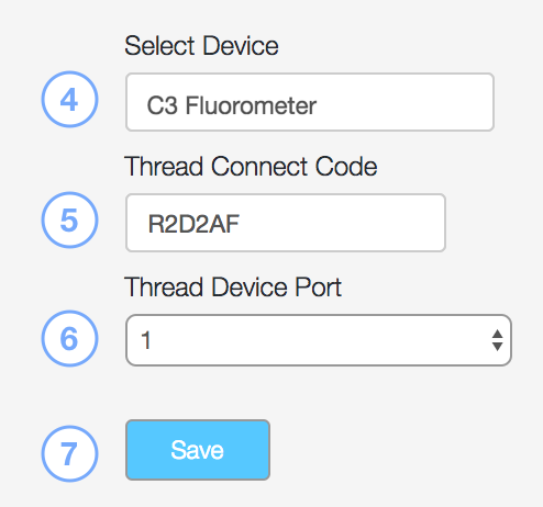

4.  Begin by typing in "C3 Fluorometer" and select the name once it autocompletes in the search boxA close up of a logoDescription automatically generated
A screenshot of a deviceDescription automatically generated
5.  Type in the Connect Code of the THREAD that the Device will be connected to. It will already be pre-filled if the  button on the THREAD was used.
6.  Next, select the THREAD communication port that the device is plugged into, Device 1 or 2.
7.  Press   A blue rectangle with white textDescription automatically generated  to write the settings. Your C3 should now connect to sensemetrics indicated by a green icon A green diamond shaped sign with a lightning boltDescription automatically generated
