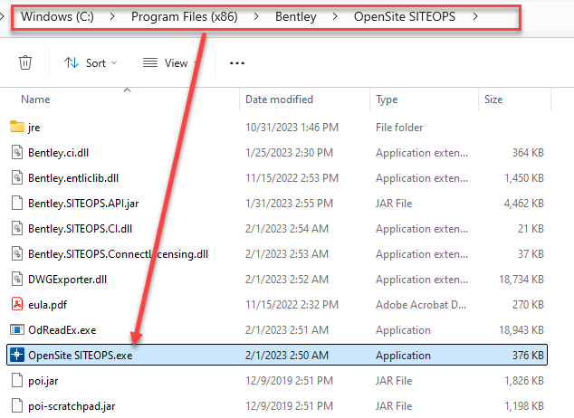

I installed OpenSite 2023, but the shortcut to start it does not show up in the start menu. How do I open SiteOps?
Answer:
Double click the “OpenSite SITEOPS.exe” found in this directory C:\Program Files (x86)\Bentley\OpenSite SITEOPS
