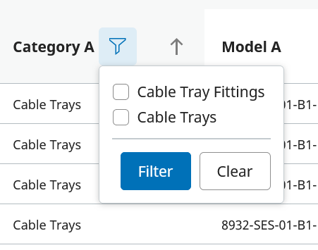

All columns in the Clash results table can be filtered and/or sorted based on user input. Filtering is based on the values within the column, supporting string matching, checkbox value selection, or numeric values.
Filters
Hover over a column to see the funnel icon, which, when clicked, will display the available filtering options.
[Note: The Clash reference number column does not support filtering or sorting.]

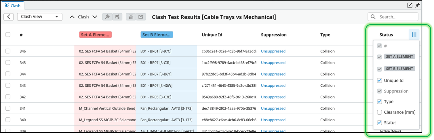

Columns
Columns in the clash report can be enabled or disabled based on user preferences using the vertical hamburger menu. Columns can also be reordered using drag and drop and resized by clicking and dragging.
The available columns are listed and explained below:
- # (Mandatory): Clash number in the report.
- Set A Element (Mandatory): Name of the element clash from Set A.
- Set B Element (Mandatory): Name of the element clash from Set B.
- Suppression (Mandatory): Indicates if the clash has been manually suppressed. Clicking the hyperlink text opens the manual suppression dialog.
- Type (Optional): Displays the type of clash, either Collision (Hard) or Clearance (Soft).
- Status (Optional): Displays the status of the clash:
- New: New clashes for that clash job/test run.
- Open: Existing clash from a previous job/test run that is unresolved.
- Resolved: Either fixed through manual suppression or the elements no longer clash in the latest Clash job/test run.
- Unique Id (Optional): The GUID (globally unique identifier) for that clash within the Project/iTwin.
- Form (Optional): Displays a link to a form if associated with that Clash instance.
- Category A (Optional): Displays the category of the element in Set A within the iModel.
- Category B (Optional): Displays the category of the element in Set B within the iModel.
- Model A (Optional): Displays the CAD Model of the element in Set A within the iModel.
- Model B (Optional): Displays the CAD Model of the element in Set B within the iModel.
