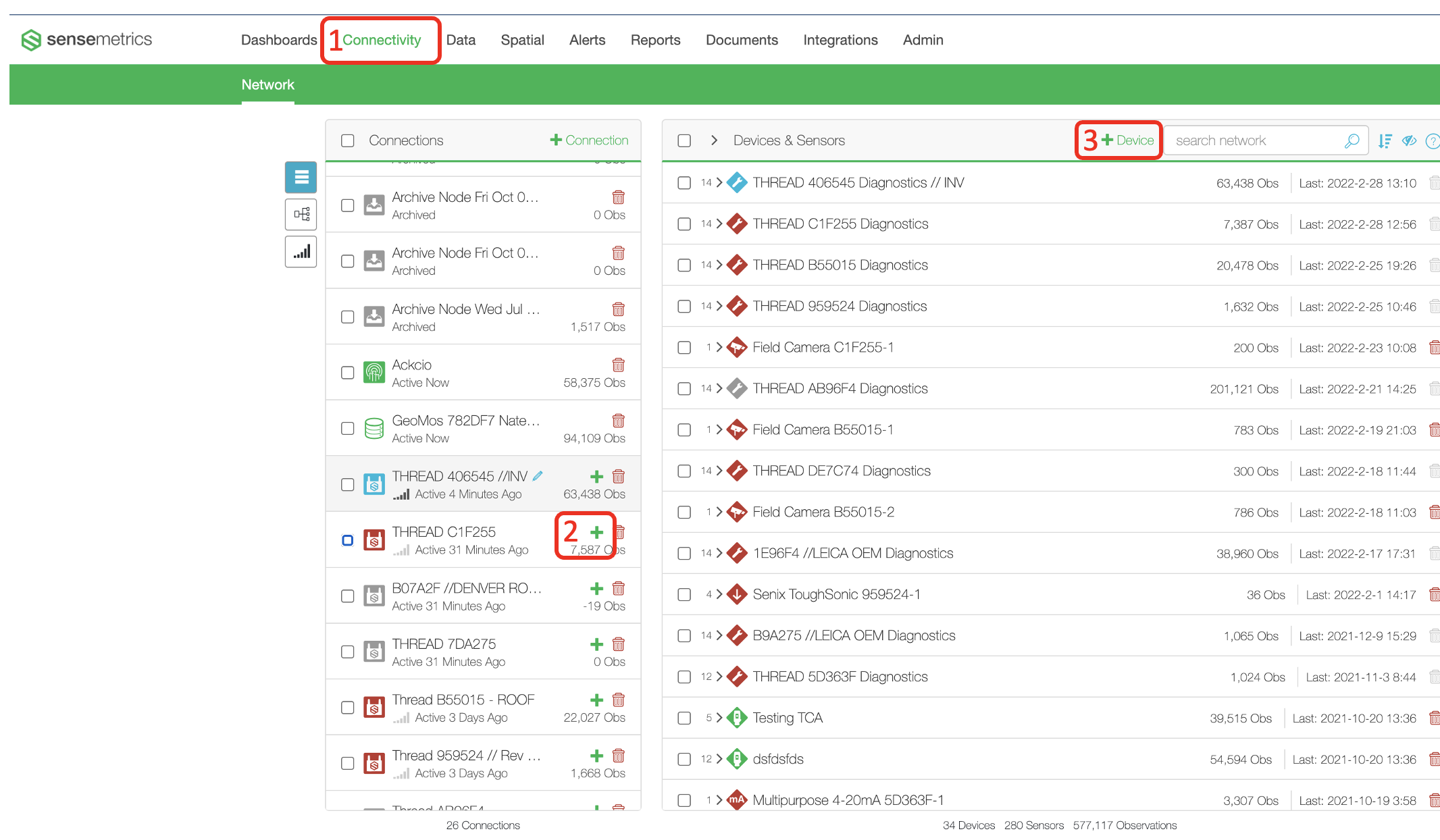

1.  Navigate to the Connectivity Module.
2.  Press the  button directly on a THREAD to add a Device to it. If your THREAD does not appear here, you may still need to Add Your THREAD as a Connection.
3.  You may also add a device from the  A green and blue textDescription automatically generated  button in the Devices & Sensors Section.

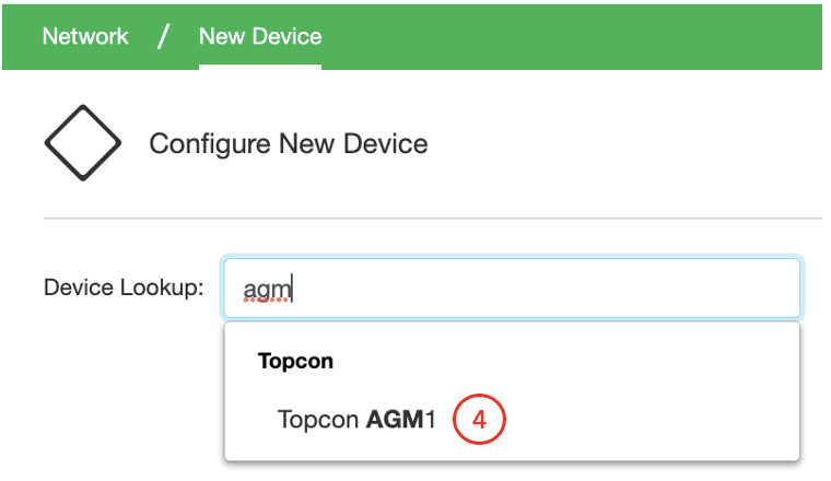

4.  Begin by typing in "Topcon" or "AGM", and select the name Topcon AGM1 once it autocompletes in the search box.

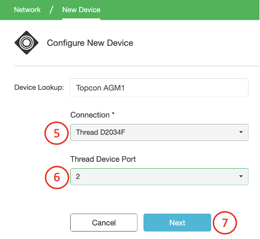

5.  Type in the Connect Code of the THREAD that the Device is connected to. It will already be pre-filled if the  button on the THREAD was used in step 2.
6.  Select the THREAD communication port that the device is plugged into, Device Port 1, 2, or 3.
7.  Click the Next button in order to save settings.

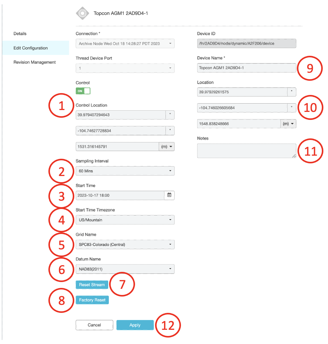

Once the Device connection process above is complete, the user will be navigated directly to the "Edit Configuration" page. The configuration of the GNSS receivers can be completed as they are added, or all receivers can be added to the project and then control receivers assigned. To determine which option is best for your setup, please read the Note section of the Control Toggle bullet below.
1. Control Toggle- This toggle sets the receiver network control point (base station or reference station) receiver for the project. The control receiver is used to refine the position of the remaining receivers on the project.
Once toggled on, if the Control Location latitude, longitude, and elevation are not already input, the data will be read from the AGM and auto-populated into the fields. The Control Location can be manually input at any point if desired, overwriting control location data from the sensor (Note: The control location auto-population will only occur once when Control is initially toggled on, and only if Control Location has not already been input).
Note: The Control receivers configuration inputs 2-6 will be applied to all other AGM receivers on the project once toggled on. To save time with configuration, all receivers can be added to the project first and then the Control receiver selected.
2. Sampling Interval- The sampling interval will dictate how often the GNSS receiver is read by the Thread. The sampling interval, start time, and start time timezone configurations work in conjunction to allow the user to control when GNSS data will be posted.
3. Start Time- The start time dictates the starting point when data will be collected. The sampling interval, start time, and start time timezone configurations work in conjunction to allow the user to control when GNSS data will be posted.

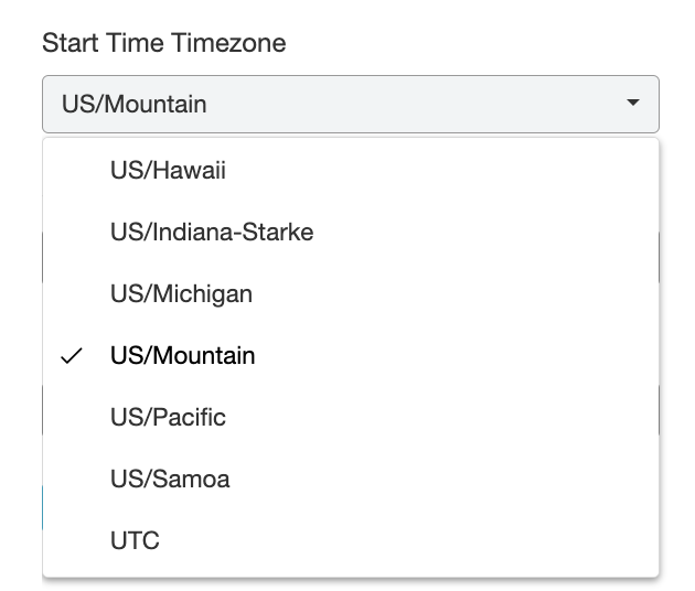

4. Start Time Timezone- The start time timezone dropdown adjusts the previously input start time to a different timezone.

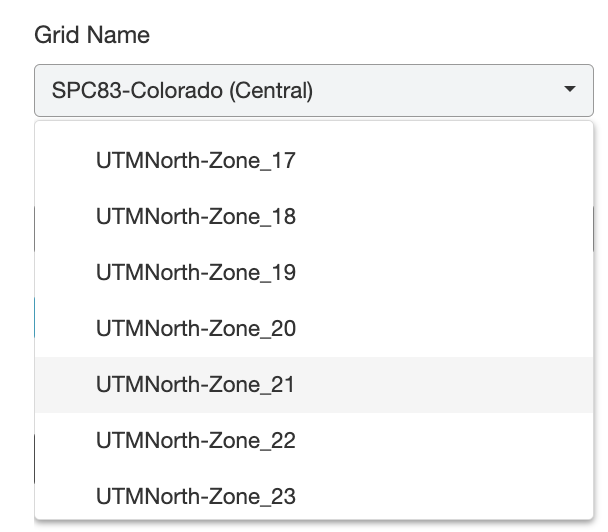

5. Grid Name- The Grid Name selection dropdown allows the user to select the cartesian coordinate system for the receiver data correction.
Note: UTM (Universal Transverse Mercator) is a global coordinate system that is commonly used. Many countries, and some U.S. states, also have their own localized coordinate system. Some commonly used U.S. coordinate systems include SPC 27 and SPC 83 (State Plane Coordinate) systems.
A screenshot of a grid numberDescription automatically generated

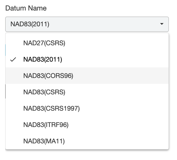

6. Datum Name- The Datum Name selection dropdown allows the user to define the geodetic datum projection that will be used within the Sensemetrics app for displayed location data.
Note: A commonly used global datum system is WGS 84, while NAD 27 and NAD 83 are both commonly used within the United States.
7. Reset Stream- The Reset button can be used to cancel the current stream of data being collected from the AGM receiver, and restart the data stream. This tool can be used if the receiver is stuck not providing data or if there may be issues with the data.
8. Factory Reset- Sends reset command to the receiver, clearing the NVRAM and rebooting the receiver. All receiver parameters will be set to their default values (original in-box settings). Almanacs, ephemerides, etc., will be erased. This operation will not delete any raw data files stored in the receiver’s memory..
9. Device Name- The user can change the Device's name which will become the Device name displayed across the application.
10. Location- Location data will be populated from Topcon data.
11 Notes- Notes can be added here.
12. Apply- Apply will save all changed configurations for the Device.

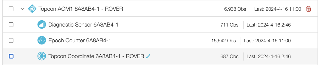

Data Stream- Once connected, the epoch sensor will begin collecting data first. The Diagnostic sensor and Topcon coordinate sensors will post data in accordance with the set device sampling interval.

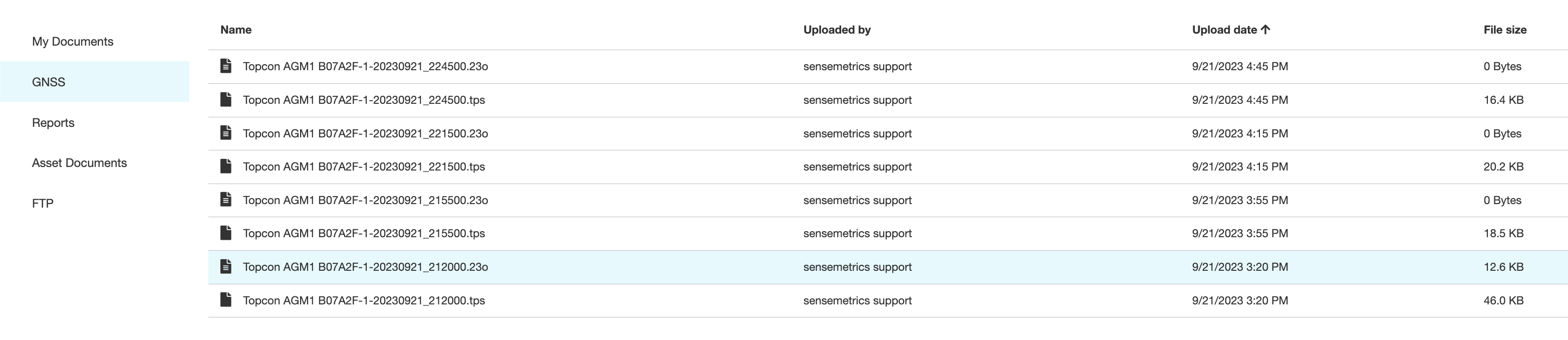

Data Files in Documents Module- After a receiver has been added, a new window will become activated in the Documents module. Within that window, a folder will be created for each receiver added to the project.  Once the coordinate sensor begins populating with data, files will begin being generated in the receiver folder, illustrated below. Two GNSS data files will be generated, one in manufacturer-specific binary format (TPS), and ASCII-based RINEX file which can be used for data retention or processing within a third party software.

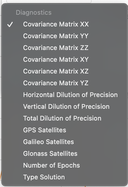

Diagnostic Sensor- This sensor houses information regarding the strength and precision of the receiver/satellite connection and the coordinate solution. The "Covariance Matrix" metrics are the measure of the strength of correlation between the selected variables, providing the user with insight about the accuracy of measurements. The "Dilution of Precision" metrics provide information regarding the error in positional fix of the AGM receiver caused by the geometry of the satellites being used. The "Satellites" metrics provide a count of satellites used in measurement, subdivided into individual metrics for each satellite constellation. The "Number of Epochs" metric counts the number of epoch times registered between satellite and receiver over the sampling interval.
A screenshot of a cell phoneDescription automatically generated

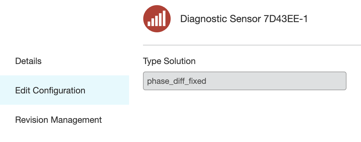

The "Type Solution" metric allows the user to see which equation was used to solve for X,Y,Z coordinates. The number displayed in the graph module corresponds to a solution, with a reference chart provided below.

This information can also be found on the "Edit Configuration" page of the Diagnostic Sensor.

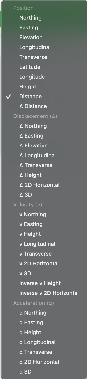

Topcon Coordinate Sensor- The Topcon Coordinate sensor provides the user with a number of position and movement-related metric options.
A screenshot of a phoneDescription automatically generated

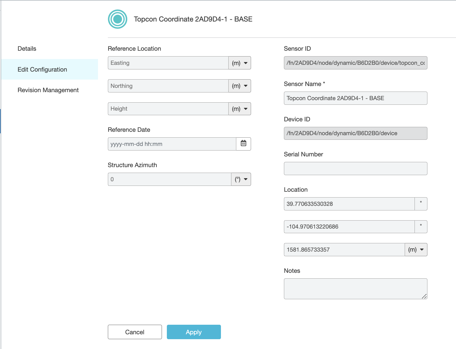

Some of these metrics can be altered within the "Edit Configuration" page of the Coordinate Sensor.
Reference Location- By setting a Reference Location, the user tells the platform what will be the base location (location zero) for delta calculations in terms of Easting, Northing, and Height.
Reference Date- A reference date will become available when a sensor uses delta calculations. The reference date will specify the first date used when calculating the amount of change within a certain time frame.
Structure Azimuth- The structure azimuth field will allow you to orient the Transverse/Longitudinal Axis in any desired direction. It is useful for finding movement in the direction of a specific structure or any point of reference.
