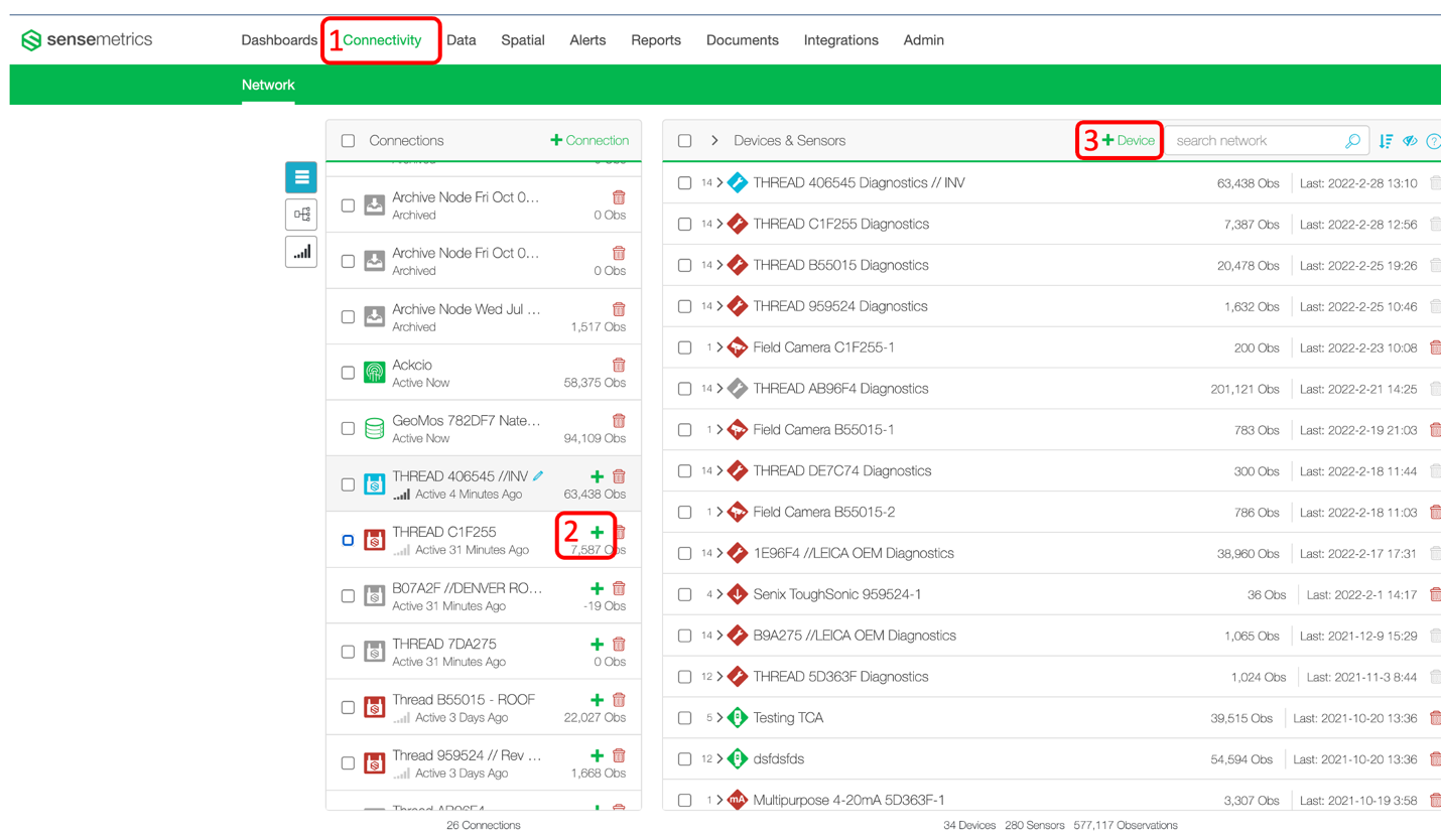

Adding a Sensemetrics Field Camera
Ensure that the THREAD is turned on and that the field camera is connected to the Thread via one of the Thread Device ports.
1.  Navigate to the Connectivity Module.
2.  Press the  button directly on a THREAD to add a Device to it. If your THREAD does not appear here, you may still need to Add Your THREAD as a Connection.
3.  You may also add a device from the  A green and blue textDescription automatically generated  button in the Devices & Sensors Section.
4.  Begin by typing in "Field Camera" and select the name once it autocompletes in the search box.
A screenshot of a deviceDescription automatically generated
5.  Type in the Connect Code of the THREAD that the Device will be connected on. It will already be pre-filled if the  button on the THREAD was used.
6.  Select the THREAD communication port that the device is plugged into, Device 1, 2, or 3.
7.  Click the Next button in order to save settings.
