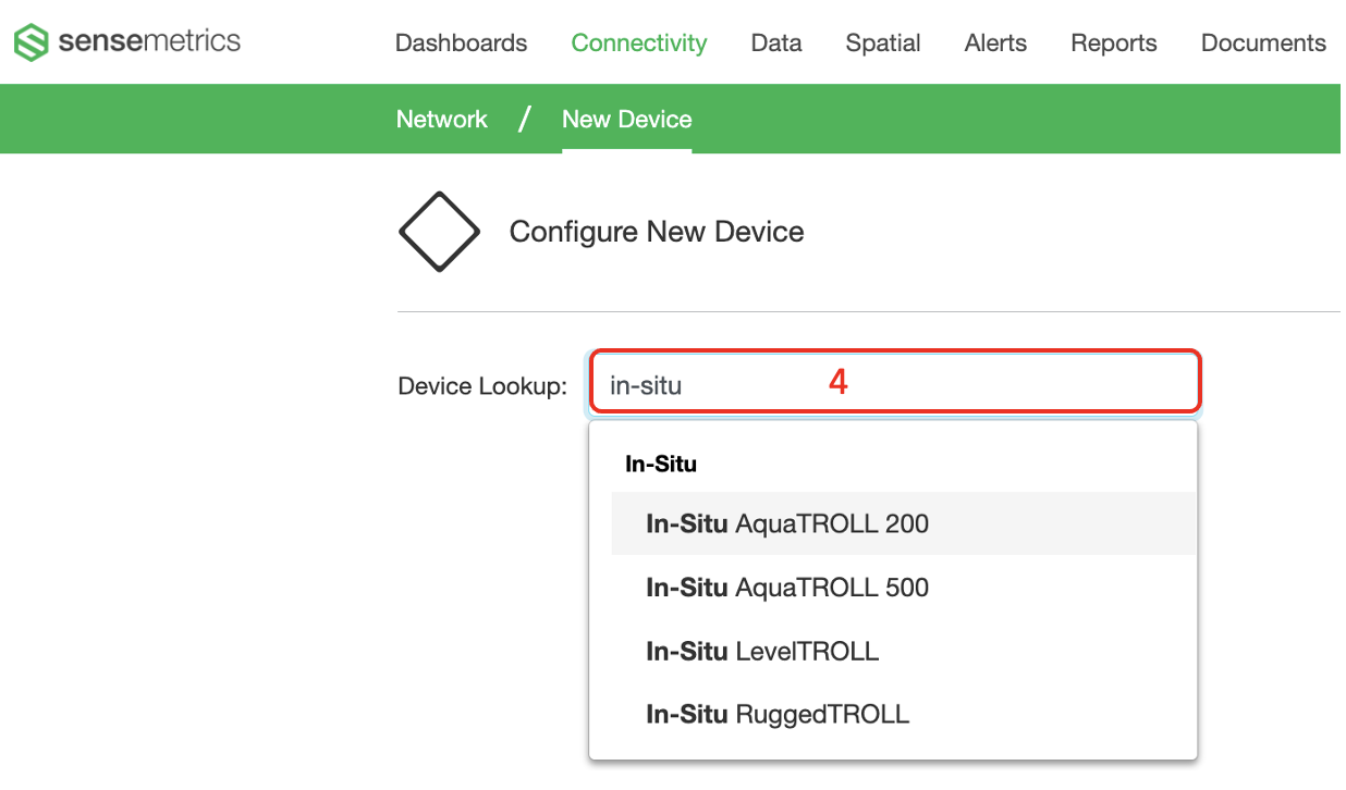

Adding the Device

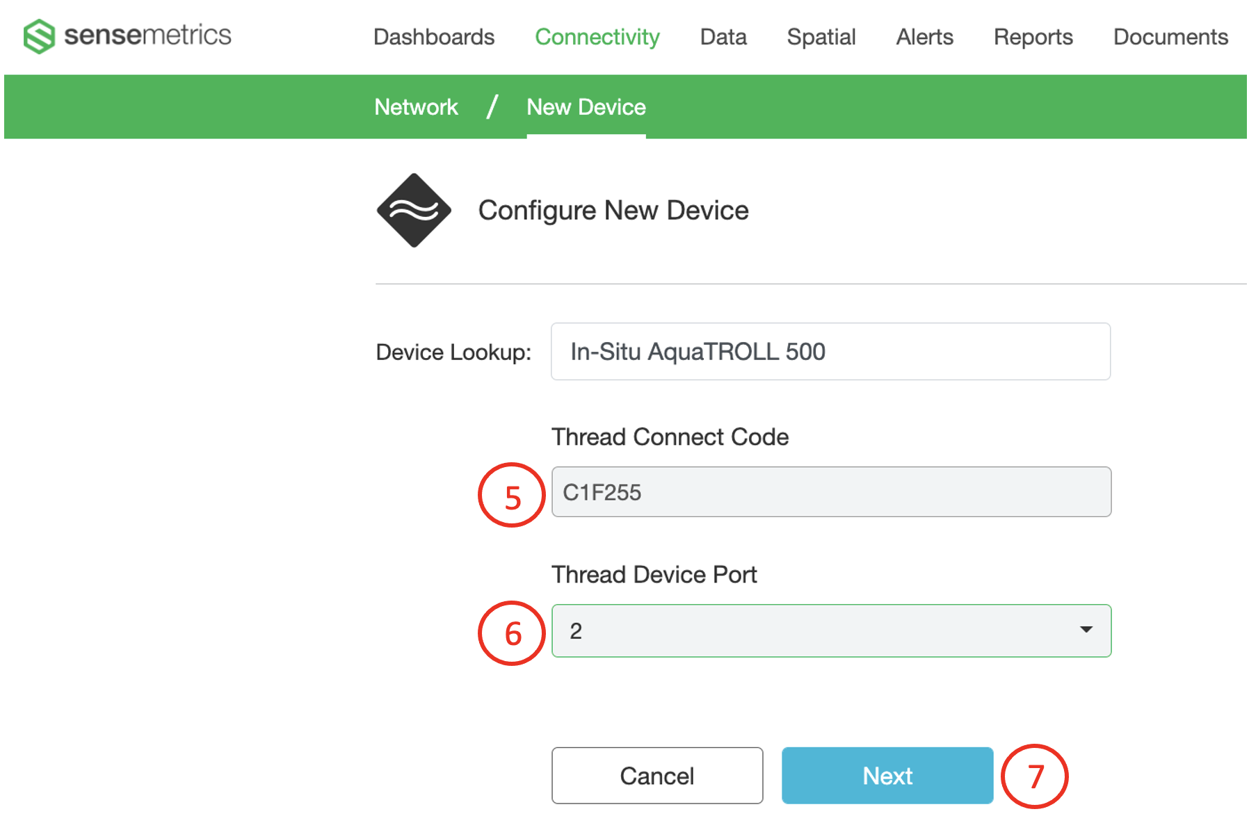

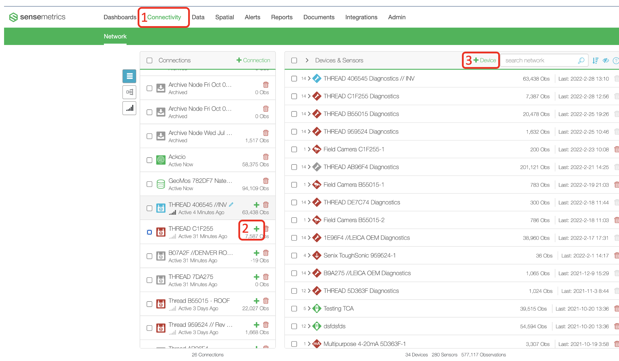

Ensure that the THREAD is turned on and that the AquaTROLL is connected to the Thread via one of the Thread Device ports.
1.  Navigate to the Connectivity Module.
2.  Press the  button directly on a THREAD to add a Device to it. If your THREAD does not appear here, you may still need to Add Your THREAD as a Connection.
3.  You may also add a device from the    button in the Devices & Sensors Section.
4.  Begin by typing in "In-Situ" and select the name once it autocompletes in the search box.
A screenshot of a deviceDescription automatically generated
5.  Type in the Connect Code of the THREAD that the Device will be connected to. It will already be pre-filled if the  button on the THREAD was used in step 2.
6.  Select the THREAD communication port that the device is plugged into, Device 1, 2, or 3.
7.  Click the Next button in order to save settings.

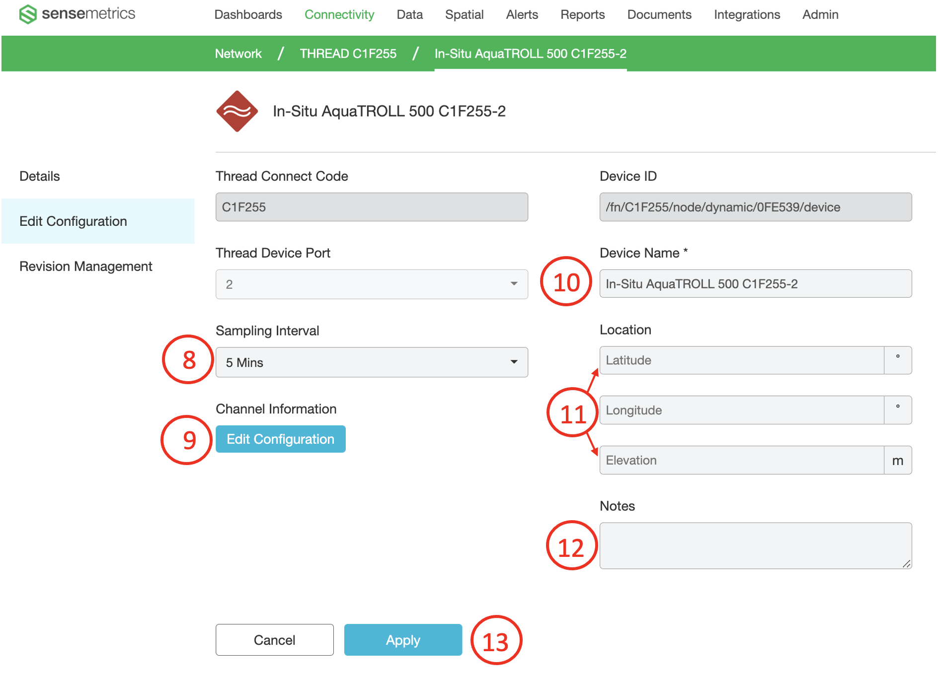

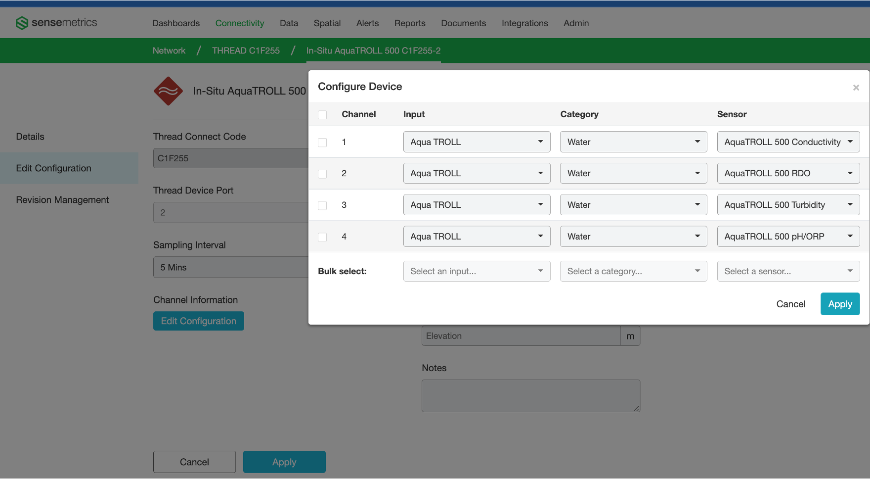

Edit Device Configuration
The next page you will be directed to allows the user to edit certain settings and sensor information.
8. The user can change the sampling interval for the sensor with options between 60 seconds-60 minutes.
9. Clicking "Edit Configuration" under Channel Information allows the user to configure the AquaTroll 500 channels. "Input" allows the user to turn off the channel or select "Aqua Troll". The current "Category" option is water. The image below shows the 4 configurable sensor options.
10. The user can change the sensor's name which will become the sensor name displayed across the application.
11. The user can input the sensor's location and elevation. This location information will allow the sensor to be displayed within the Spatial mapping feature.
12. Notes can be added here.

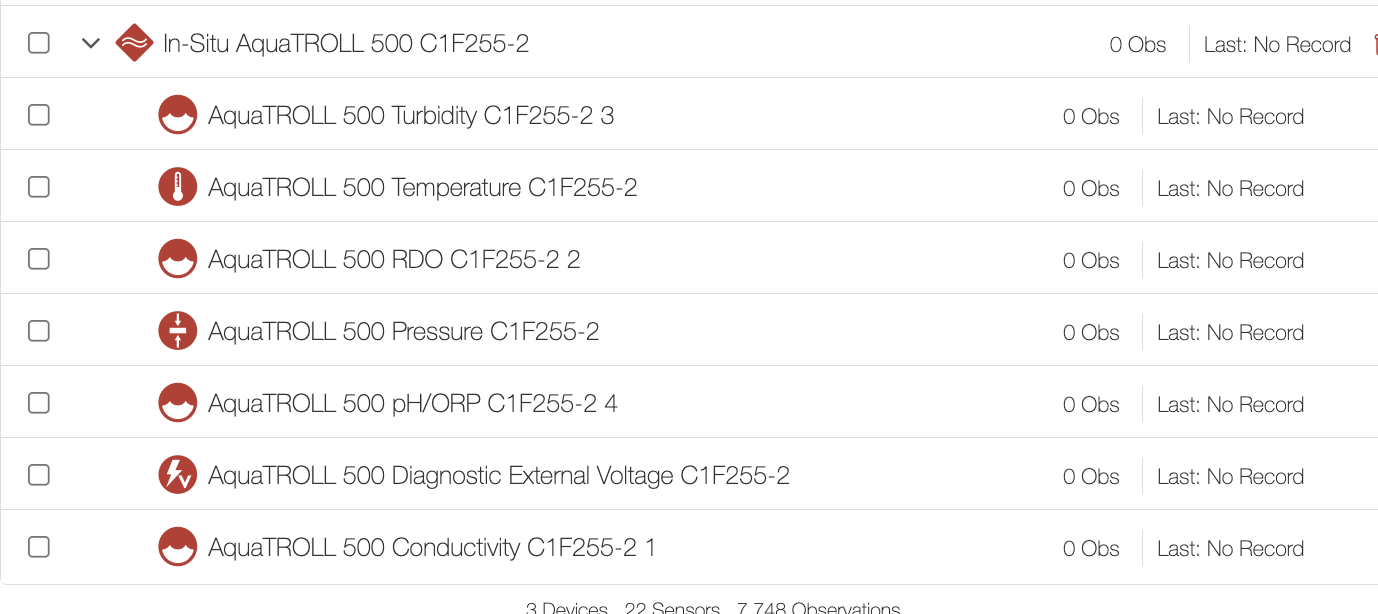

13. After changes have been made on this page, click the apply button to save the Sensor Configuration changes. You will then be directed back to the "Connectivity" page where a Pressure sensor will be populated below the Aqua Troll.

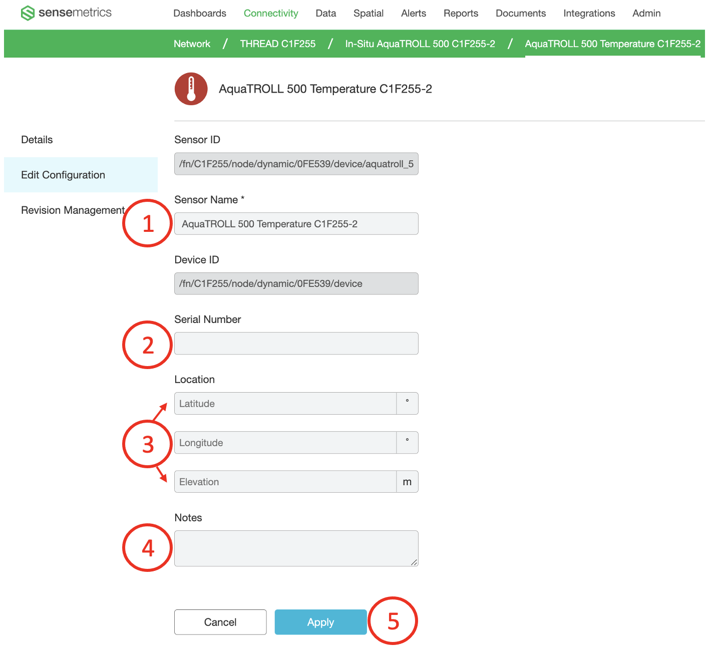

Standard Sensor Configuration
The standard configuration below can be used for the Temperature, RDO, pH/ORP, Voltage, and Conductivity Sensors.
1. SENSOR NAME- Users can modify the Device Name. This will change the name of the device that populates across the webpage.
2. SERIAL NUMBER- Users can enter the serial number of the device.
3. LOCATION- The Lat, Long and Elevation can be entered here.
Note: Whatever information that is entered here will determine where the sensors populate when using a Georeference Spatial profile.
4.  NOTES- Notes for the sensor can be added here.
9. APPLY- Click apply to save your changes.

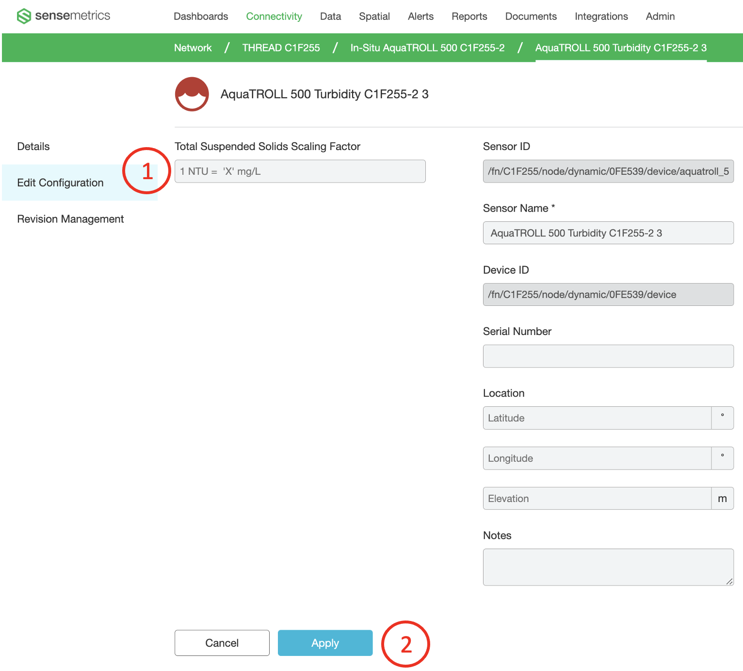

Turbidity Sensor
The turbidity sensor will also need to have the Total Suspended Solids Scaling Factor calibration input. Add the appropriate formula for your application if the standard equation is not applicable.

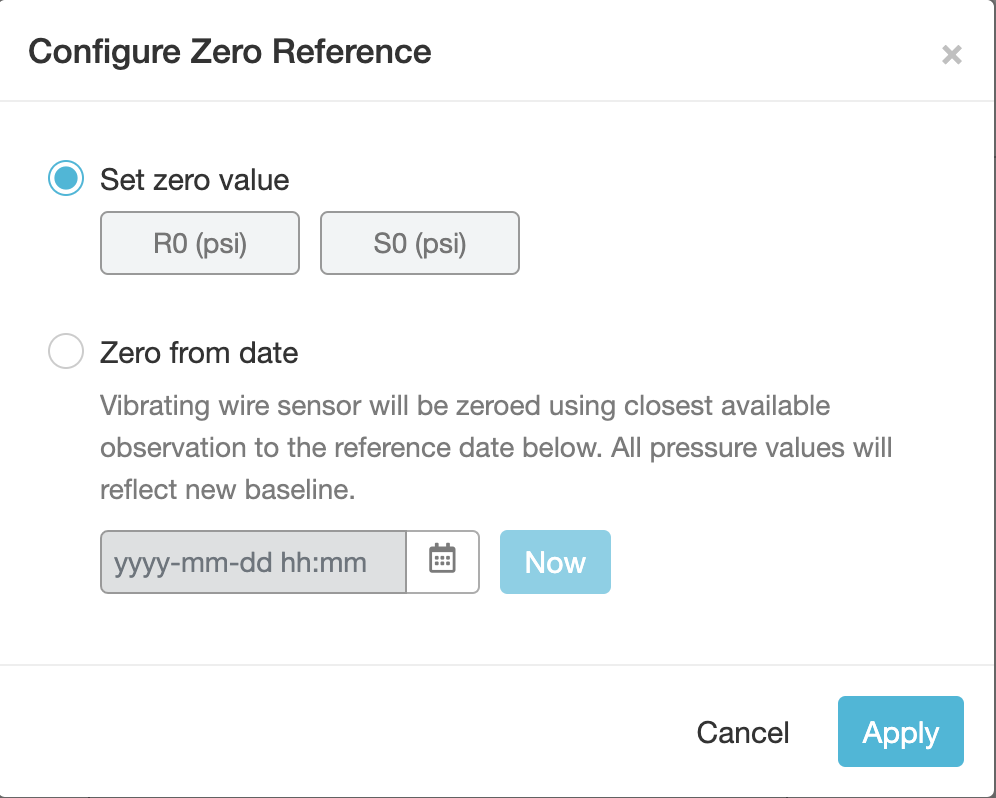

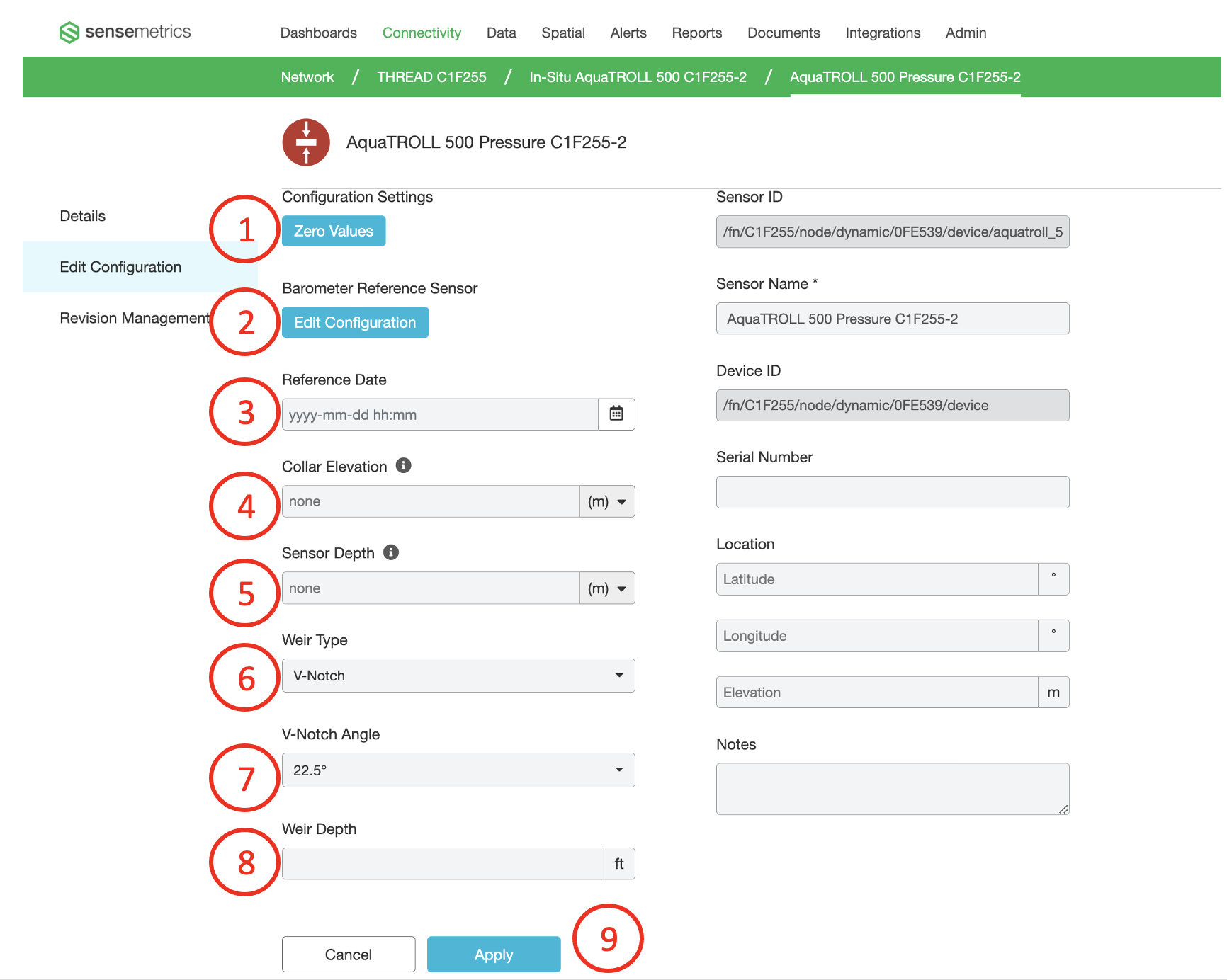

Pressure Sensor
Inputting information into the configuration page will allow the application to display calculated data for the pressure sensor. The information below will walk the user through the sensor configuration inputs.
1. Zero Values- Clicking on the    icon will open the "Configure Zero Reference" window, as illustrated below. The sensor can be configured using the R0 and S0 values found on the calibration record provided with the sensor. The "Zero from date" can also be used to configure the sensor using recorded data closest to the date input. Clicking    will save your changes and take you back to the main configuration page.

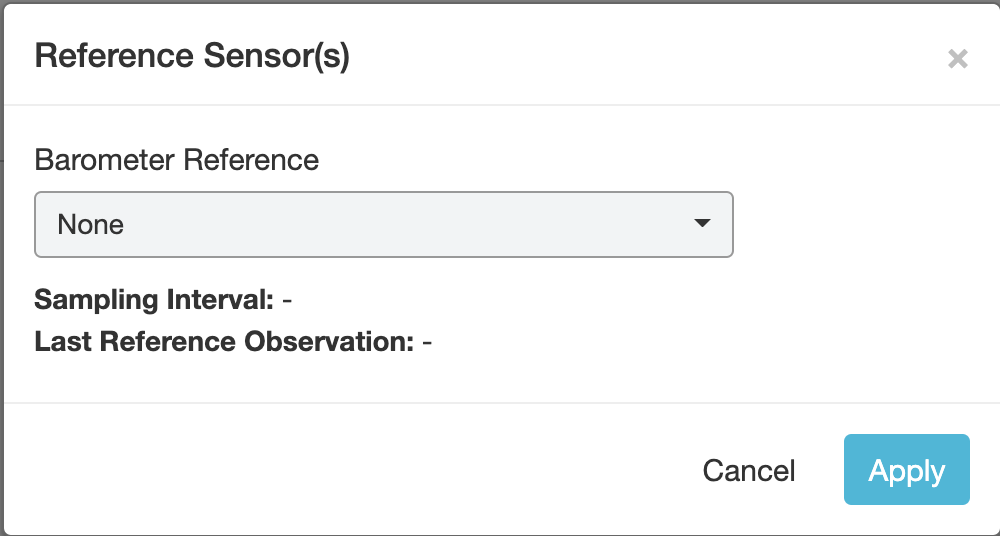

2. Barometric Reference Sensor- Click the    button below the "Barometric Reference Sensor" to open the sensor selection window. Click the "drop-down" to select the Diagnostic Pressure sensor to use for the calibration of the sensor being configured. Selecting  will save your changes and take you back to the main configuration page.
Note: Be sure that the sampling interval of the pressure sensor being used matches that of the AquaTroll or the graphing of engineering values will be affected.
3. Reference Date- The reference date will specify the first date used when calculating delta metrics indicated with the ∆. Specify the Reference date to use ∆ Delta calculations.
4. Collar Elevation- The ground elevation at the well collar.
5. Sensor Depth- The depth of the sensor relative to the collar elevation.
6. Weir Type- A dropdown that allows the user to select from the configured weir geometries.
7 and 8. Additional Configurations- Based on the weir type selected, additional configuration inputs are required to correctly calibrate the sensor to ensure accurate data readings. Inputs vary by weir type.
9. Click  to save these configuration changes.
