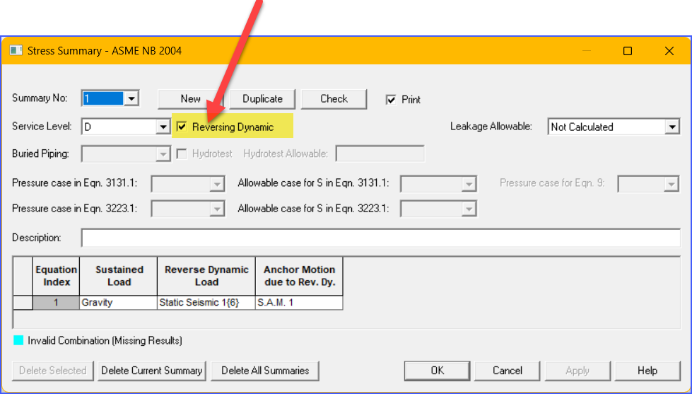

Q. Does AutoPIPE's Stress Summary> Reversing Dynamic option consider both +ve and -ve dynamic loads?

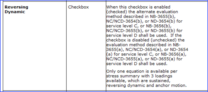

Please see AutoPIPE help for detail on this topic.
From AutoPIPE help:
We consider both directions of reversing dynamic loads by taking the worst-case combination in each moment direction.
