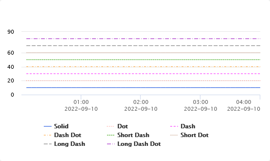

Style
Specify the line drawing style
A line graph with numbers and linesDescription automatically generated with medium confidence

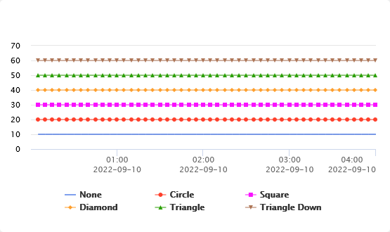

Marker
Data point marker style
A graph of different colored linesDescription automatically generated

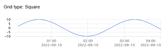

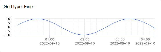

Grid type
Graph grid display type
A graph with numbers and linesDescription automatically generatedA graph with numbers and linesDescription automatically generatedA graph with a lineDescription automatically generated

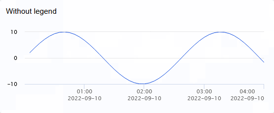

Show graph legend
Show variable legend under the graph

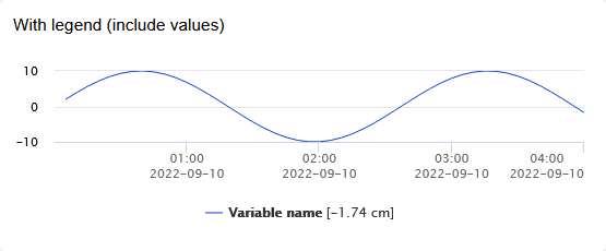

Include values
Include latest variable value in the legend
