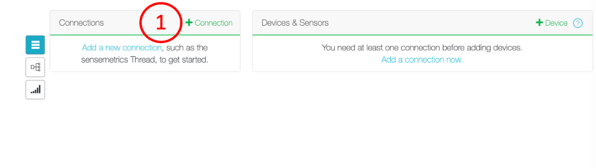

1. Go to the Connectivity Page and click the "+ Connection" button.

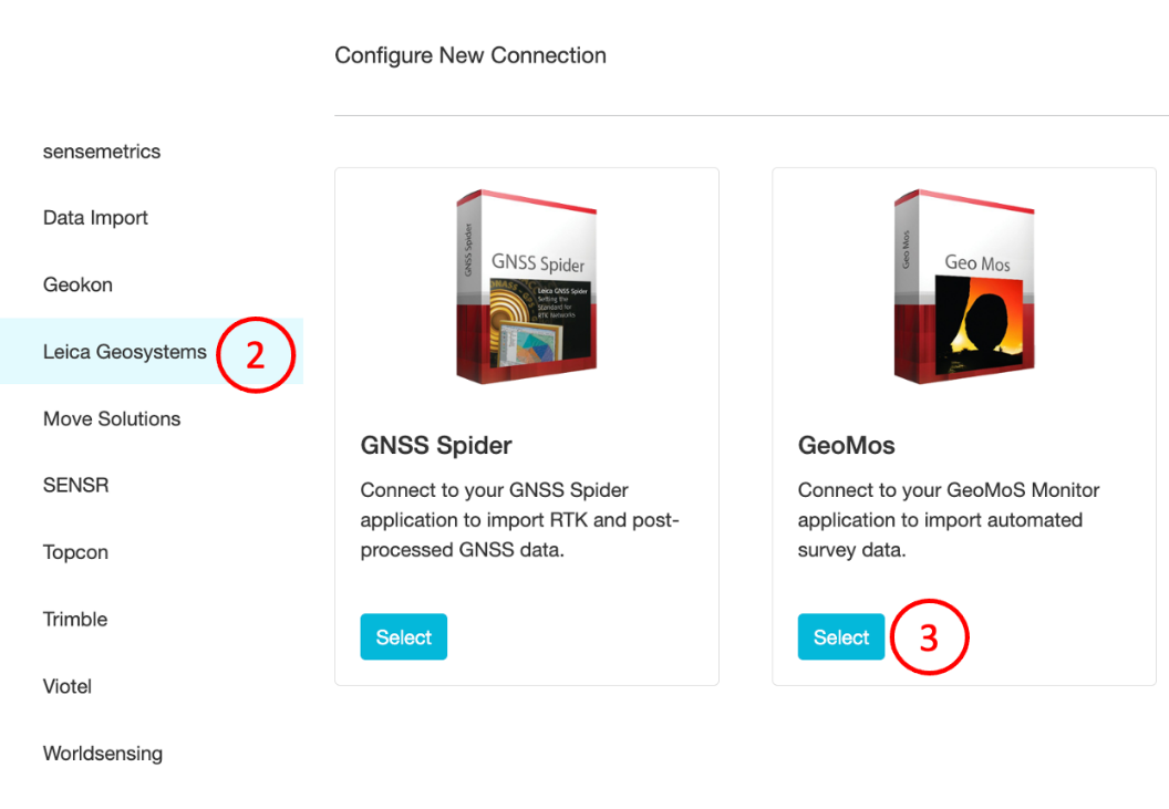

2. Select "Leica Geosystems" on the selection bar on the left side of the page.
3. Click on the "Select" icon on the right side of the page under the "Geomos" card.

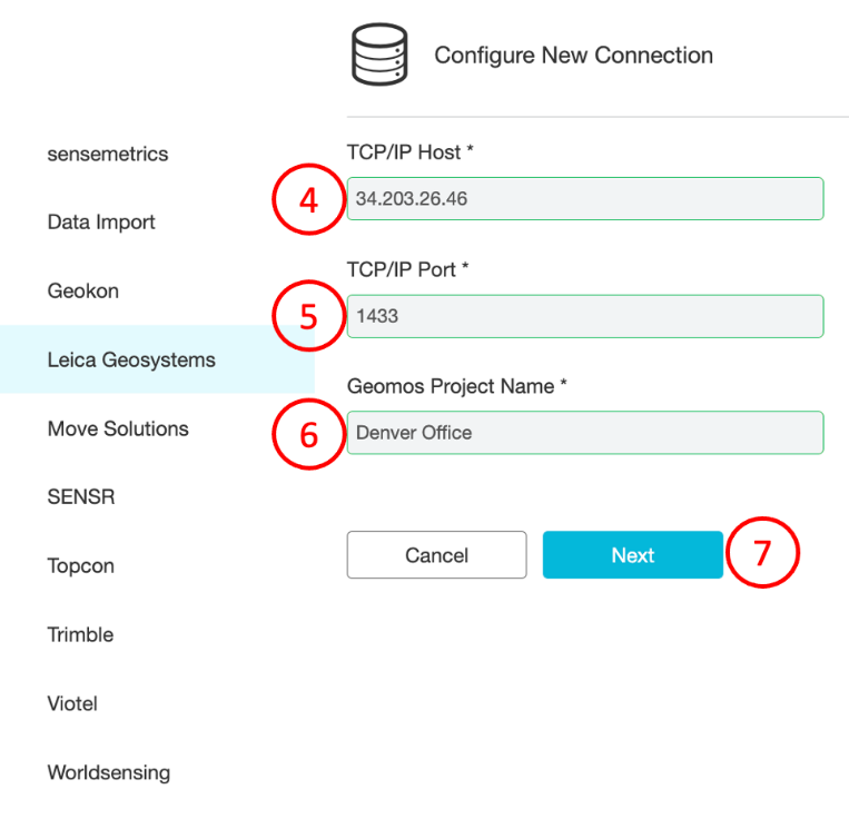

4. Enter the TCP/IP Host of the GeoMoS Server, this will be the external IP address of the Windows machine that's running GeoMoS.
5. Enter the TCP/IP Port of the GeoMoS Server, the default port is 1433 unless custom-configured differently.
6. Enter the name, as configured in Geomos, of the Geomos project that you want to bring into the Asset as a conneciton.
7. Click the "Next" icon, and the GeoMoS Server connection will be added to the asset.
