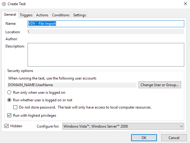

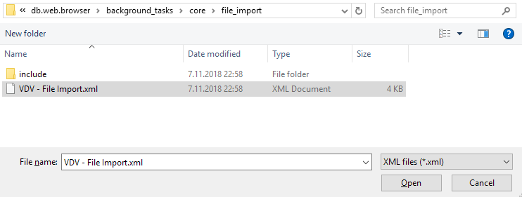

- Open Task Scheduler from the Windows Menu and select Action->Import Task
- Navigate and open each .xml file specified above.
- To select the user to run the task, click the "Change User or Group..." button. Search for or enter the name of the appropriate user account, select it, and press OK.
- Click OK to finish the setup of the task(type in Username and Password if required)
