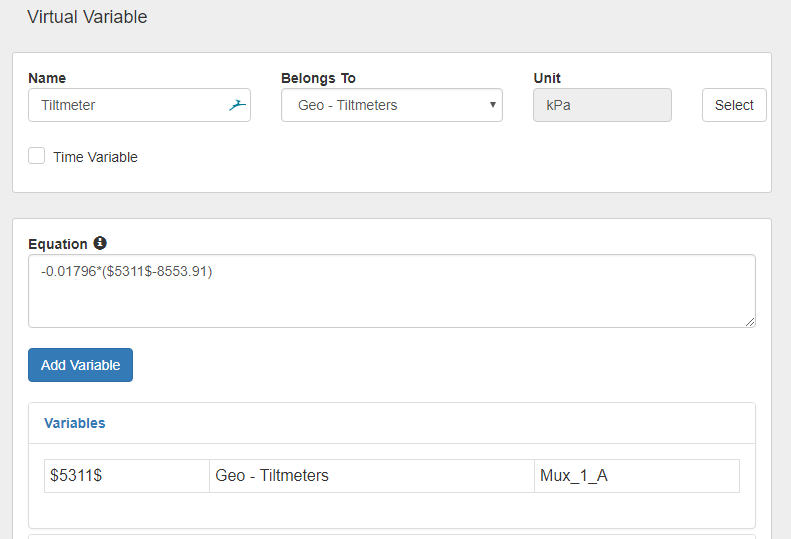

Go to Setup → Virtual Variable.
Click + button in the top right corner to create a new VV.
Here is a basic sensor calibration Equation. Notice the $1612$ which is the Variable ID. All variables in the equation will be listed in the Variable table.

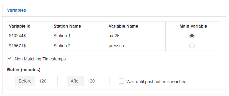

Match Timestamps
When the Virtual Variable Equation includes variables from more than one Site and they have different logging periods the Non-Matching Timestamps option can be selected.
When the option is selected the following controls become available:
Match Timestamp Calculation Example
The following variables are being used in an equation
Sensor Sensor Update Rate Sensor update time (HH:MM)
A Hourly HH:56
B Hourly HH:31
C 15 Minutes HH:00, HH:15, HH:30, HH:45
Scenario 1.
Equation Main Variable Pre Buffer Post Buffer
A + C Sensor C 30 min 30 min
The VV calculates the formula at 15 minute intervals where the C uses its own data and looks for data in A 30 minutes before and 30 minutes after.
Scenario 2.
A + B + C Sensor A 30 min 5 min
The VV calculates the formula hourly with the timestamp as HH:56.
A uses its own data and looks for data in C and B 30 minutes before and 5 minutes after. This means that at HH:56 if it does not find data for both B and C in the range 30 minutes before and 5 minutes after it will not return anything. However as B has updates at HH:31 and C at HH:00 this scenario will return value.
Note that it would have found data for C at HH:00, HH:30 and HH:45. It would use the HH:00 measurement as that is the closest one.
Scenario 3.
A + B + C Sensor C 25 min 20 min
The VV calculates the formula at 15 minute intervals.
At HH:00 the buffer doesn't reach Sensor B so no reading will be returned there.
At HH:15 the buffer finds values from both A and B and returns normal values
At HH:30 the buffer doesn't reach Sensor A so no reading will be returned there.
At HH:45 the buffer finds values from both A and B and returns normal values
If the time is 9:50, the data for Sensor A hasn't been read yet so Scenario 3 will only return the reading for 9:45 after Sensor A has received it's data at 9:56
Wait until post buffer is reached
If this option is selected, the calculations will wait until the timestamp of the post buffer is reached to return a value.

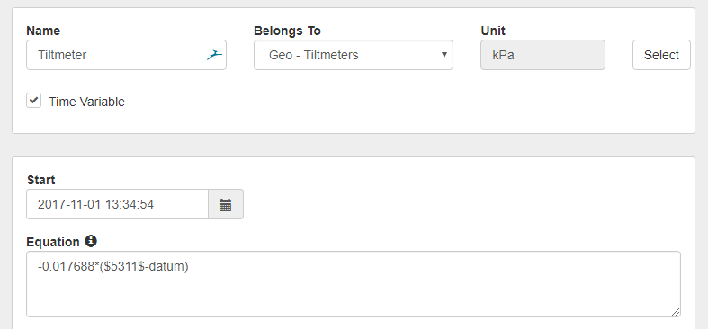

Time Variable
It is possible to have a different formula for different time period. This is useful if the sensor has been replaced or re-calibrated and a new formula is needed.
Check the Time Variable checkbox to activate the Time variable. A date picker appears above the equation to select the data when this formula starts.
To add a new time period click the + button below the first equation calculation example.

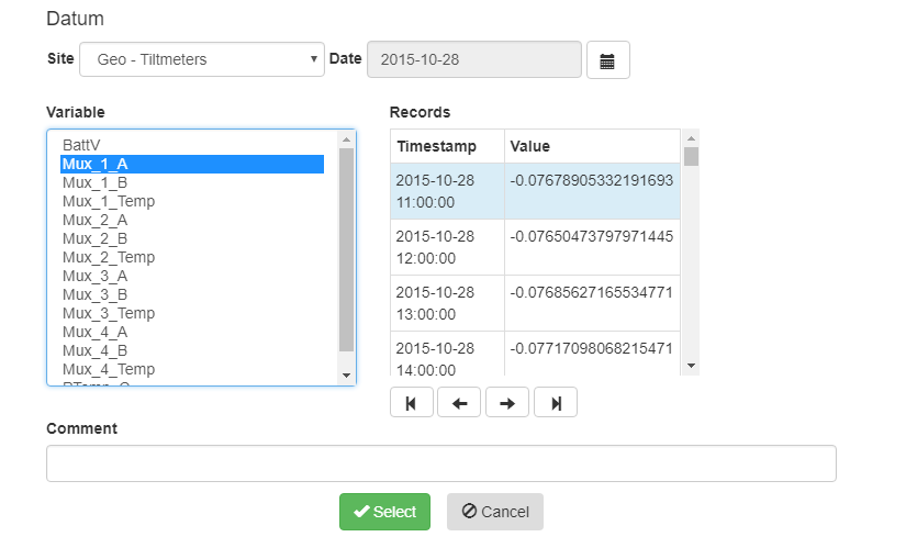

VV Datum
Often there is a need to use a baseline reading in the equation. The Datum feature is useful for this purpose.
Expand the Datum Section and click Select.
Select Site, Variable and Timestamp for the Datum Reading. VDV will automatically select the oldest reading in the database. Click Select to select the Datum value.
Now we can change the baseline reading (8553.91) and simply type in datum. When the Datum reading is changed the formula is updated at once.

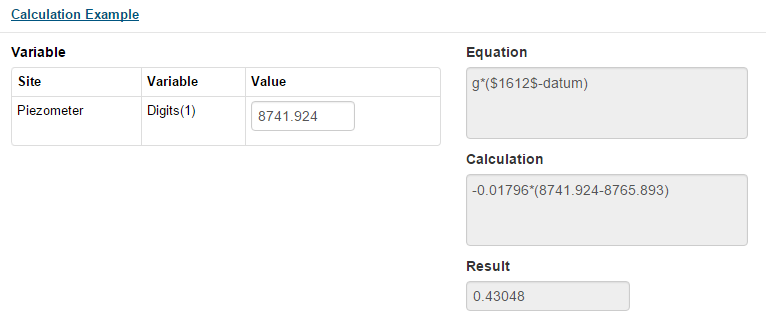

Calculation Example
If your Virtual Variable contains another Virtual Variable then the calculation example will not work.
When a VV has been created it is a good practice to make sure it is working properly.
Expand the Calculation Example section.
Change the Value for each Variable in the equation and see how the result changes.
