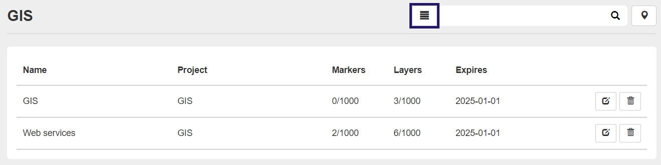

To add new base maps select the list icon in the top right corner

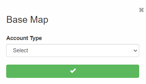

Select the Account Type and click the checkmark to add a new base layer

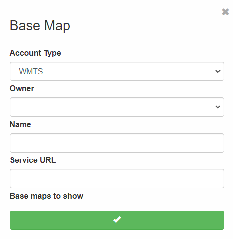

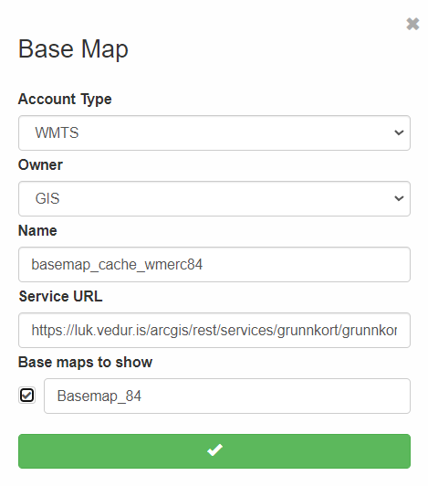

To set up any of these the Service URL is added and following the Base maps to show will list out available Base maps.
A screenshot of a phoneDescription automatically generated
The User will then select which Base Maps he wishes to import from the Service by selecting the checkmark in front of the desired base maps to finish the setup.

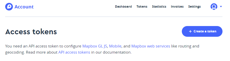

Sign in to the account and select Tokens from the user menu.A screenshot of a computerDescription automatically generated
Create a new token for your VDV Server. It is recommended to limit the token only to your VDV web URL.

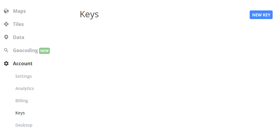

Sign in to the account, select Account, and then Keys from the user menu.
A white background with black textDescription automatically generated
