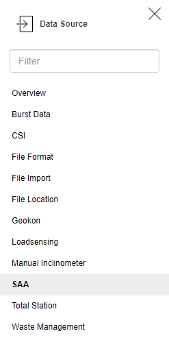

Navigate to Data Source: SAA by selecting Data Source → SAA on the left-hand side menu in VDV.

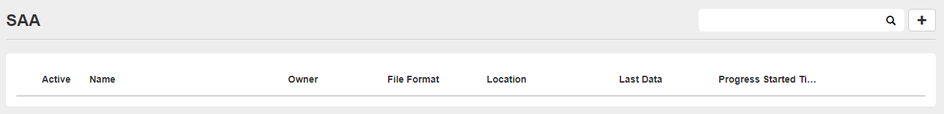

The SAA menu will appear listing all SAA Sites already in VDV.

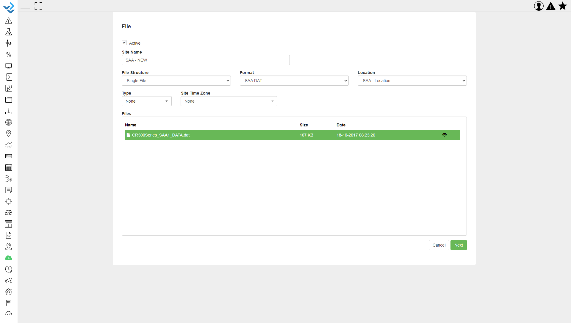

Click the + icon to create a new import.
A screenshot of a computer Description automatically generated

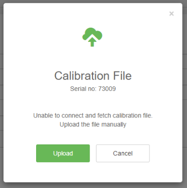

If for some reason, VDV is not connected to the internet, or if the Measurand FTP server is not responding, the calibration file needs to be uploaded manually.

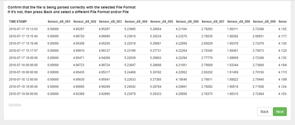

An overview of the converted data will be displayed to review.
Keep in mind that the final calibration has not been added to the data, and this data presentation is of the raw data, meaning there could be some errors that will be corrected in the following steps.

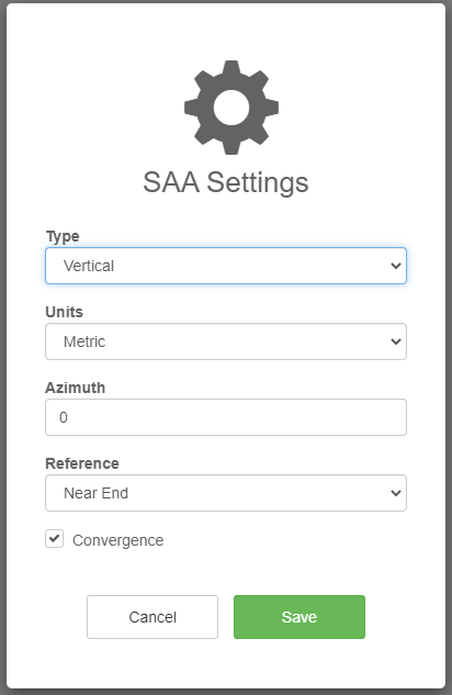

To complete the data import, save the SAA settings.
No data will be imported into VDV until the SAA settings have been saved.
