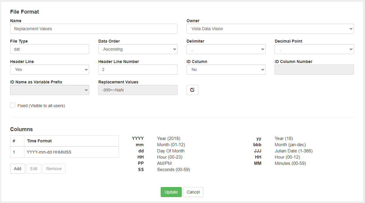

File Format
For each data file imported into VDV, there needs to be a File Format that matches the data file format. VDV can import almost any delimited text-based data file using the File Format editor.
To Access: Data Source → File Format
Before creating a new File Format, it is good practice to open the data file to be added in a Text Editor (Notepad++, for example) to better understand how the data file is structured.
Click the button in the top-right corner to create a new File Format.
Sensor-Based Data Files
Create a new File Format for Sensor-Based files by setting the ID Column to Yes and setting the ID Column Number to match the data file.

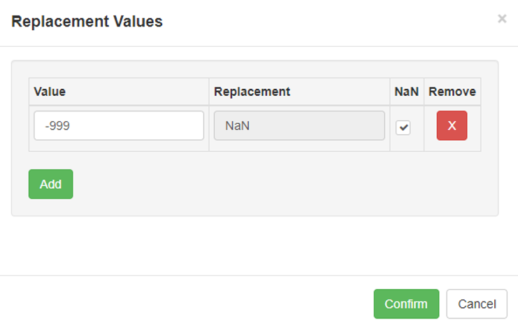

Replacement Values

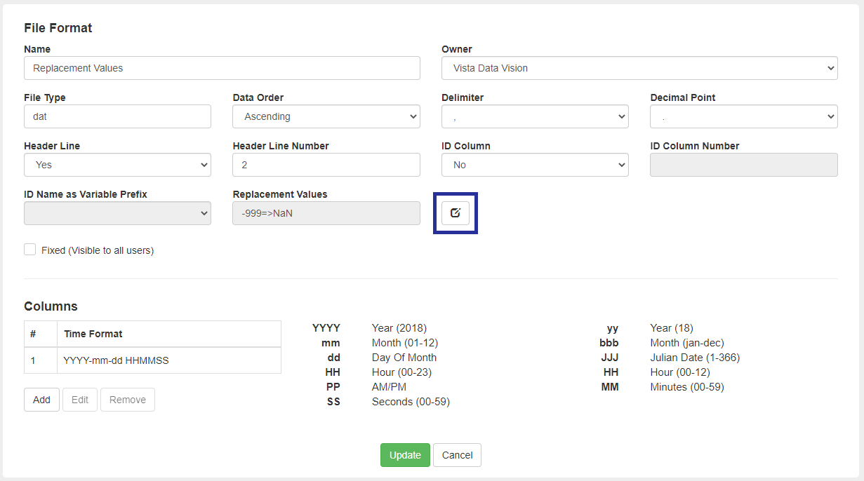

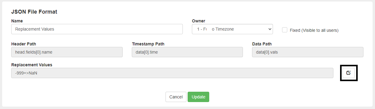

Users can assign replacement values on the data imported through the Data Source. To assign replacement values, the user needs to click on the edit button next to the Replacement Values window, as seen below for both Regular and JSON format.
A screenshot of a computerDescription automatically generatedA screenshot of a computerDescription automatically generated
The Replacement value window will open up, allowing the user to add, remove or view the replacement values already assigned.
Add, edit or remove the Replacement Values and Confirm the change.

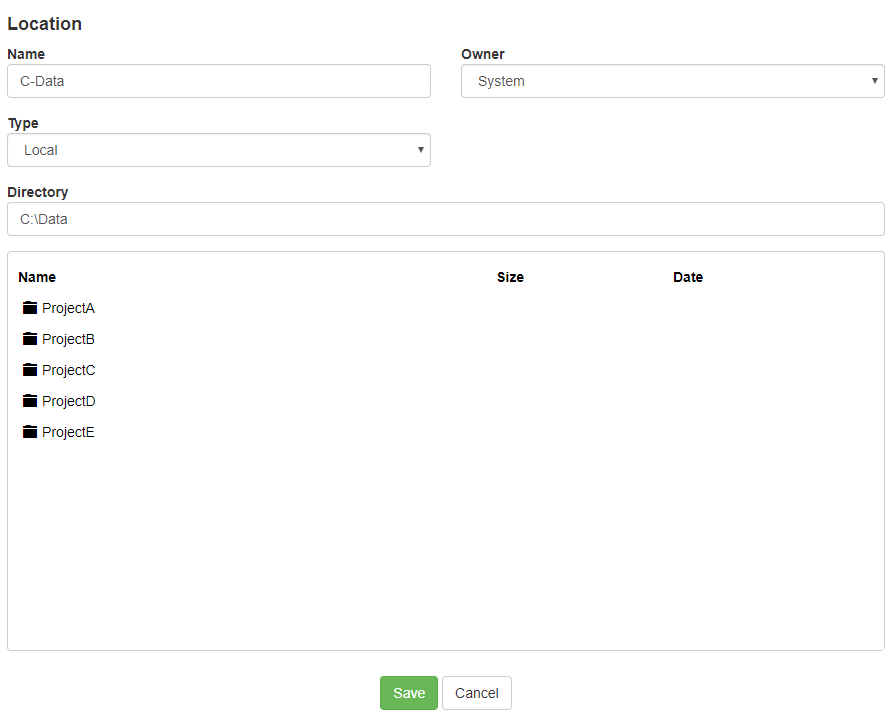

Local Directory
Adding a local directory allows users to add new Data Sources from the web to the server running VDV. This can be used to add a directory where data is being collected.
If data is stored on an FTP on the same network as VDV Server, adding a Local Directory with \\FTPServerName as the path is recommended instead of setting up an FTP location to improve speed.

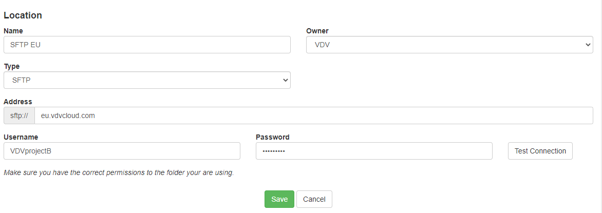

FTP Location
FTP Location allows users to import directly from FTP Servers. This provides data import from any external FTP/SFTP Server.
Please note that the File Structure for FTP servers has to be in UNIX format (not MS-DOS ) see: How to configure FTP directory browsing

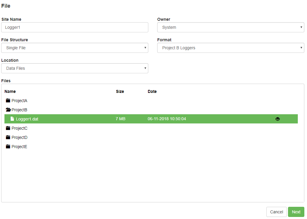

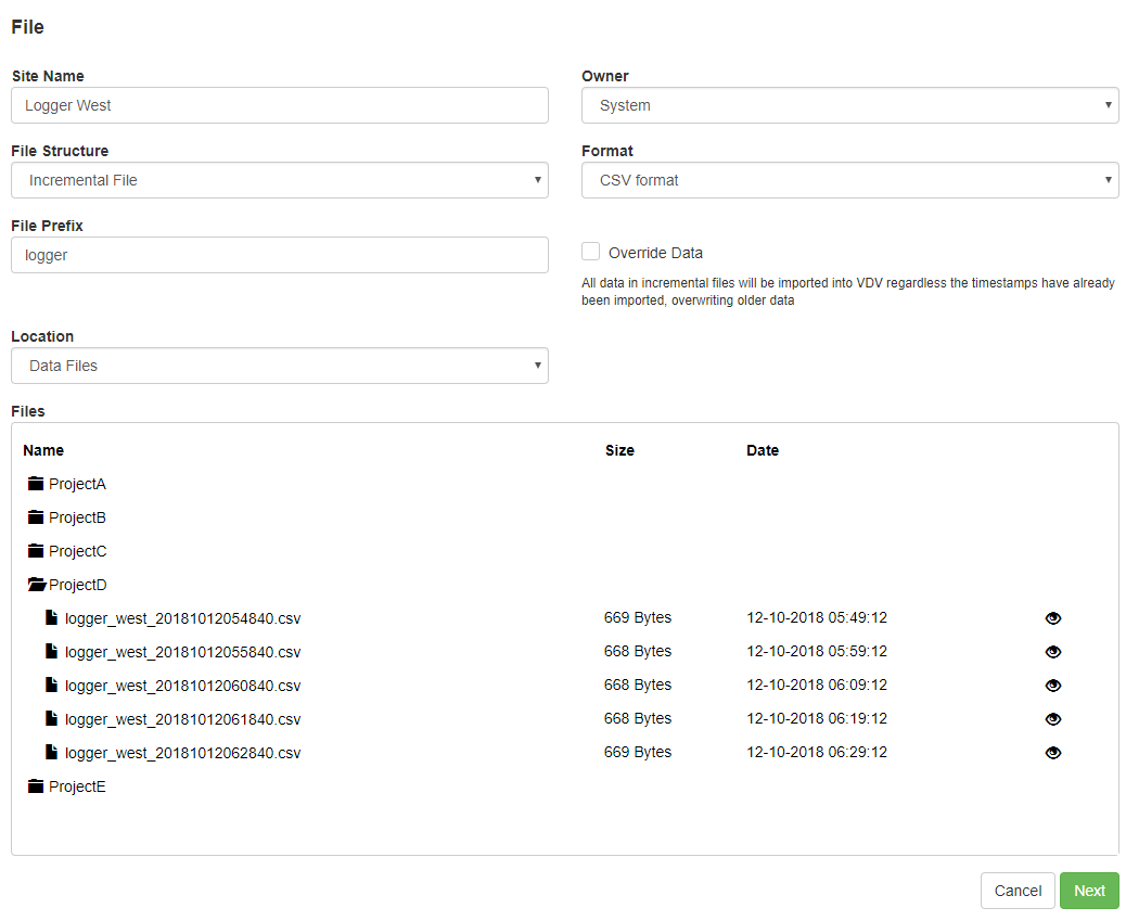

To Access: Data Source → File Import.
File Format and File Location must be configured before adding a new File.
Click the button in the top-right corner to create a new File to VDV.
Data files can either be Incremental or Single, where all data is appended to the same file.
Single File
Incremental Files
Override Data. If selected, VDV will import all data regardless of whether it has been imported before. This is handy if corrected data is sent afterward or when importing forecast data that is constantly updated.

Adding Sensor-Based File via File Import is identical to any other file. Begin by filling out the default information as with any import in VDV. If the user selects a Sensor-Based Format, the File Structure will automatically become Incremental since all Sensor-Based Files are required to be incremental.

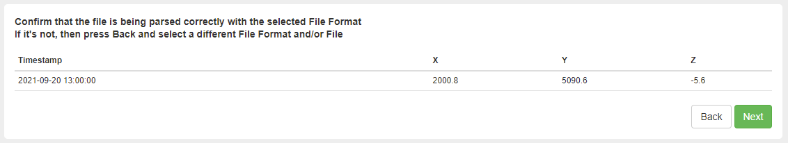

Select the File for import and click Next
Confirm that the File has been parsed correctly

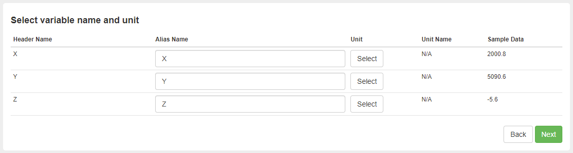

The Select variable name and unit window will be next. The only difference here is that changing a variable name will change the variable name in all the sites created from a single file.
If the File Format has the ID Name As Prefix option enabled, changing the variable name will not affect it.

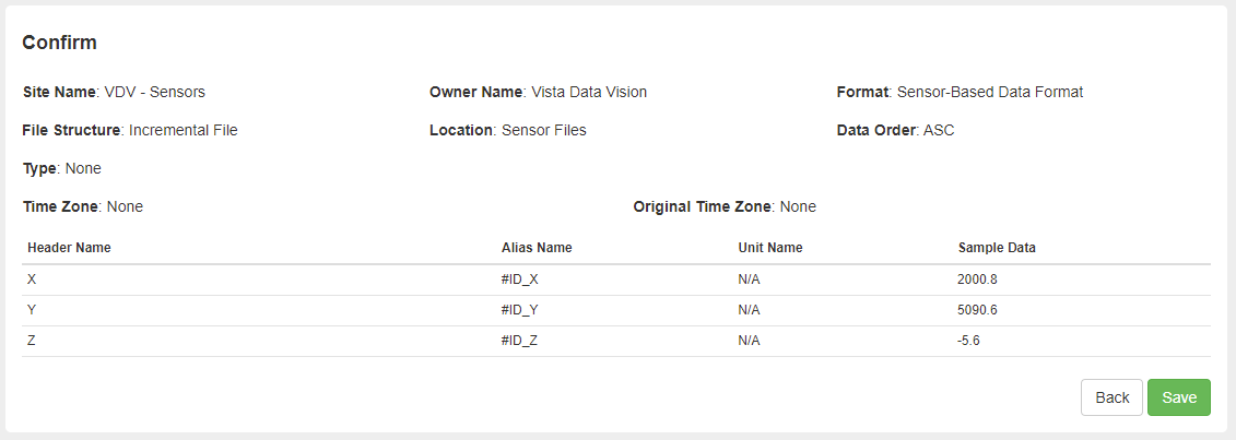

The final step displays an overview of the import you are about to create. If the File Format has the ID Name As Prefix option enabled, the Alias Name will list the #ID#_name. Otherwise, it will only be the variable name selected in the previous step.
The VDV System will begin importing data, and if a new sensor appears in the data file, VDV will automatically create a new site and import the data.

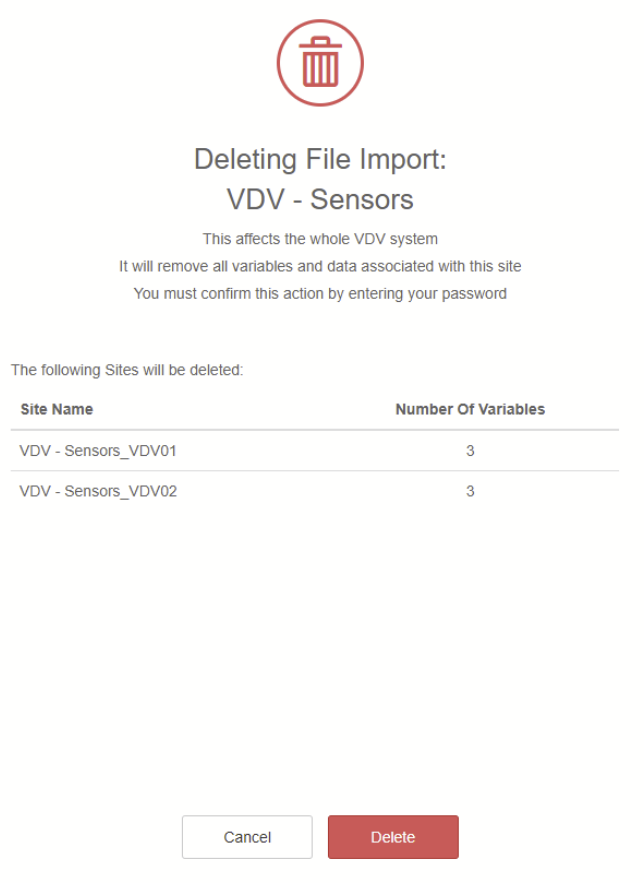

Deleting Sensor Based Data File
When deleting Sensor Data File, a popup will open with information about the File Import and all the sites it will remove from The VDV System
The regular Alarm feature has not been implemented yet for Sensor-based data, so the user needs to set up Custom Alarm or Bulk Alarm.

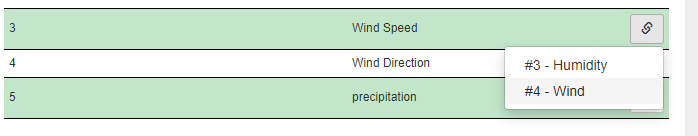

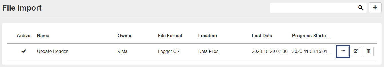

Update Header
If the file linked to a Data Source has its headers changed, an admin must update the headers of the file.
The changes can be any of the following:
To navigate to the Update Header, go to Data Source → File Import and select the ... to open the Update header menu.

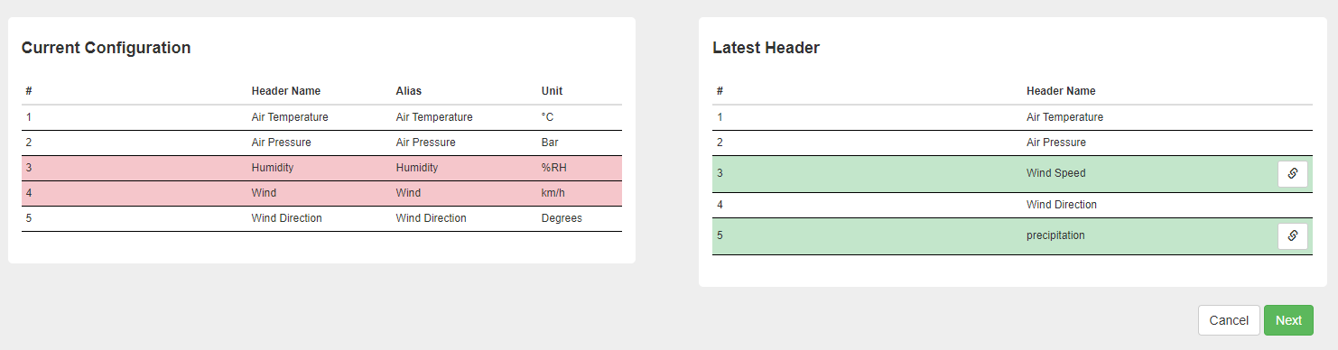

A Side by side comparison of the Current Configuration and the Latest Header will appear in the Update header menu.
A screenshot of a computer screenDescription automatically generated
Here the Humidity column was removed, "Wind" was changed to "Wind Speed", and a new column, "precipitation", was added.
To link the Wind Speed to the old Wind column, click the link symbol and select the "#4 - Wind" column.

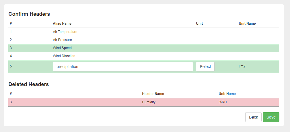

After linking all renamed columns, press Next.
Select a unit for all new headers and confirm that added and removed headers are correct.
Click Save, and the updates to the headers will be made.
