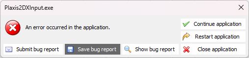

When you try to run/open any Python tool, such as the Interpreter (under Expert > Python menu), the Calculation Manager (under Expert menu), the PLAXIS 2D to 3D Converter (under Expert menu) or the Import GeoStudio 2D (under File menu), you may encounter an error, and the following pop-up window appears.
Via the pop-up window, you can select "save bug report" (as text file) or "show bug report", which will give you some insight into the exact error you experience.
To identify the error code, when viewing the bug report look for the "exception message". This is mentioned in the 24th line of the bug report file.
Typically, this error message (among others) refers to the following:
Python tool failed to run! "NO PYTHON FOUND"
In this situation, you can confirm that the PLAXIS Python distribution has not been installed and/or configured properly on your PC.
