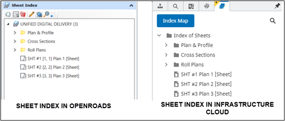

To include an index of sheets in an Infrastructure Cloud project:

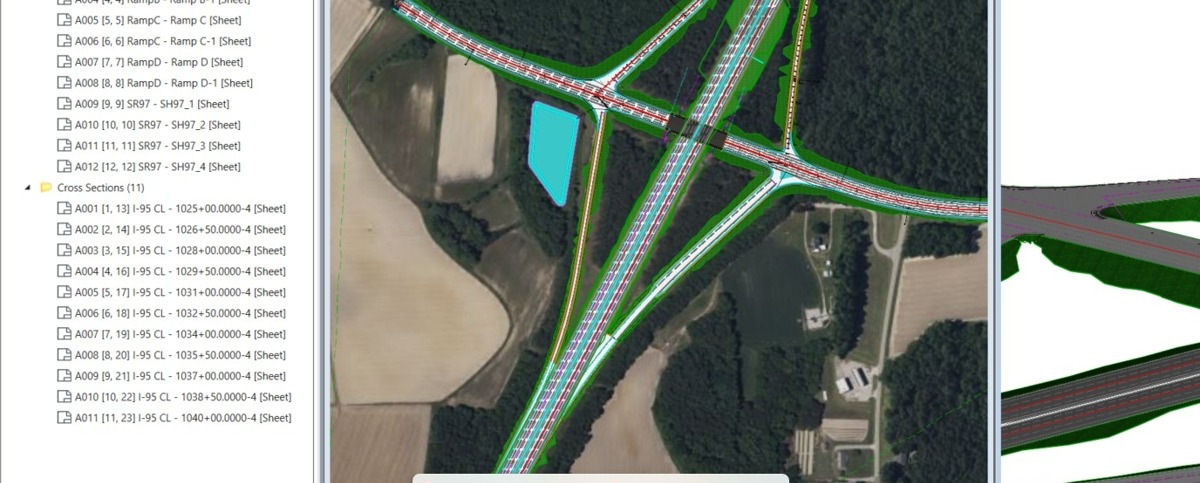

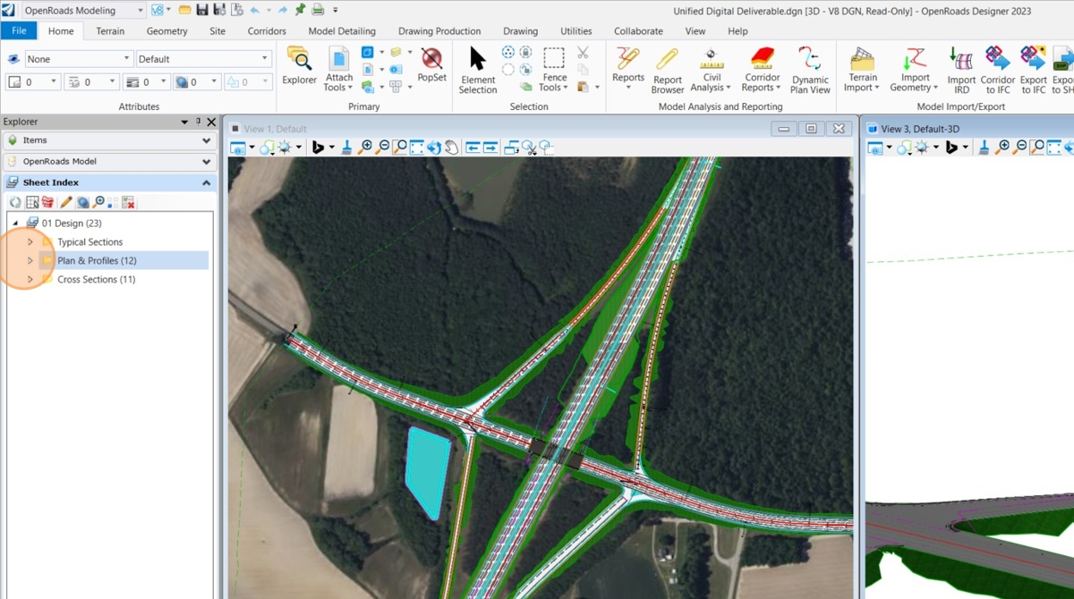

1. Set up a sheet index within OpenRoads
{Figure 2: Sheet index within OpenRoads and Infrastructure Cloud}
2. Toggle to include the sheet index within the infrastructure cloud connection
{Figure 3: Connection setup within Bentley Infrastructure Cloud}

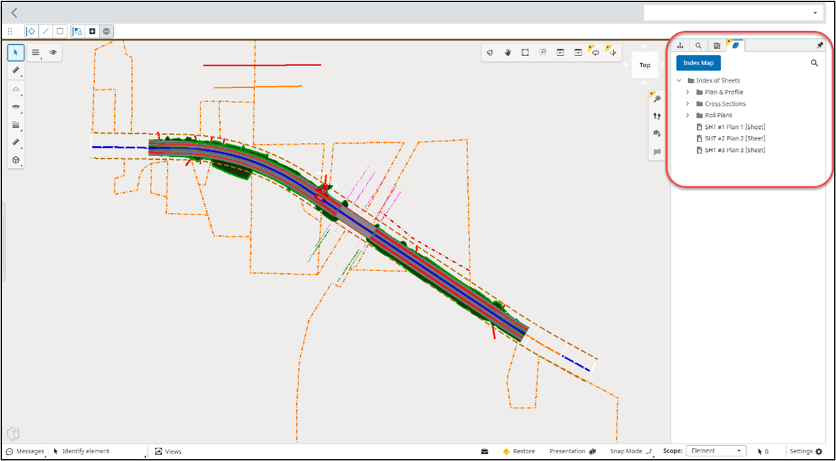

Finding the Sheet Index
Once the project with a sheet index is published to Infrastructure Cloud, the index of sheets is located behind the Civil Frontstage. You can open the Civil frontstage from the drop-down menu on the upper left of the model view.
{Figure 4: The Civil frontstage is located on the menu in the upper left of the model view}

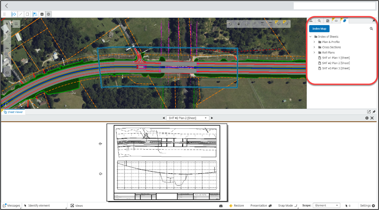

The Sheet Index widget is in the fly-out panel on the right side of the model view.
{Figure 5: The sheet index is located on the right-hand panel}

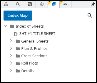

The Sheet Index widget allows navigation of sheets in the project and selection in two ways, as a graphical Index Map or by navigating a folder structure for the Index of Sheets.
{Figure 6: Sheets can be opened using the Index of Sheets list}

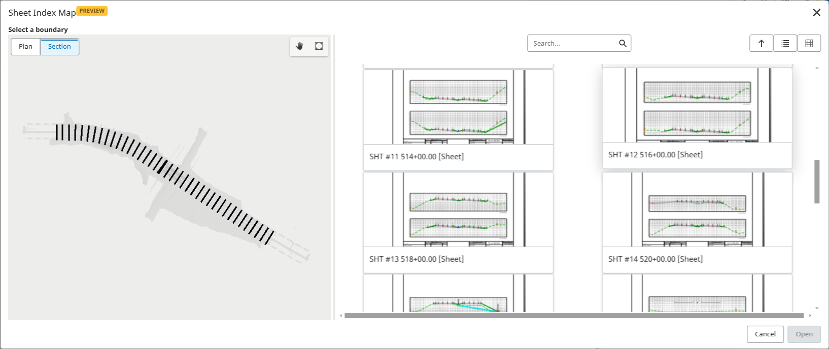

Index Map

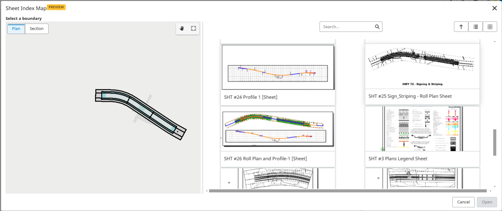

The Sheet Index Map provides both a graphical location selection for sheet named boundaries (plan or sections are supported with a mode toggle) in a simplified project location overview preview with basic zoom / pan options to help locate and emphasises any named boundaries used in the sheet index (left hand side), as well as a sheet list that can be presented as either a list or with preview thumbnails (default). The Sheet index map includes text search capability for the sheet name.
{Figure 7: Sheets can also be selected and opened from the Sheet Index Map}
[Note - where a named boundary is selected graphically that is used in multiple sheets, a filter is applied to the available sheets in the right-hand panel, allowing selection of the desired sheet.]
{Figure 9: Section named boundary mode for the Sheet Index Map}

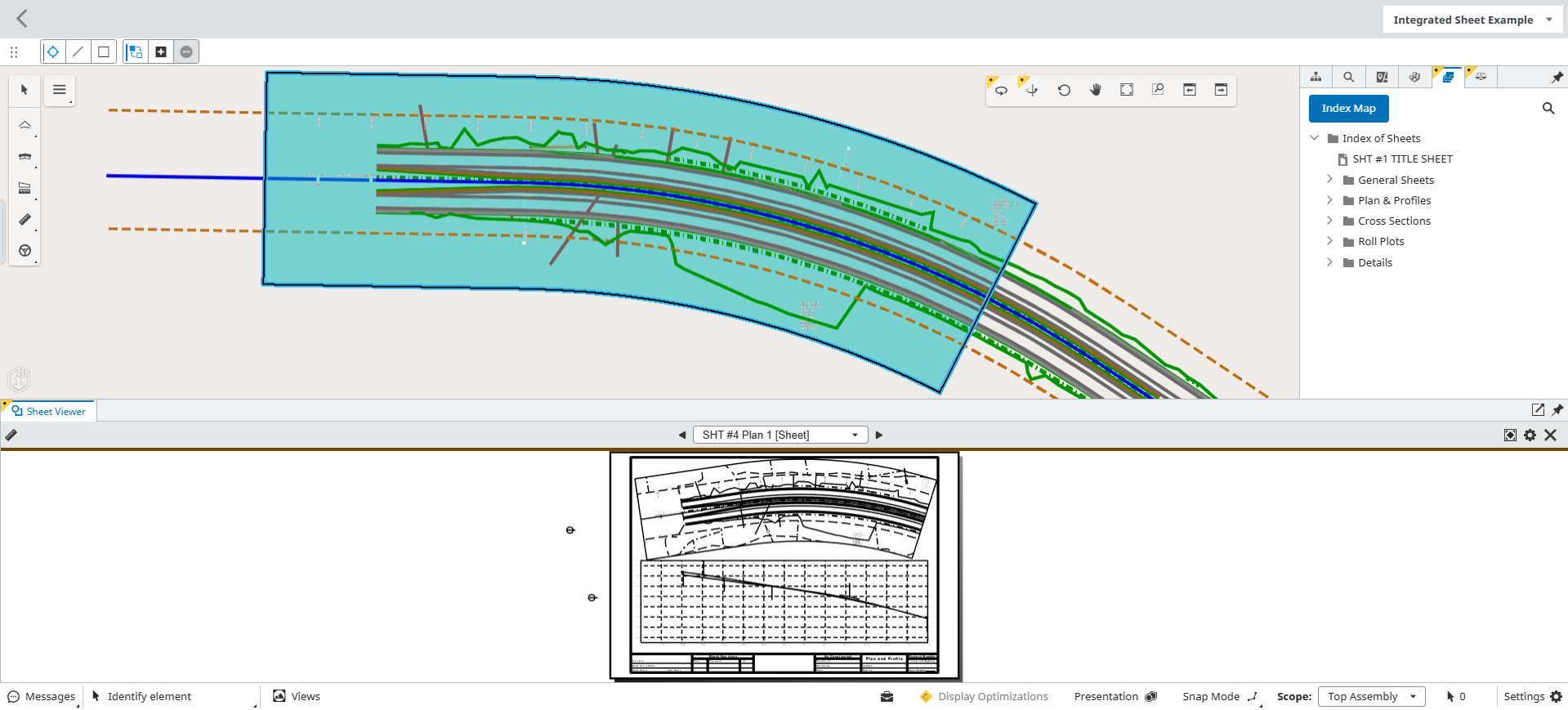

Once a sheet is selected a sheet view will open after selecting a sheet from the list.
A computer screen shot of a diagramDescription automatically generated
{Figure 10: Sheet Viewer default docking after selection of sheet}
[TECHNICAL PREVIEW] Sheet Viewer
The Sheet Viewer defaults to a docked state below the model view. It can be unpinned as a floating window to support full screen viewing with multiple monitors (Technical Preview). The viewer supports the core View Controls ribbon as well as interactive zoom and pan.

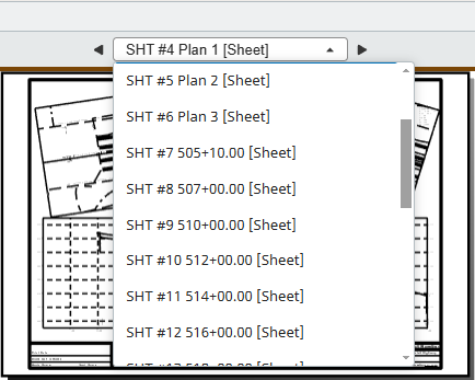

Sheet Selection
The tool allows for simple stepping forward and backward for the current sheet series as well as a drop down listing for all project sheets in the index.
{Figure 12: Sheet Selection menu}

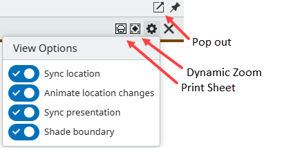

The View Options provide some controls for Interactivity between the sheet and design model views.
Sync Location – when selecting a sheet, the design model view synchronises to the current sheet.
Animate location changes – on changing sheet the model view, to provide a sense of location, animates the zoom out from it’s current location, tracks to the new location where it zooms in rotating the view to fit the new sheet.
Sync Presentation – this option overrides active saved view / model / category selections, to present a ‘close presentation match’ for the categories used the sheet.  [Note - It does not re-symbolize the model where display overrides / pen tables are applied in the sheet, clip the model contents to the sheet or apply any annotation in the sheet.]
Shade Boundary Presentation – this option applies a light shading to the current named boundary
Additional Sheet tools
Dynamic Zoom (on/off) – this option enables selections in the sheet model to automatically zoom the model to the element selected in the sheet. Each view (model / section / profile / sheet) has this option, and it allows selection in a view and if present will automatically zoom to the same element in the other views.
Popout active widget – this option opens the docked widget to a floating view that can be moved to another screen and viewed full screen. Closing a Pop Out view will dock it again.
Print Sheet – this option allows water marked printing of the current sheet and includes an embedded URL link.
{Figure 13: Sheet View Options menu}

  1. Background on OpenRoads Designer Sheet Creation & Sheet Index Playlists
    1. Drawing Production-Creating Plan & Profile Sheets - https://www.youtube.com/playlist?list=PLnJUnxLwu_N6ZO_44f5pCfR2TxtJBPXn6
    2. Drawing Production-Creating Cross Section Sheets - https://www.youtube.com/playlist?list=PLnJUnxLwu_N7ebSDZyWVDtPaKScmODy3B
[Note: The sheet index can be published from the desktop applications with either .dgnws and .dgnsi using a ProjectWise datasource.  However only a dgnws is supported by the iTwin synchronizer at this time]

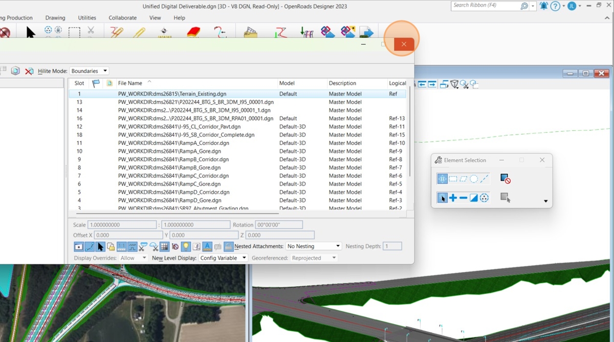

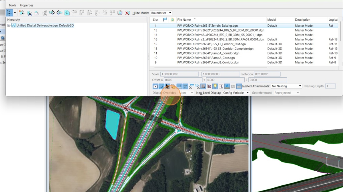

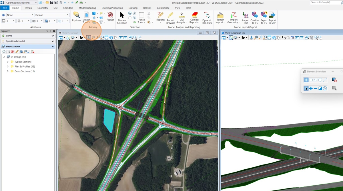

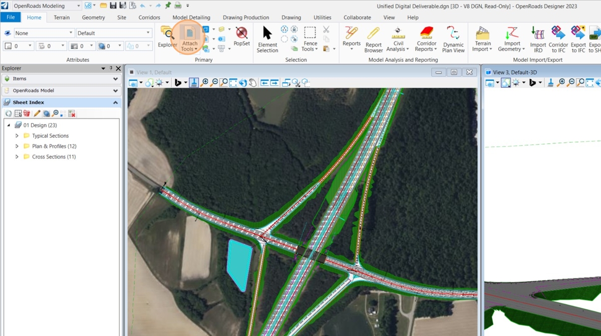

  1. To understand the best practice for publishing integrated digital sheets, the 3D model, and data associated with those elements, we're going to begin in OpenRoads Designer. You see here on the screen, the model as designed within OpenRoads in 2 views, the 2D top view on the left and 3D iso view on the right.

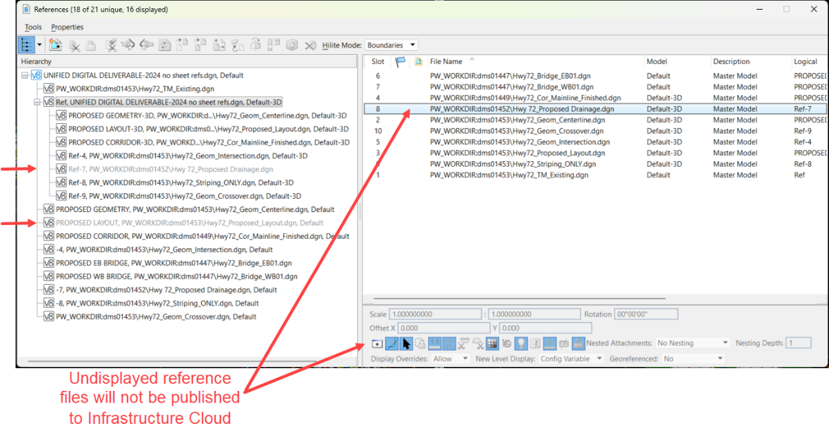

  1. To look at the files referenced together to create this composite 3D model, click the “References” button.
  1. We look for a moment at this particular file.
    We are in a .dgn, called unified digital deliverable. This is a composition of multiple .dgn files containing 3D model elements such as alignments, ramp corridors, mainline corridors, terrain models, and drainage networks referenced together into a single file. This .dgn, called unified digital deliverable is used to create a cohesive, composite view of the project's 3D model.
  1. You can see and edit the list of files refenced to the current .dgn file.

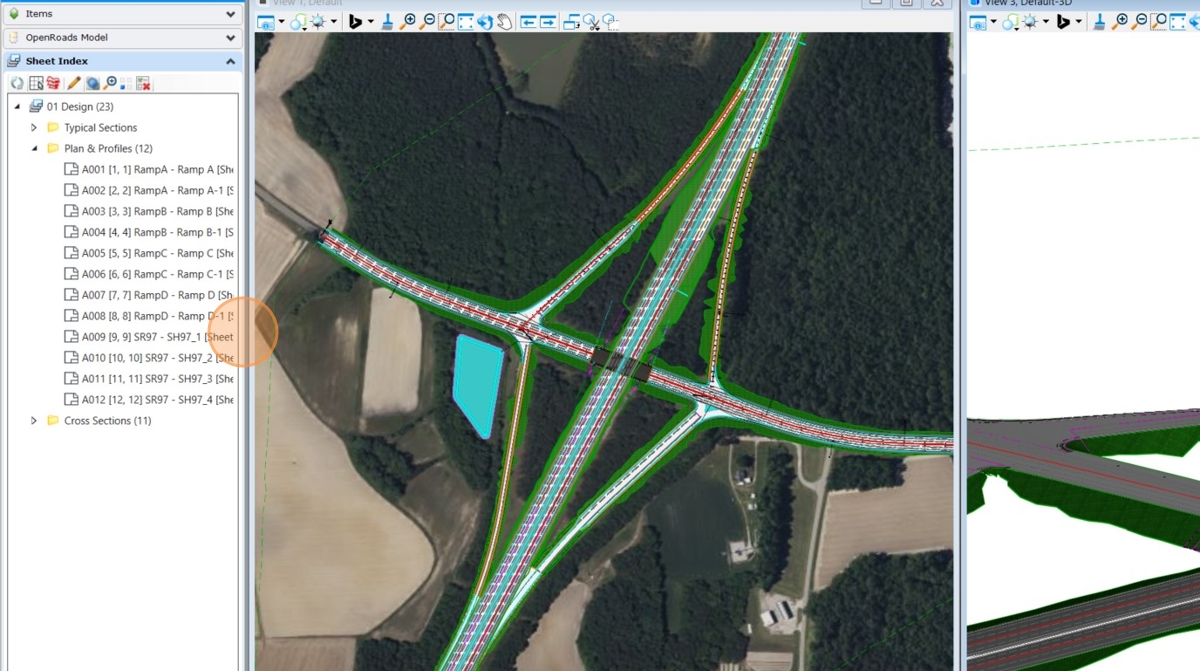

  1. In addition to the files containing 3D models, you'll see the sheet index on the right.
  1. This is an index of sheets that allow you to include, organize, and number sheet models as needed to create a list of sheets for a project. We have here a compilation of sheets which you see on the left-hand view within the sheet index dialog box.

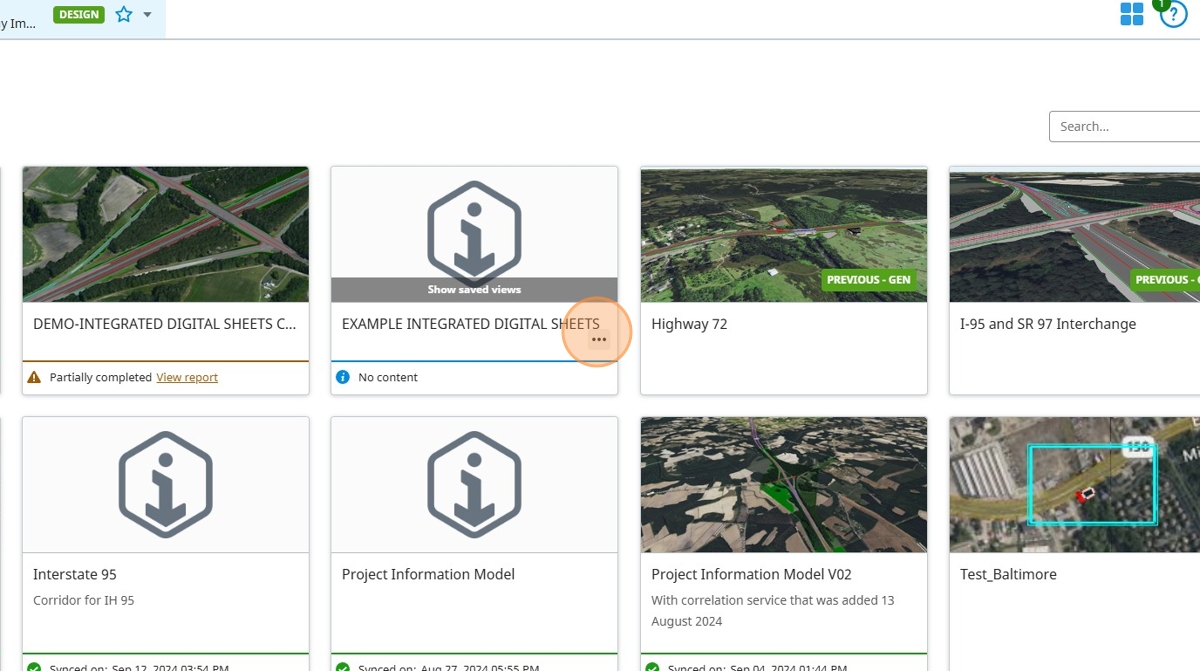

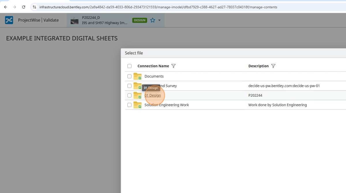

  1. We move to Infrastructure Cloud, where we open an iTwin project.

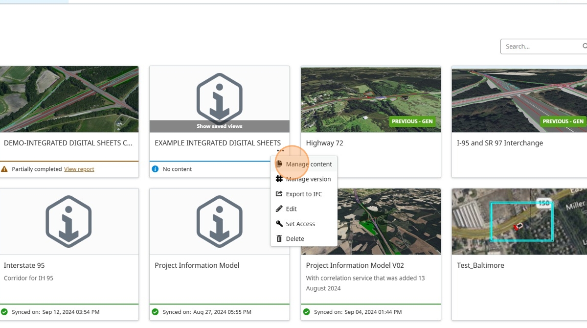

To build a connection to an iModel, begin by clicking the 3 dots on the lower right of the iModel tile.
  1. Select 'Manage Content'.

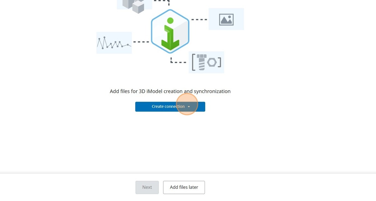

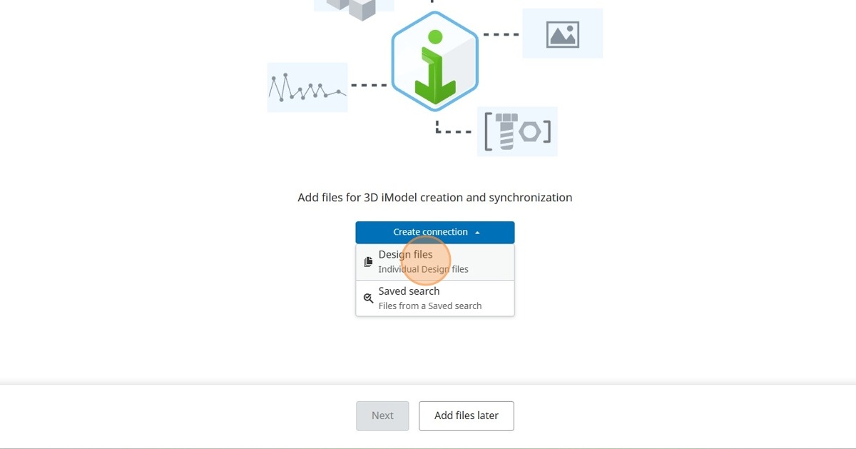

  1. Click "Create Connection".

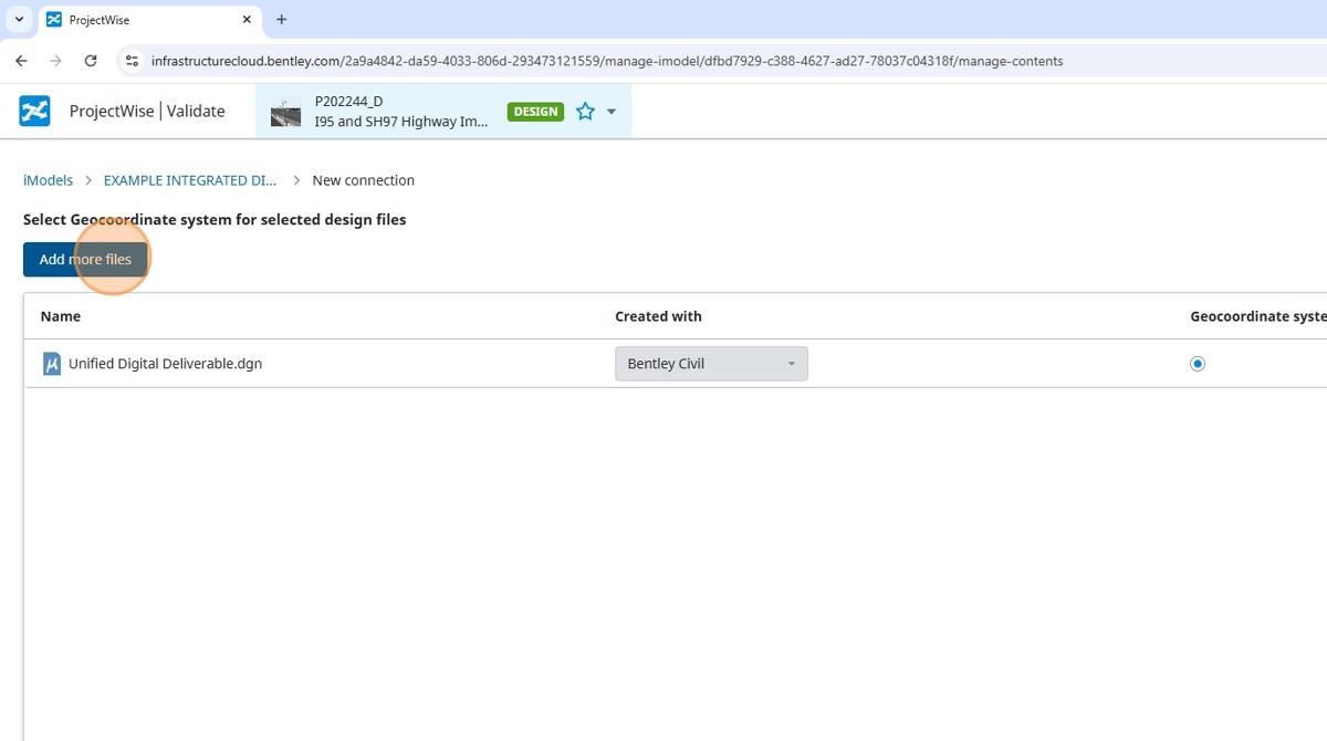

  1. In this example, we are going to select the design files from a connected datasource in ProjectWise.
    Click "Design files".

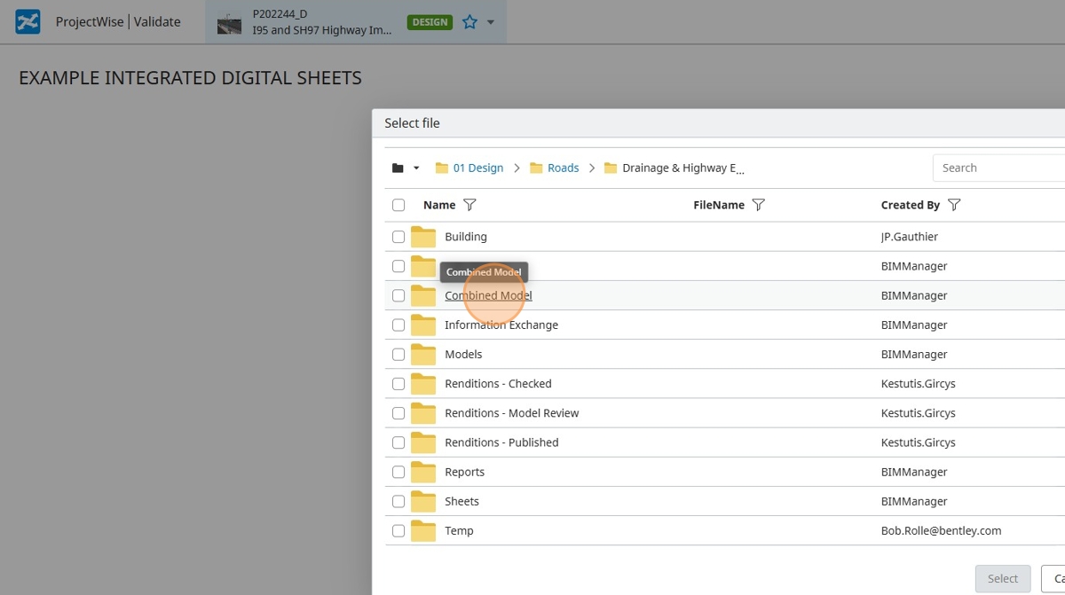

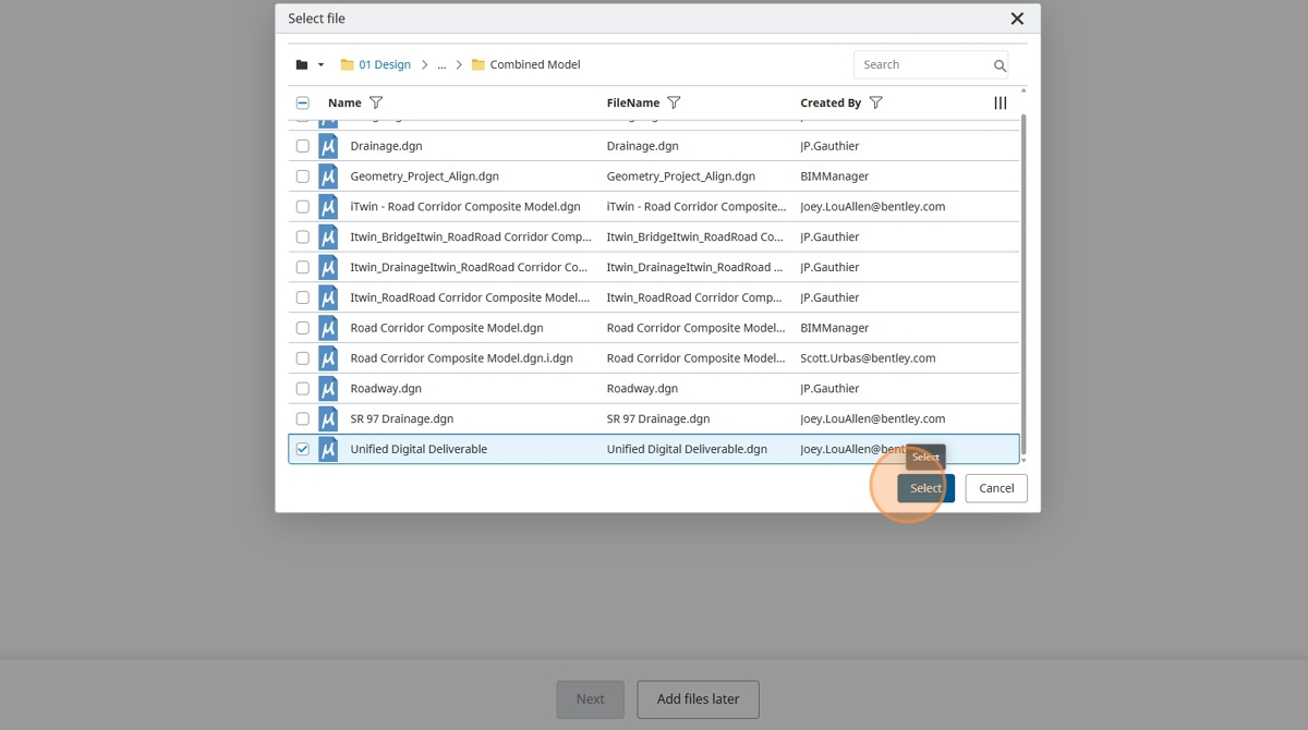

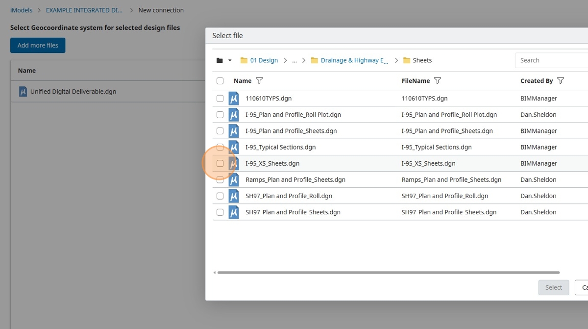

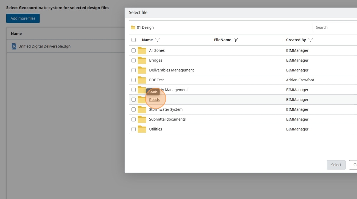

  1. Browse to the files to be included in the connection. Select the file containing the 3D model data first.
  1. Select the correct folder.
  1. Select the file that has the 3D model data referenced into it.
  1. Click "Select."

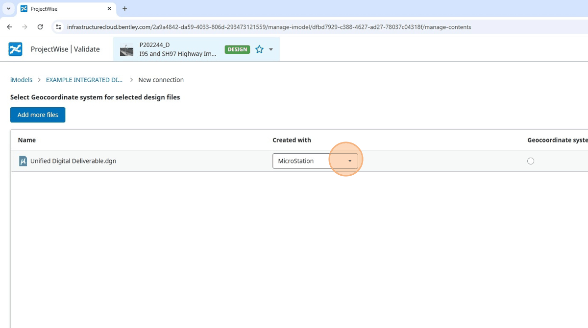

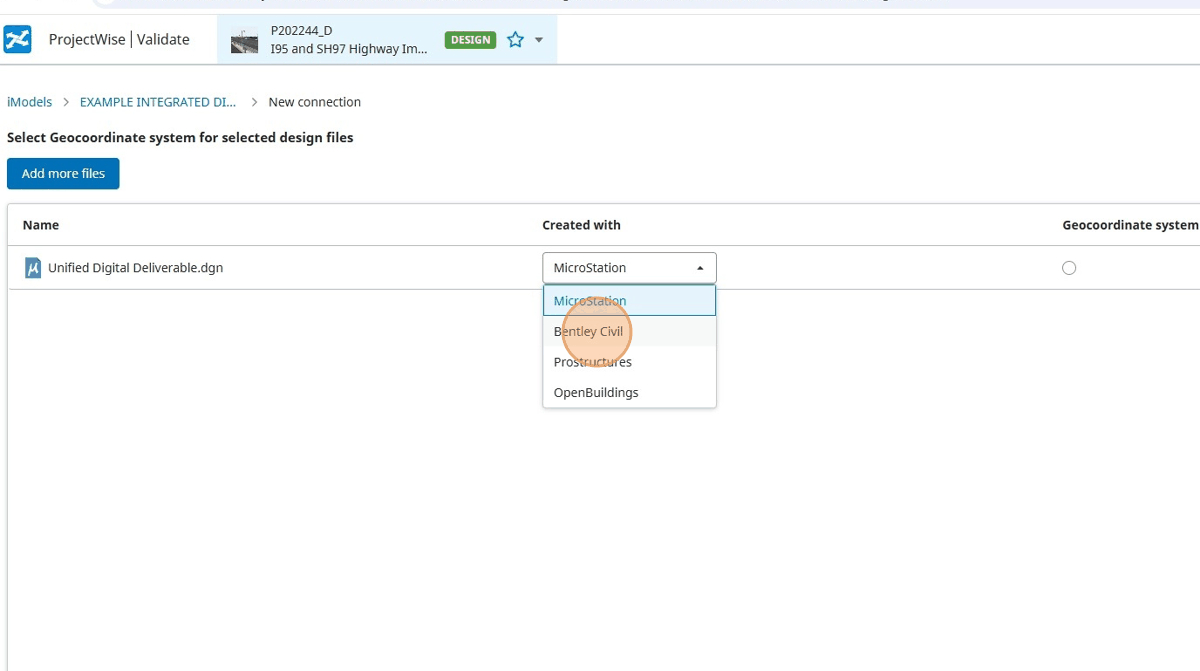

  1. Click the dropdown menu to select the appropriate connector.
  1. Select the "Bentley Civil" connector.

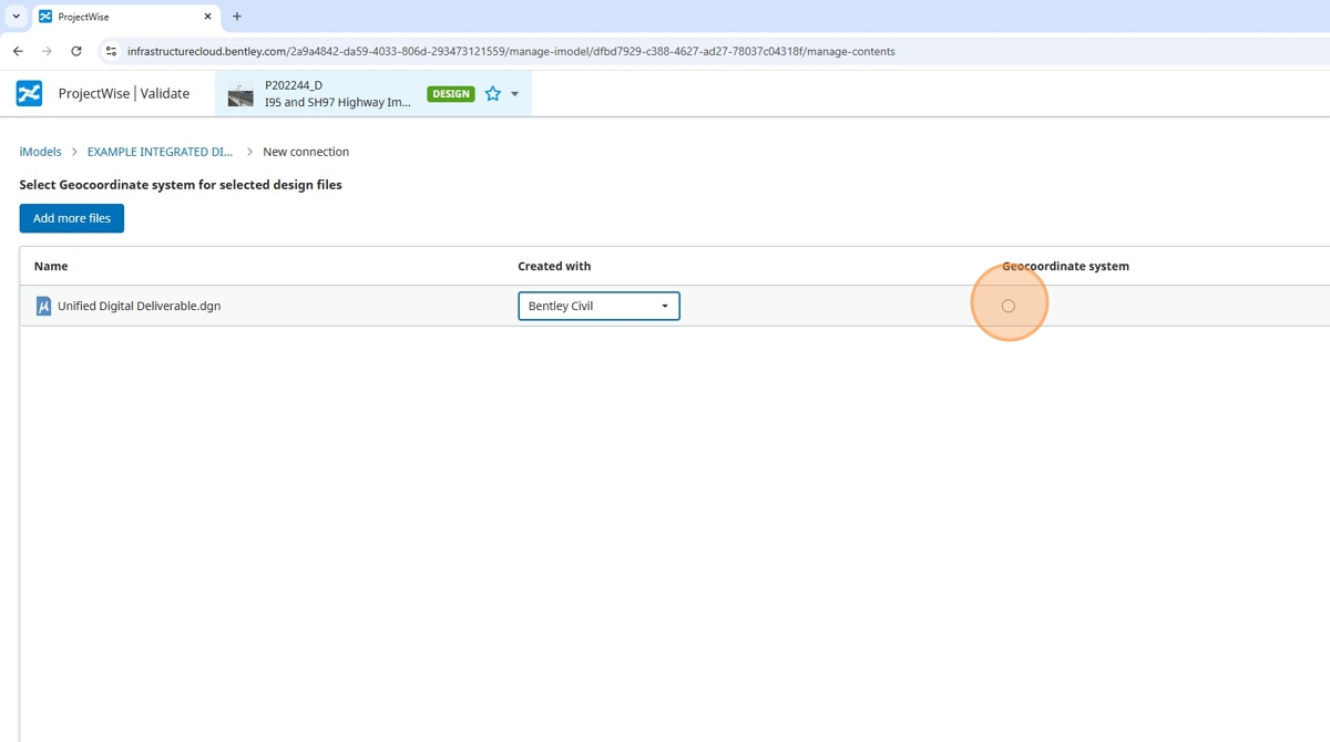

  1. Select "Geocoordinate system" for the file containing the real-world model data.
    There can only be one file used to set the coordinate system.
  1. Click "Add more files".
  1. Browse to the location of the required files containing the sheet models.

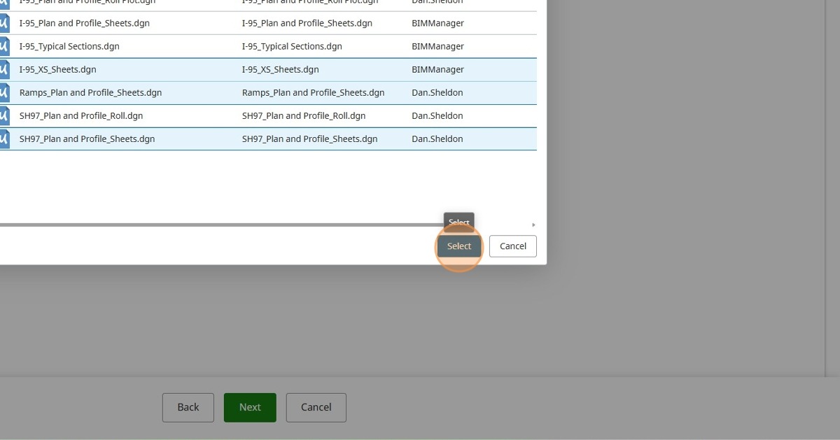

  1. Select the .dgn files you wish to include in the connection.

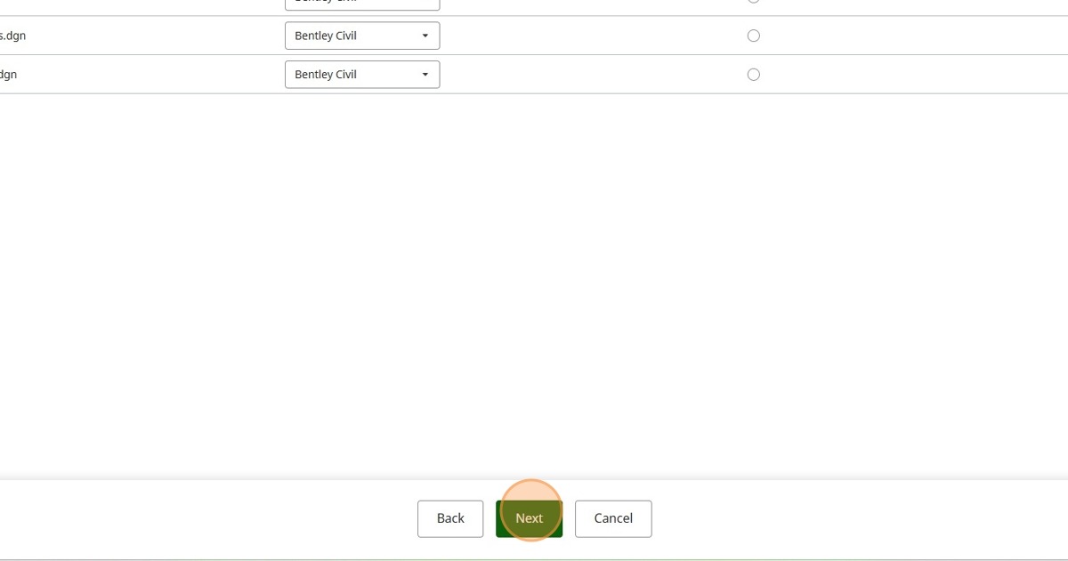

  1. After selecting the .dgn's to include, click the 'Select' button
  1. Select the Bentley Civil connector from the drop-down menu for all files and click "Next."

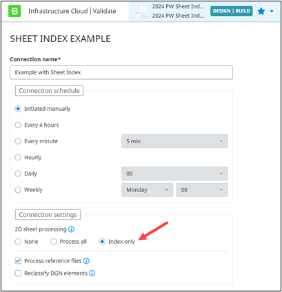

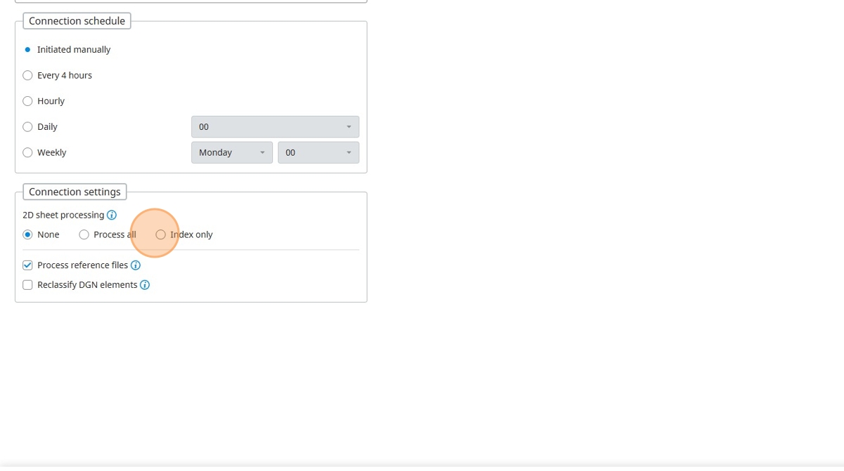

  1. Select the desired schedule to sync the files.

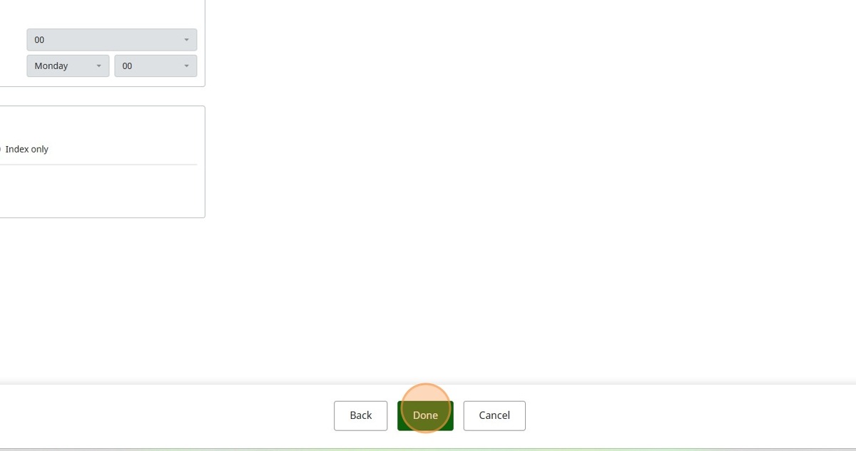

    Select "Index only" and "Process reference files" within the Connection Settings.

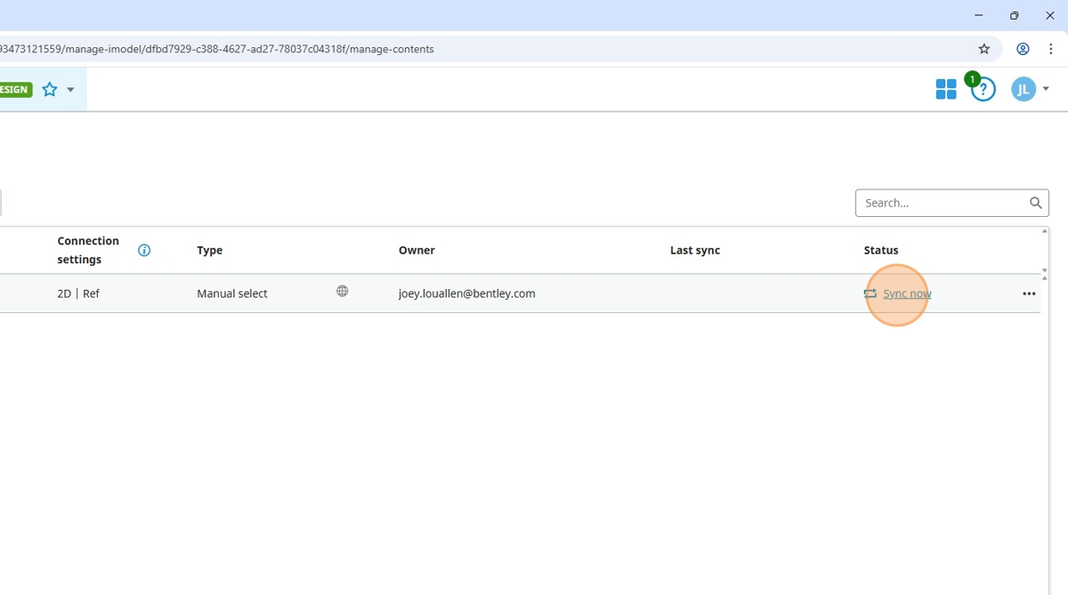

  1. Click "Done" to store the connection.
  1. To review the connection or make changes, click on the connection name.
  1. Changes can be made to the connection settings.
  1. To publish or "sync" the project data to the Infrastructure Cloud iModel, click "Sync now."
 The files, including the reference files will be published into the iModel. This may take a while, especially on the first sync of the dataset.
