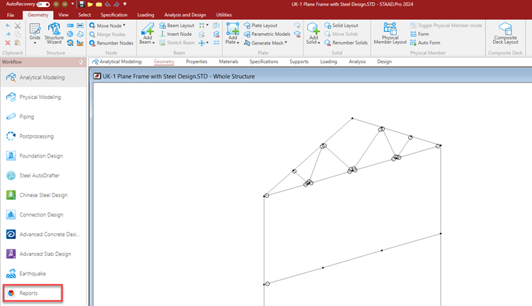

  1. Open a STAAD model that is hosted on a network folder e.g. \\server\staad folder\filename.std and click on the “Reports” workflow.
    fig. 1

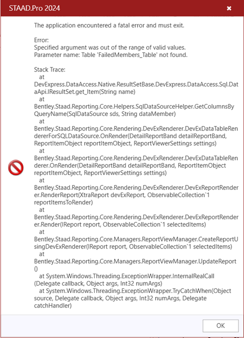

  3. STAAD.Pro will terminate and display an error dialog thus:
    Fig. 3
  4. It is possible to forward to Bentley the details of the action taken to trigger an application crash as shown in fig 3. Once, that dialog is closed, further details will be displayed as illustrated in fig 4.
    Fig. 4
Note, this issue only occurs if selecting items from the Post Processing category as shown above. The issue is not triggered by creating a report if only using items from the other report categories.

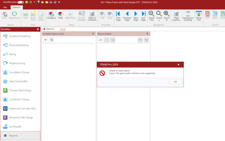

Mapped Drive: A similar effect is encountered if the model is accessed from the server using a mapped drive, e.g. Z:\ (\\network computer\network folder\filename.std),
However, in this situation, a warning is displayed indicating that the user report cannot be created. The following illustrates the effect in this situation: -
  1. Open a STAAD model that is hosted on a mapped folder e.g. Z:\ (\\network computer\network folder\filename.std),
  2. Click on the “Reports” workflow. An error message is displayed that indicates that the User Report workflow cannot be used.
    Fig. 5
