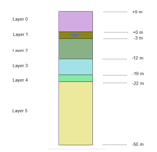

The piles are to be installed in a uniform subsoil consisting of multiple sand layers of different relative densities after excavation of the 9 m top layer. Initial water level is located at h = -1m (see Figure 1). The PLAXIS numerical analysis will be considering the initial soil removal to obtain the most realistic possible state of stress at pile installation.
 Figure1: Subsoil profile presentation

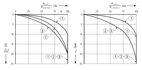

The load-displacement curve(s) to serve as a reference for calibrating the numerical model must be evaluated. Ideally, this involves conducting experimental pile load tests on-site. However, in cases where such data is unavailable, geotechnical engineers rely on engineering codes and guidelines for pile foundation design. In this example, the suggested load-displacement curves from NEN 9997-1 (2012) have been considered. These curves provide normalised load-displacement data for both pile base resistance and shaft resistance, applicable to ground displacement piles and bored piles (refer to Figure 2).
Figure 2: Characteristic normalised load-displacement curve
It should be noted that the curves present the evolution of the pile base displacement for both cases. To fully develop the load-displacement curves for our specific case, it's necessary to evaluate the maximum base and shaft resistances pertinent to the current ground conditions and pile geometries. Pile load carrying capacity depends on various factors, including:
