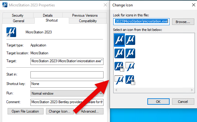

When launching MicroStation a Padlock Icon is being displayed on the Windows Task Bar

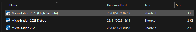

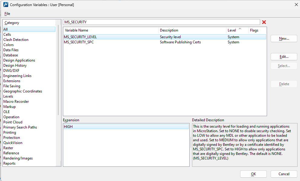

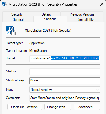

The Padlock on the icon is typically used when MicroStation is being run in High Security mode.
Check:
C:\ProgramData\Microsoft\Windows\Start Menu\Programs\MicroStation 2023\MicroStation 2023
File > Settings > Configuration > Configuration Variables
Right mouse button click on Shortcut and select 'Properties
