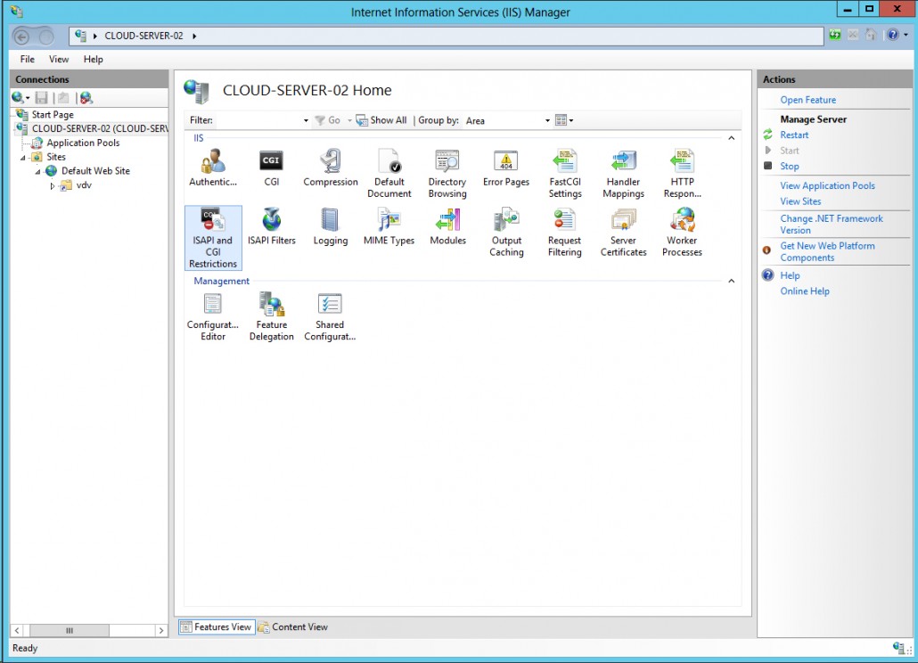

Install IIS

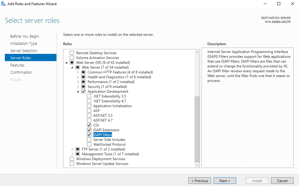

  1. In order to install IIS, open Server Manager and select Manage and click Add Roles and Features
    Click on Next until Server Roles comes and then check Web Server (IIS) from the list.
    After having added Web Server (IIS) make sure to locate Application Development and check CGI, ISAPI Extensions, and ISAPI Filters. Install the features and the IIS services should be ready for configurations (it could be necessary to restart the server at this point).

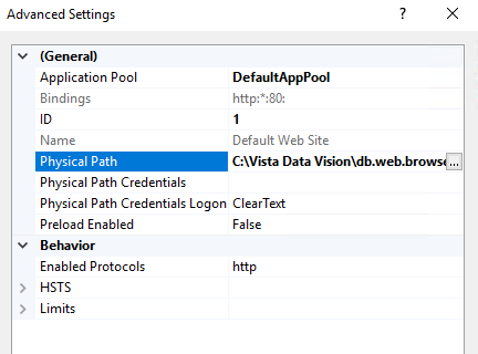

  2. Open Control Panel → System and Security → Administrative Tools → Internet Information Services (IIS) Manager.
    Left click on Default Web Site → Manage Website → Advance Settings.
    Change Physical Path to C:\Vista Data Vision\db.web.browser\vdv_www

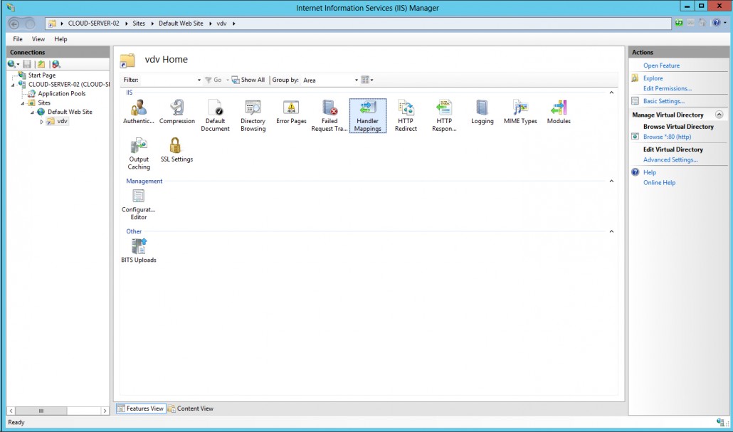

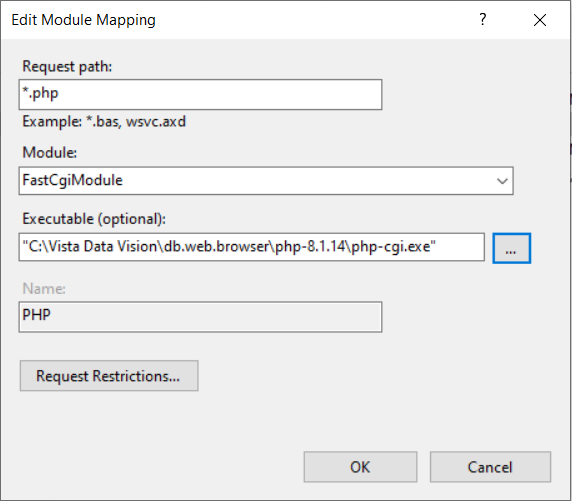

  3. Select Default Web Site and double click on Handler Mappings.
    A screenshot of a computerAI-generated content may be incorrect.

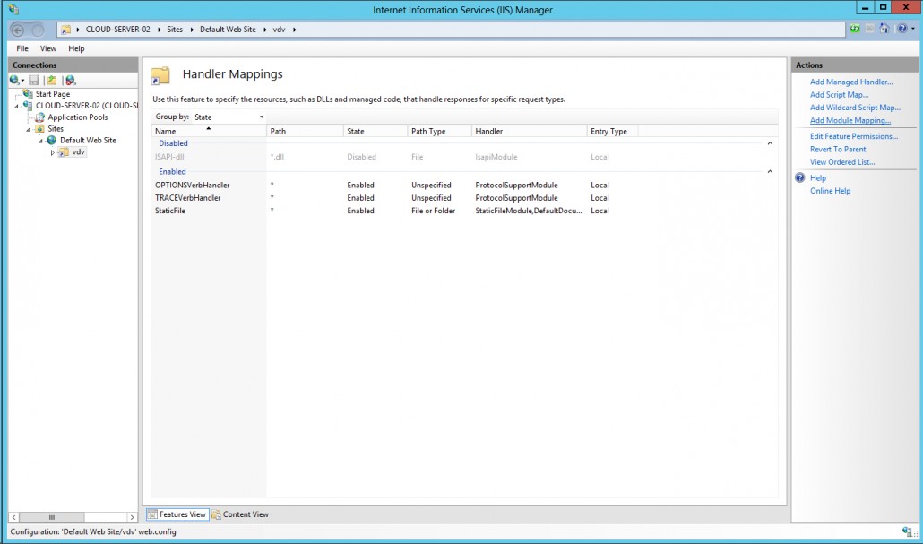

    Click on Add Module Mapping... in the top right corner. A screenshot of a computerAI-generated content may be incorrect.

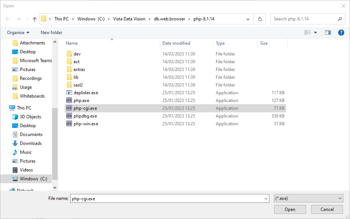

    When selecting the Executable (optional): make sure that you select (*.exe) in the bottom right corner and php-cgi (default location is C:\Vista Data Vision\db.web.browser\PHP-8.1.14\php-cgi.exe).
    Select FastCgiModule from the Module drop-down list. It may be necessary to place "double quotes" around the Executable path (as shown in the image below). Enter PHP8 for Name. Press OK to finish.

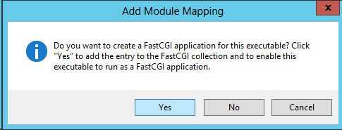

    Click Yes to allow PHP.

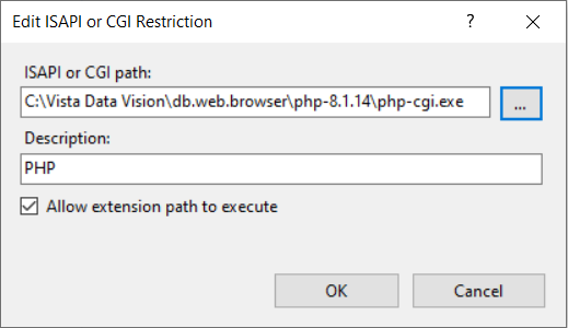

  4. Select the top node in the Connections list (the server name).
    Double click on ISAPI and CGI Restrictions.
    If php.exe has not been added to the list then it needs to be added manually. For adding PHP manually click Add... in the top right corner.
    Browse to php-cgi.exe for ISAPI or CGI path (default location is C:\VistaData Vision\db.web.browser\PHP-8.1.14\php-cgi.exe). Remember to select (*.exe) in the bottom right corner when locating php-cgi.exe Enter PHP for Description. Check Allow extension path to execute. Press OK to finish.

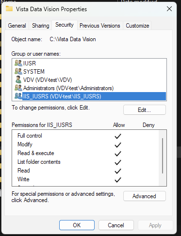

Change folder permission
For VDV to be able to apply updates to the system USERS, IUSR and computer-name\IIS_IUSRS need to have full control over the /Vista Data Vision folder

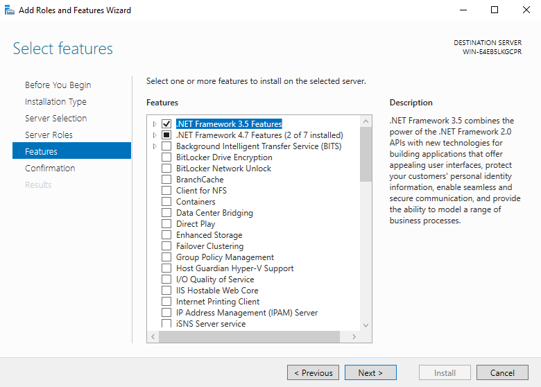

Open Server Manager → Manage → Add Roles and Features. Select .NET 3.5 from Feature list.
