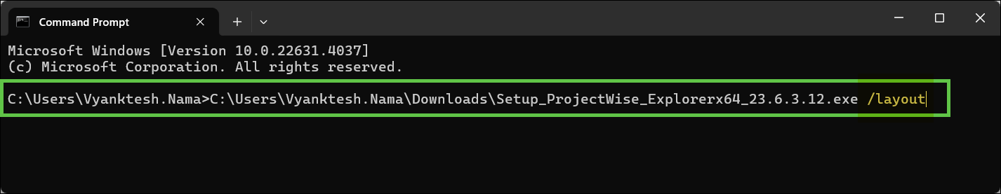

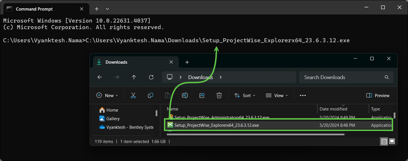

1. Open Windows Command Prompt and change the active directory to the location of the ProjectWise Explorer installation executable file on your computer or network drive.
2. Input or copy\paste the executable's complete file name with extension (or simply drag and drop the ProjectWise Explorer setup file).
3. Type " /layout" followed by the path of setup file (example shown below) then hit Enter key.

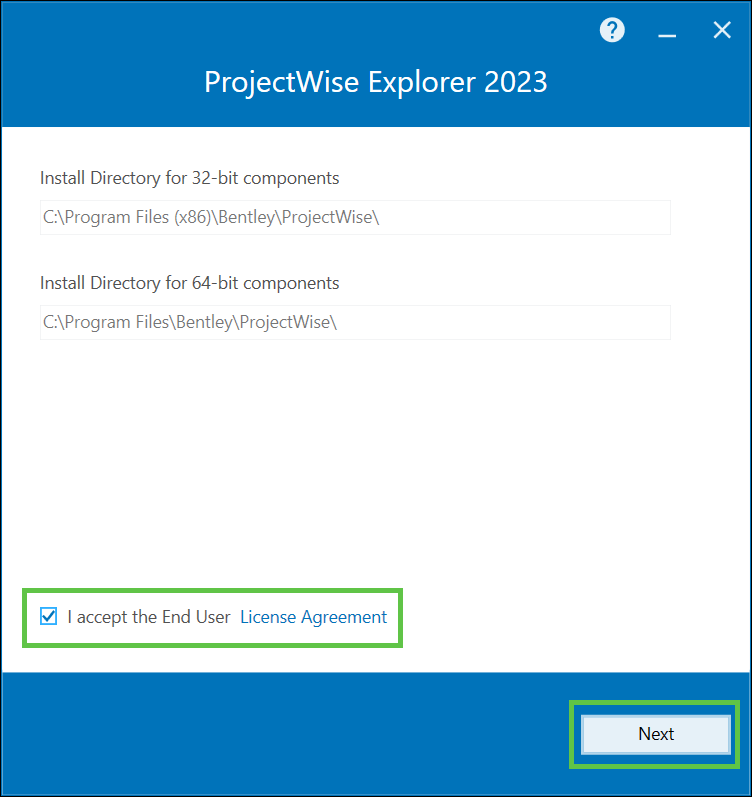

4. The ProjectWise Explorer layout creation wizard will open, accept the License Agreement and click Next.

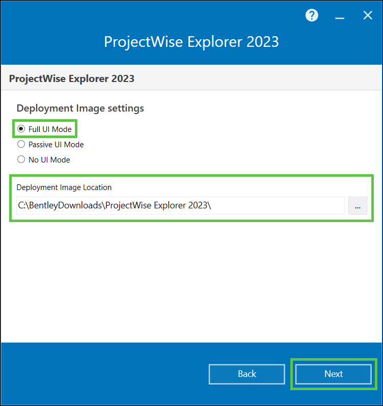

5. The Deployment Image Settings page opens. Change the deployment image setting as needed. By default, Passive UI Mode is selected. The settings affect the installation user interface for the deployed image in the following ways:
6. To change the deployment image location, click the Browse button next to the Deployment Image Location path and browse to the drive\folder you want the product to be deployed in, then click OK. Then Click Next

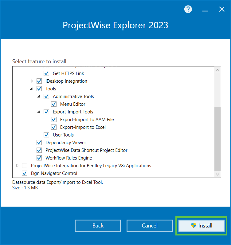

6. The Features page opens, turn on or off the features to be included in the deployment image, as desired and then click Install

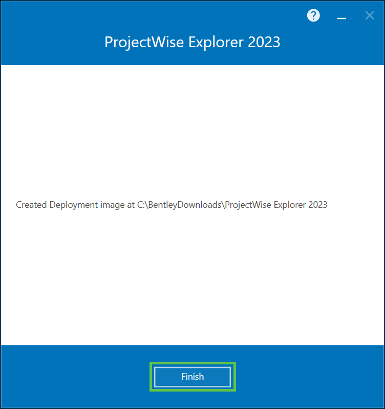

7. The application will begin downloading all necessary files to the selected deployment image location. Once done, click Finish to exit the ProjectWise Explorer layout creation wizard.

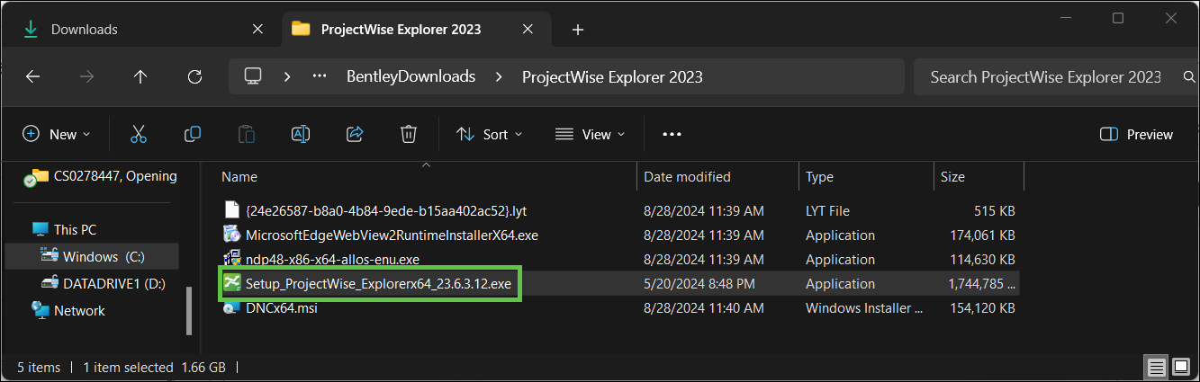

The deployment image is created at the selected location.
8. To install ProjectWise Explorer on a computer using the deployment image, copy all deployment image files (including the lyt file) to the target computer and double-click on the "Setup_ProjectWise_Explorerx64_XX.XX.XX.XXX.exe" file indicated below and install the application.
