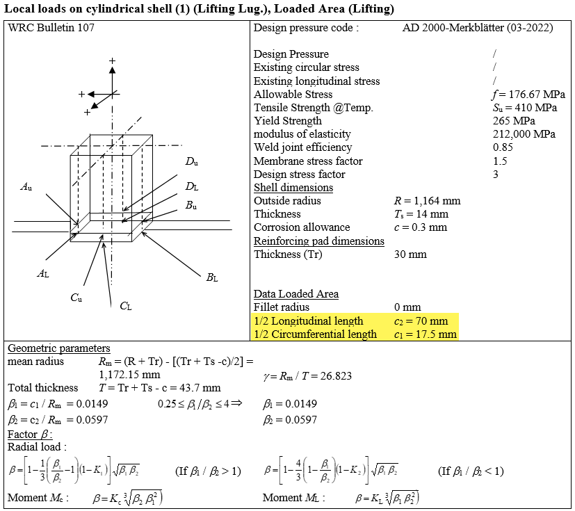

How AutoPIPE Vessel calculates values of C1 and C2 for local loads on cylindrical shell?

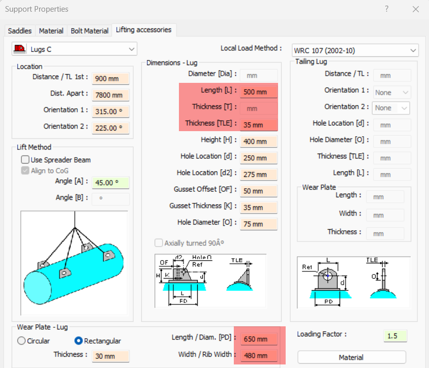

Lug attachment loaded Area:

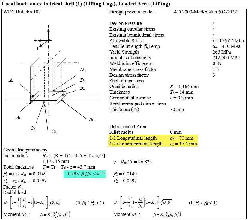

As you can see in the report, Ratio of ᵝ1 and ᵝ2 values should be in between 0.25 and 4.
That means ratio of c1 and c2 should be within the 0.25 and 4. Hence to meet this criteria AutoPIPE Vessel take the appropriate value of c2.
Refer below example for reference
At Loading Area:
Here half of circumferential length c1 = 17.5 mm (half of the lug thickness 35mm)
half of Longitudinal length c2 = 70 mm (4 times the c1 to maintain the maximum ratio)
At the edge of reinforcing pad:
Here half of circumferential length c1 = 240 mm (half of the RF pad width 480mm)
half of Longitudinal length c2 = 325 mm (Half of the RF pad length 650mm as the  ᵝ1 and ᵝ2 ratio is within the limit)

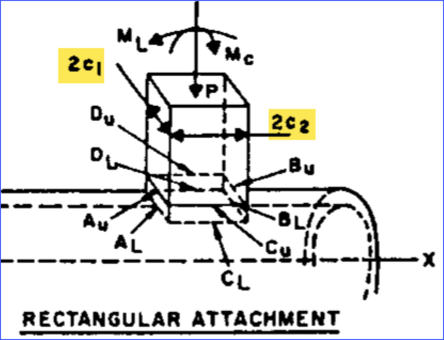

From WRC107:
From AutoPIPE Vessel:
2 c1 = circumferential length ==> c1 = 1/2 circumferential length (named "half width of loaded area" in help topic)
2 c2 = longitudinal length ==> c2 = 1/2 longitudinal  length (named "half length of loaded area" in help topic)
Below the equations to determine c1 and c2 for a rectangular attachment in APV:
if ( c1/c2 > 4 ) c1 = 4 * c2
if ( c1/c2 < 0.25 ) c2 = 4 * c1

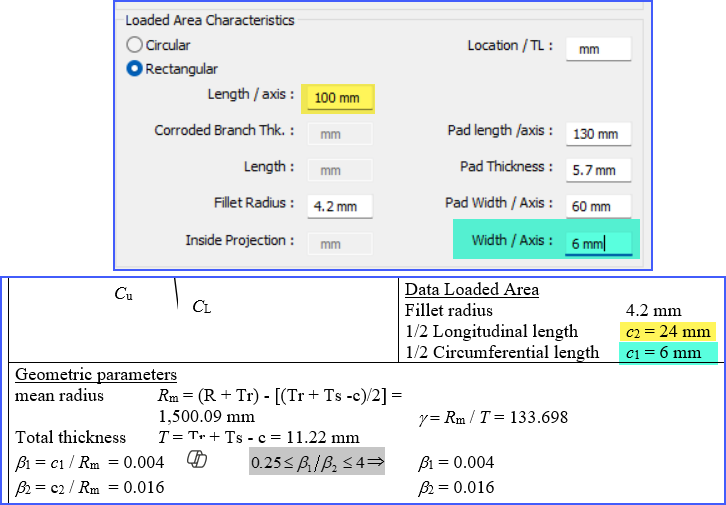

Example: 1, Length/axis = 100 and Width /Axis = 6.
      1. Calculate the ratio 6/100 = .06  or 100 /6 = 16.6.
      2. Are both ratios outside of the range for 0.25 – 4? YES
      3. Evaluate the smaller number between 6 or 100, take 6.
      4. Set C1 = 6 and calculate C2 by multiplying by 4. C2 = 24.
      5. See report image above.

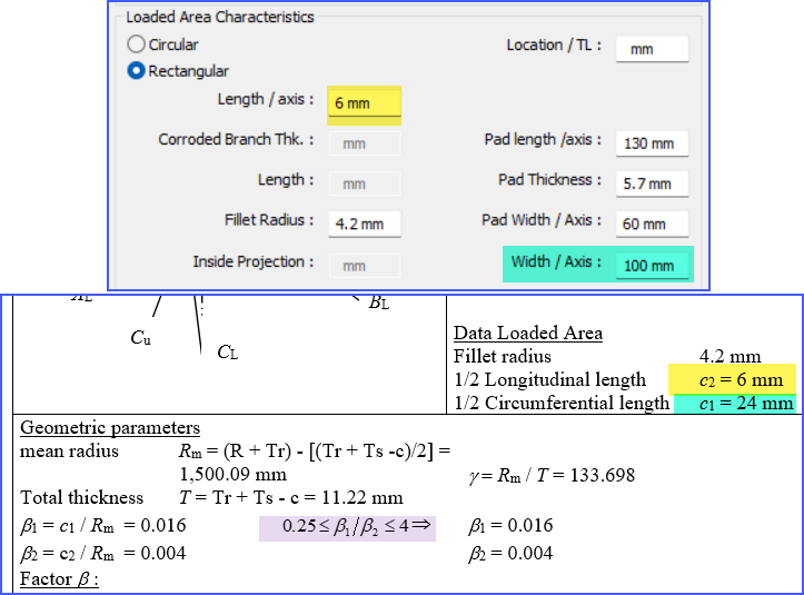

Example: 2, Length/axis = 6 and Width /Axis = 100.
      2. Are both ratios outside of the range for 0.25 – 4? Yes
      4. Set C2 = 6 and calculate C1 by multiplying by 4. C1 = 24.

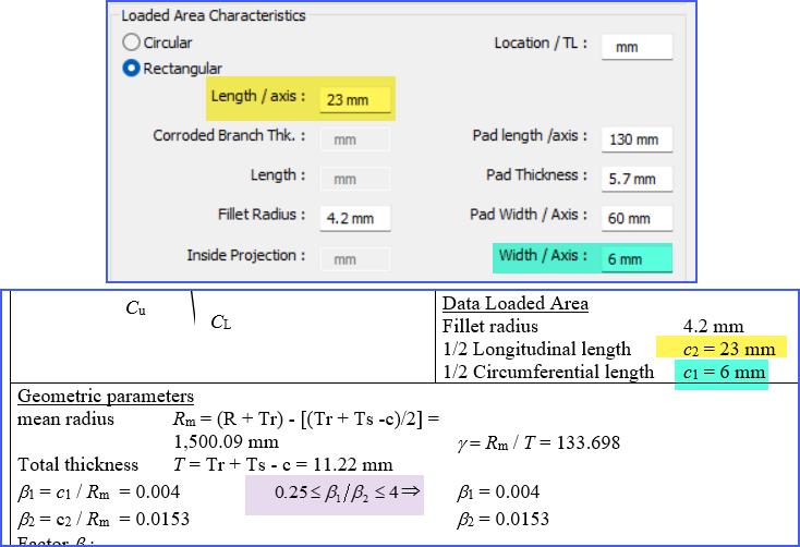

Example: 3, Length/axis = 23 and Width /Axis = 6.
      1. Calculate the ratio 6/23 = .26  or 23/6 = 3.8.
      2. Are both ratios outside of the range for 0.25 – 4? NO
      3. Use the values for C1 and C2 as entered in the dialog.
      4. See report image above.
In conclusion, as long as the ratio of the two values for Length/Axis and Width/Axis remains within the specified range of 0.25 to 4, the exact values entered in the dialog are utilized. However, if the ratio of these two values falls outside this range, AutoPIPE Vessel will take the lesser of the two values and multiply it by 4 to determine the other value as clearly demonstrated by the 3 examples above.
