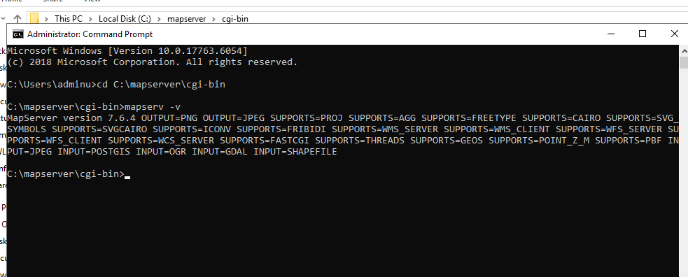

Before installing/upgrading a new AWLRS version it is better to check the mapserver version implemented on the server.
 On the server go to the directory mapserver\cgi-bin where the mapserver was installed and run the following command.
mapserv -v
this can be done using command prompt. Please see the screenshot below:
