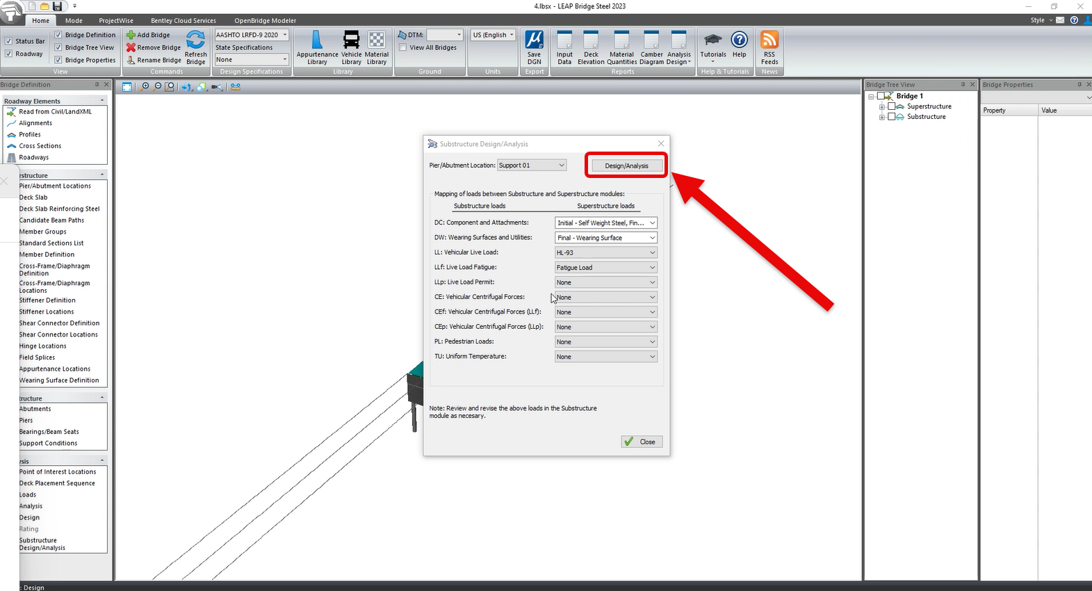

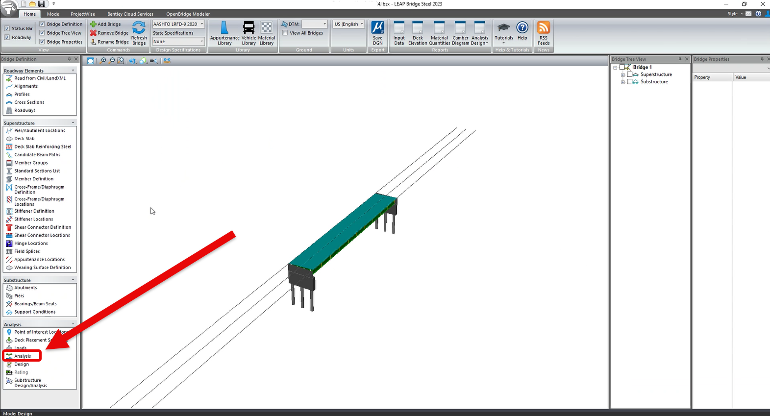

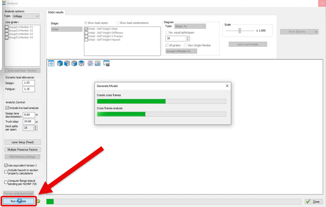

To run the Analysis of Loads in RC Pier inside LBC/LBS in OpenBridge Designer, the user needs to first run the analysis in the Superstructure to transfer all geometry and loading data to the substructure module. Only then will the user be able to continue working and run the local analysis with any additional loads and combinations that are required.
Check the step-by-step instructions in the screenshots below:
1. Access Analysis in Superstructure
1. Run Analysis in Superstructure
3. Access Design/Analysis in the Substructure Design/Analysis
