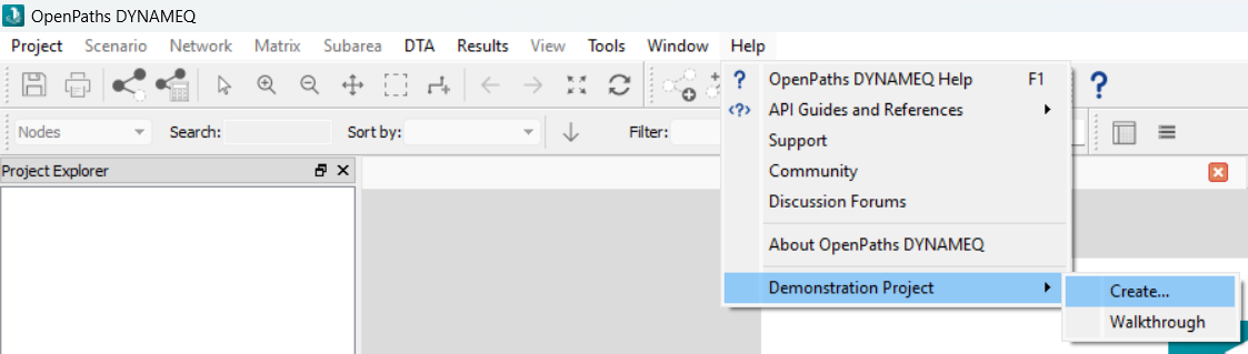

Opening DYNAMEQ Desktop for the first time, you should notice the Help menu. Choose Demonstration Project > Walkthough.
Creating the Demonstration project
OpenPaths DYNAMEQ is distributed with a demonstration project that can be used to explore many different software capabilities. This demonstration and teaching project is used to illustrate documentation examples and serves as the basis for training.
In the Help menu. Choose Demonstration Project > Create, and provide the location where you want to copy the demonstration project.

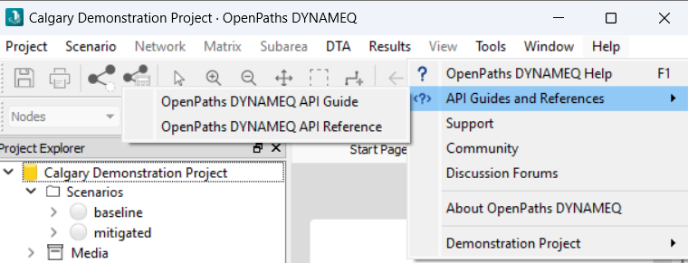

OpenPaths DYNAMEQ Documentation and DYNAMEQ Python APIs
OpenPaths DYNAMEQ Help contains all the information you need to know to use OpenPaths DYNAMEQ. It can be opened from the Help menu. DYNAMEQ API guides and references are available directly from the Help menu:
