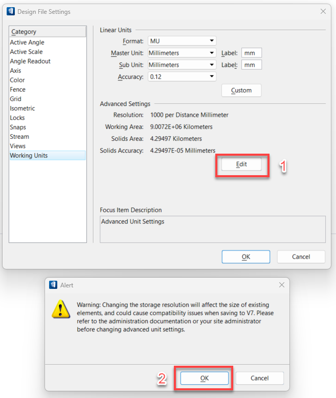

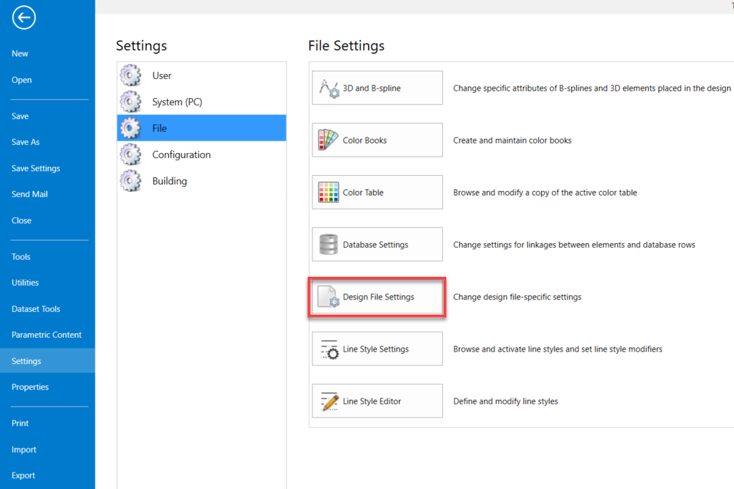

Step 2- Go to File > Settings > File > Design File Settings > Working units.

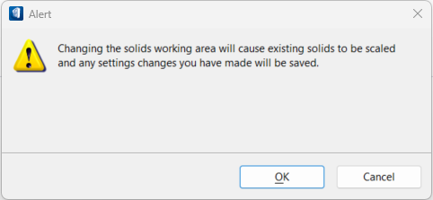

Step 3- Click on the Edit button under the Advanced Settings. Then click Ok in the Alert dialog box.

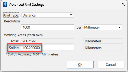

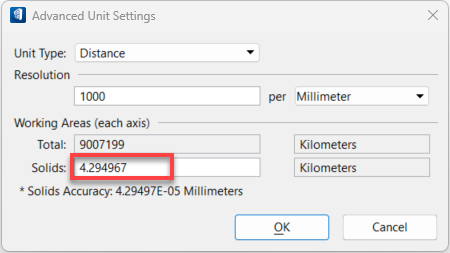

Step 4- Change the Solids value to 100 and click Ok.
Step 5- Then click Ok and Ok again to the alert window.
Thus the SWA is increased which is most likely to take the elements inside.
