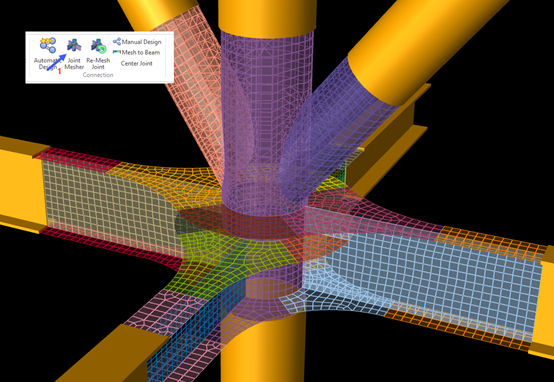

User can access this tool in Precede > JOINT > Connection > Re-Mesh Joint as specified below:

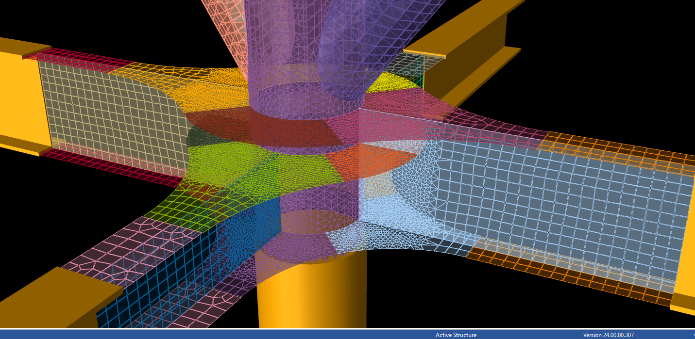

We use Sample 23 Joint Mesher for this example. After meshing the joint (2000) as below:

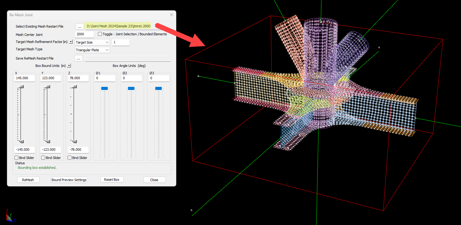

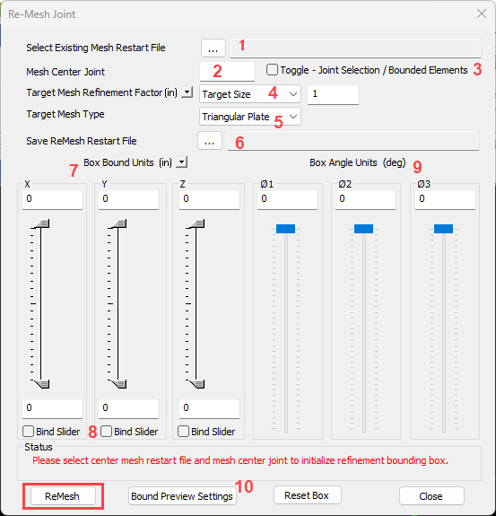

1. Use Select Existing Mesh Restart File to load the JointMesh restart file which was created when the joint was meshed. The restart file contains a map of the finite element mesh and the original geometry of the meshed beam elements. Once the restart file is loaded, it selects the joint which was originally meshed and automatically sets the size of the bounding box to its extents. A box will appear as below:
2. Select the center of re-mesh box in Mesh Center Joint.
3. Use Toggle - Joint Selection / Bounded Element to visualize the elements which will be re-meshed.
4. Use Target Mesh Refinement Factor to either select the target mesh size or the refinement factor for the re-mesh.
5. Select the Target Mesh Type.
6. Optional: use Save Remesh Restart File to create a new JointMesh restart file. This is necessary if you plan to perform consecutive mesh refinements.
7,8. The size of the re-mesh box can be set using the X,Y,Z sliders. Use Bind Slider check box to adjust the size symmetrically (upper and lower bounds move together).

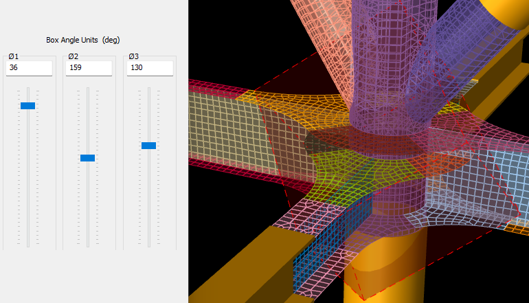

9. The orientation of the re-mesh box can be adjusted using ɸ1, ɸ2, ɸ3 angles with respect to the global coordinate system.

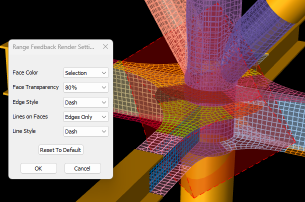

10. To adjust the face color and transparency, edge and line styles, and to display additional lines on the surface of the re-mesh box you can use the Bound Preview Settings.
  1. Face Color adjusts the color of the re-mesh box.
  2. Face Transparency adjusts the transparency of the re-mesh box.
  3. Edge Style adjusts the edge style of the re-mesh box.
  4. Lines on Faces controls which lines are draw on the re-mesh box.
  5. Line Style adjusts the line style of the re-mesh box.
