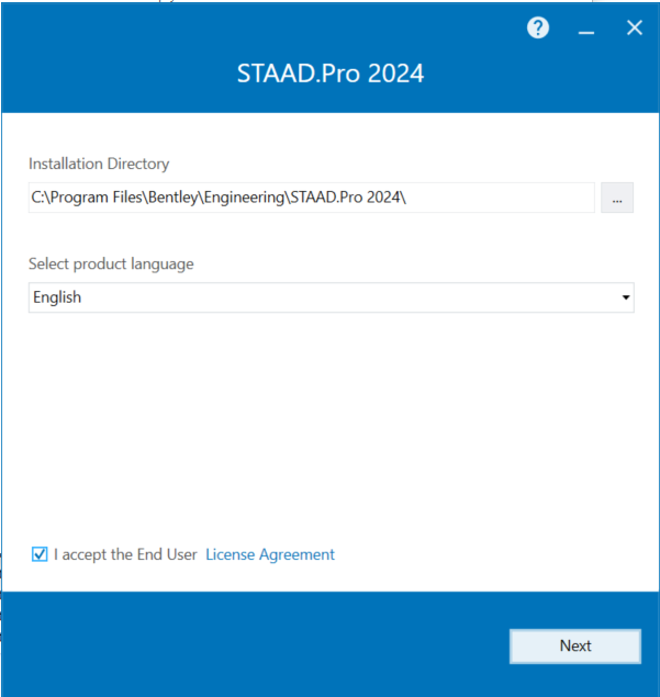

    This should result in the following dialog being displayed:-
  1. Define the location where the default installation should be located on the end user’s machine.
  1. Review/Acknowledge the license agreement and click on the Next button.

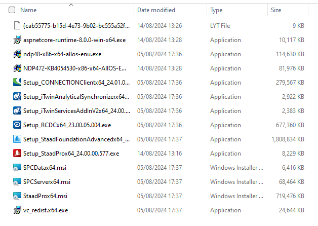

  5. Monitor the defined layout folder until it contains the following 14 files with the following sizes:- A screenshot of a computerDescription automatically generated
  6. With all the above files downloaded, the layout image has successfully completed, however as noted above, the download dialog box does not identify that the process has completed and thus needs to be terminated using Task Manager.
