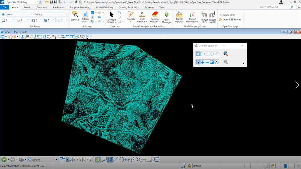

OpenSite Designer UI
Introduction to the Interface
This video expands on the Interface and helps you get familiar with OpenSite Designer. In this video, you will come to know of the following topics:
· Firstly the Workspace & Workset
· Secondly the Welcome Page
· Thirdly the Various tools
· Search Options
· Help function
· View windows
· Lastly the Display Styles etc.
