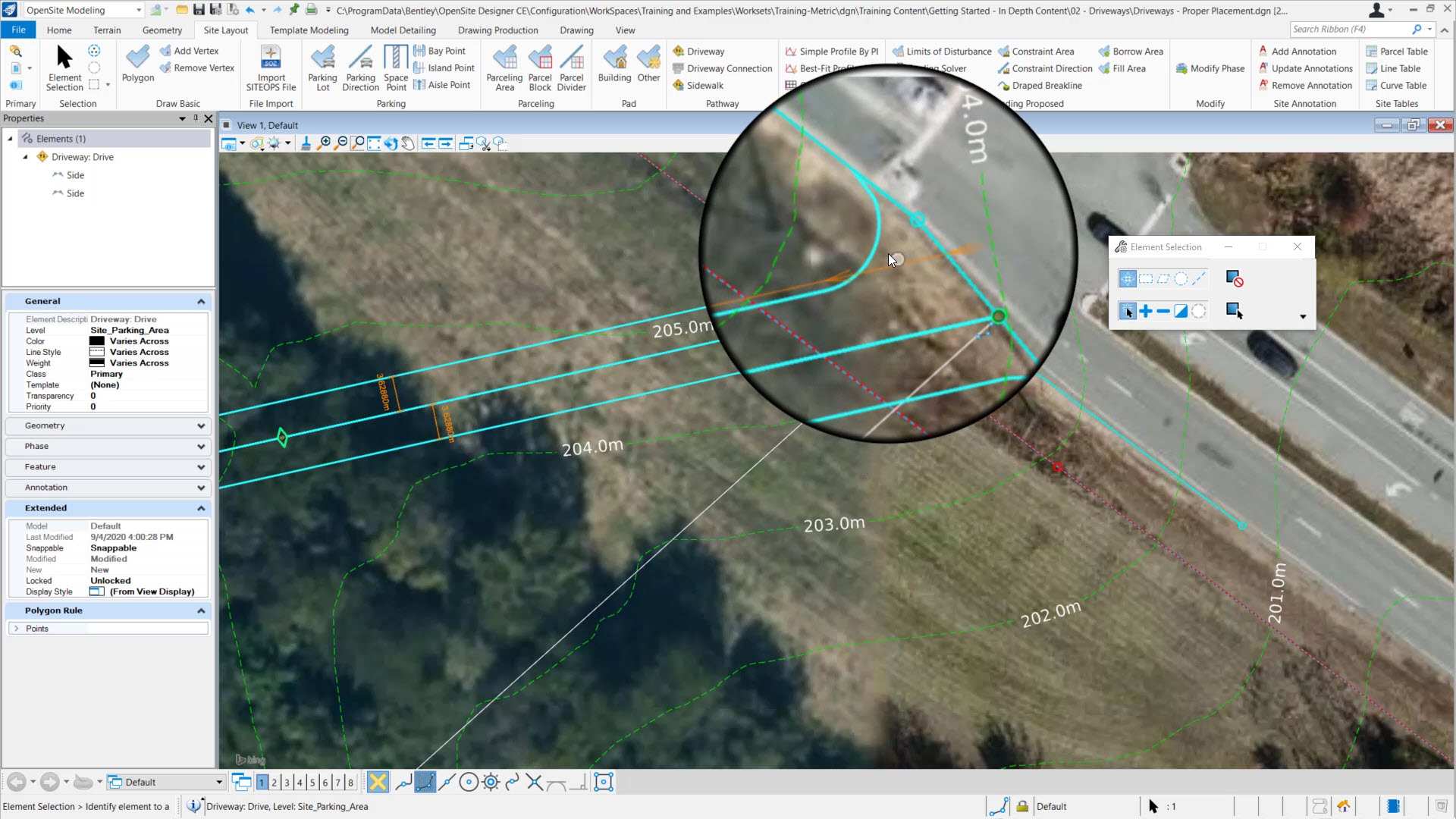

Driveway Connection
Create a Driveway Connection
In OpenSite Designer, a driveway is a linear element with properties that control its material and grading characteristics. As you click to place the object, points with radius properties are created. These points act as intersections of tangent sides or PI’s. This makes it easy to place the Driveways then edit the point and side properties to model your concept without complicated design settings. Driveway Connection helps with the transition from conceptual grading to design models.
This video explains how you can create a Driveway Connection. Go through the video and try the same at your end.
