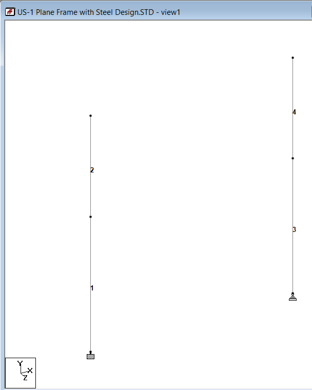

        ''To create view1
        count = 4
        ReDim varMembers(count)
        For i = 0 To count - 1
            varMembers(i) = i + 1
        Next i
        objOpenStaad.Geometry.SelectMultipleBeams (varMembers)
        objOpenStaad.View.CreateNewViewForSelections
        nName = "view1"
        overWrite = True
        varReturnVal = objOpenStaad.View.SaveView(nName, overWrite)
        objOpenStaad.View.CloseActiveWindow
        objOpenStaad.Geometry.ClearMemberSelection

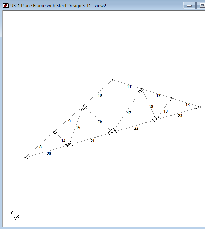

        ''To create view2
        count = 16
            varMembers(i) = i + 8
        Next i
        nName = "view2"
        overWrite = True

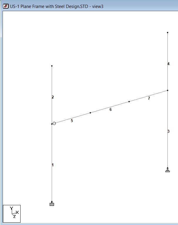

        ''To create view3
        count = 7
        Next i
        nName = "view3"
        overWrite = True

View1:
View2:
View3:
