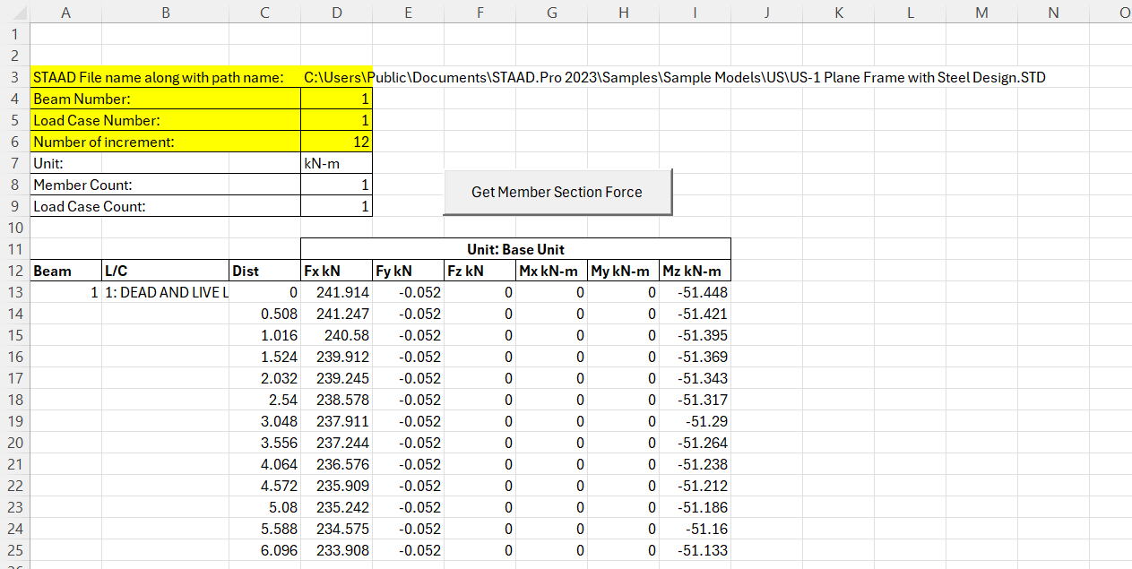

How to use the macro:
Input:
Cell D3: STAAD File name along with path name
Cell D4: Beam Number
Cell D5: Load Case Number
Cell D6: Number of section required
Once you have provided the input, please click on tab Get Member Section Force to extract member section force.
This macro is for only one specified member and for only one specified load case. The macro can be modified for multiple member and for more than 1 load case as per the requirement.
