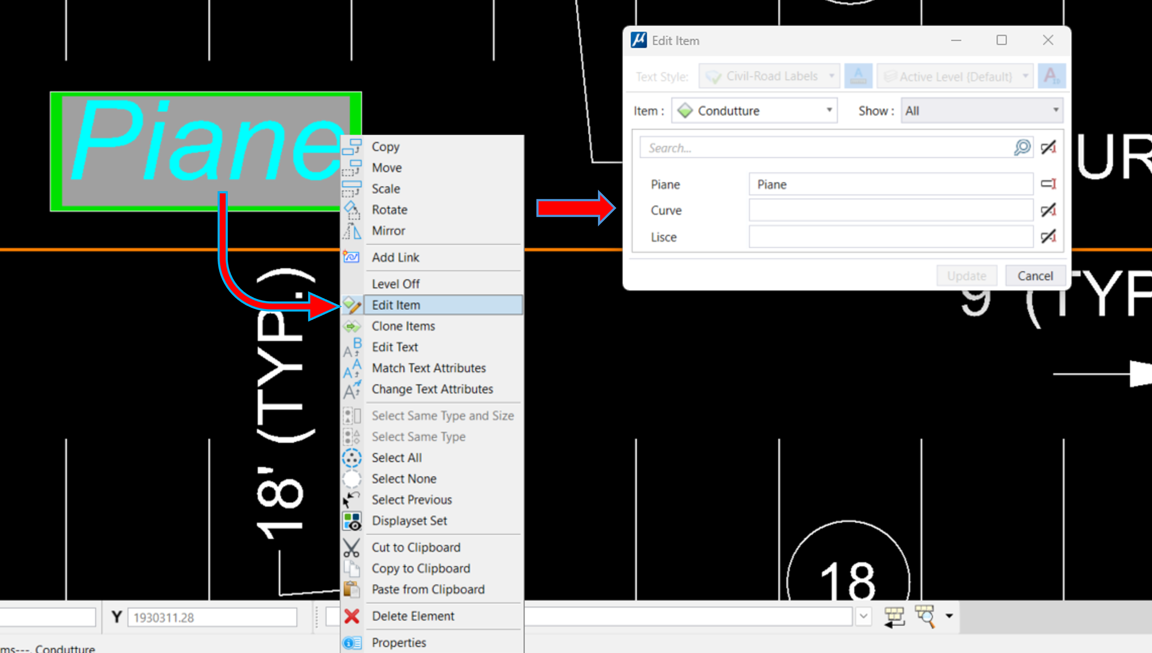

How to edit text associated with Item Type.
The text assigned to the Item Type can be edited by double-clicking on it or by using the Edit Item tool listed in the right-click menu.
Note: Editing the text of the Item Type with the context option "Edit Text" instead of "Edit Item" converts the text of the Item Type to normal text.
