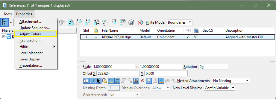

However, when plotted in this state without further augmentation - the reference attachment transparency will not be applied.

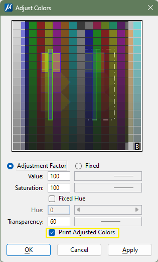

To cause the reference attachment's transparency setting to be applied to the print / plot output, select the desired attachment then from the reference dialog: Properties > Adjust Colors...
...and in the resulting Adjust Colors dialog, engage the Print Adjusted Colors setting:
