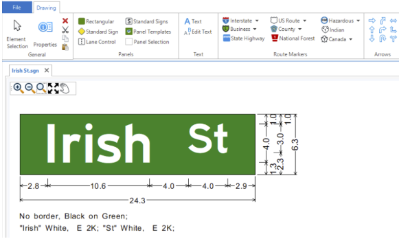

Step 1:  Select the file, sign or other element (arrow, graphic, etc.) to export.
Step 2:  Pick the File tab to go to the Backstage and pick Export. Select the Export to PLT or Export Selected to PLT option.

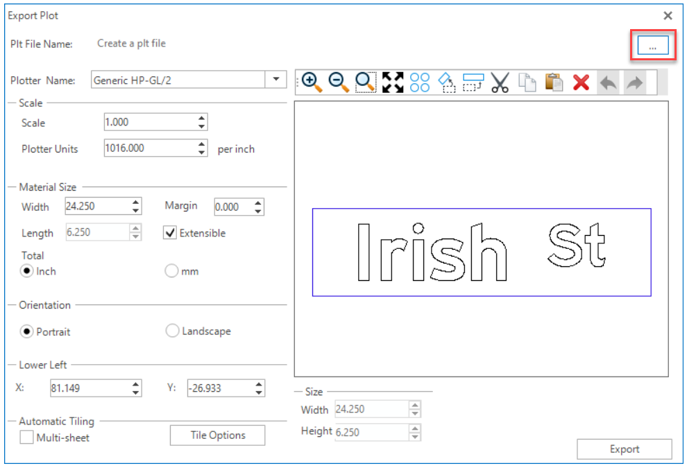

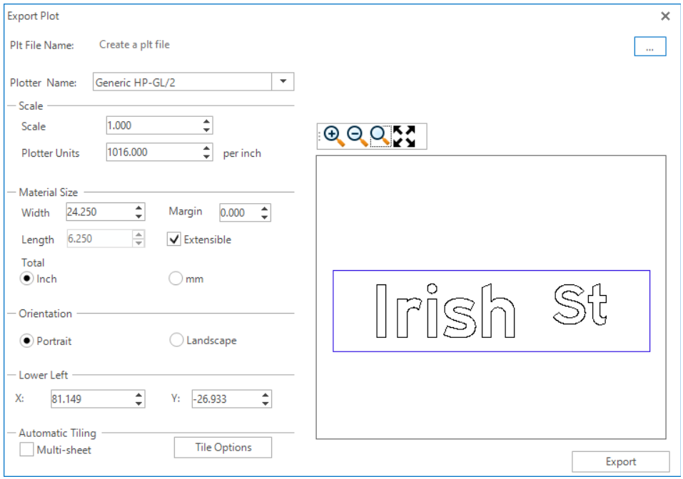

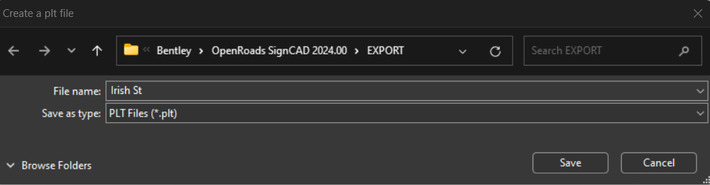

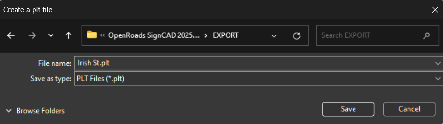

Step 3:  In the Export Plot dialog, press the button with the three dots to the right of the Plt File Name, enter a File name and press Save.

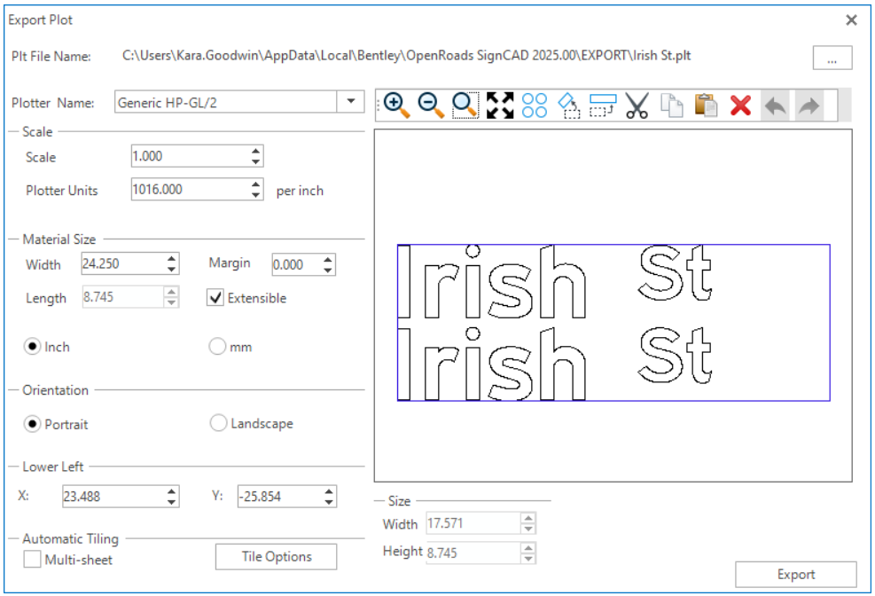

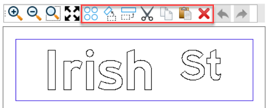

Step 4: NEW IN 2025 - Use the editing tools in the preview window (Array Copy, Rotate, Scale, Cut, Copy, Paste and Delete) to make changes before exporting.

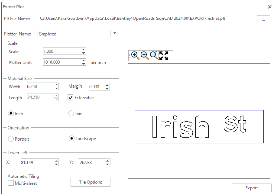

Step 5: Set the desired Export Plot parameters and press Export to generate the PLT file.

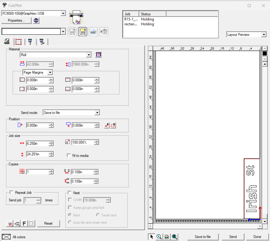

Step 5: Bring the saved PLT file into your cutter/plotter software to cut the sign.
