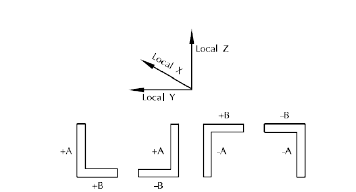

The orientation of an angle section is determined from the signs of the A and B dimensions input on the 'SECT' input line.

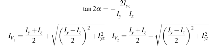

SACS IV uses properties about the member principal axes for stiffness calculations.
Normally, the cross-section input local axes are axes of symmetry and are therefore principal axes. For angles, however, the input axes are not principal axes. Therefore, the inertia properties calculated about the input axes must be transformed to the principal axes by the program using the following:

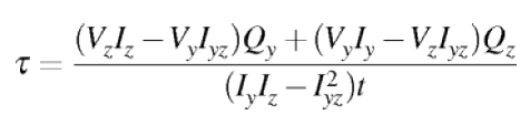

The shear stress at any point is calculated with respect to the local coordinate system using the following equation:
Where:
Iy, Iz, Iyz = Inertia properties with respect to Y and Z axes
Vy, Vz = Shear in Y and Z directions
t = Thickness
Qy, Qz = First moments about Y and Z axes of a portion of the cross-section area between the point and the free edge (Shaded area in the figure below).
