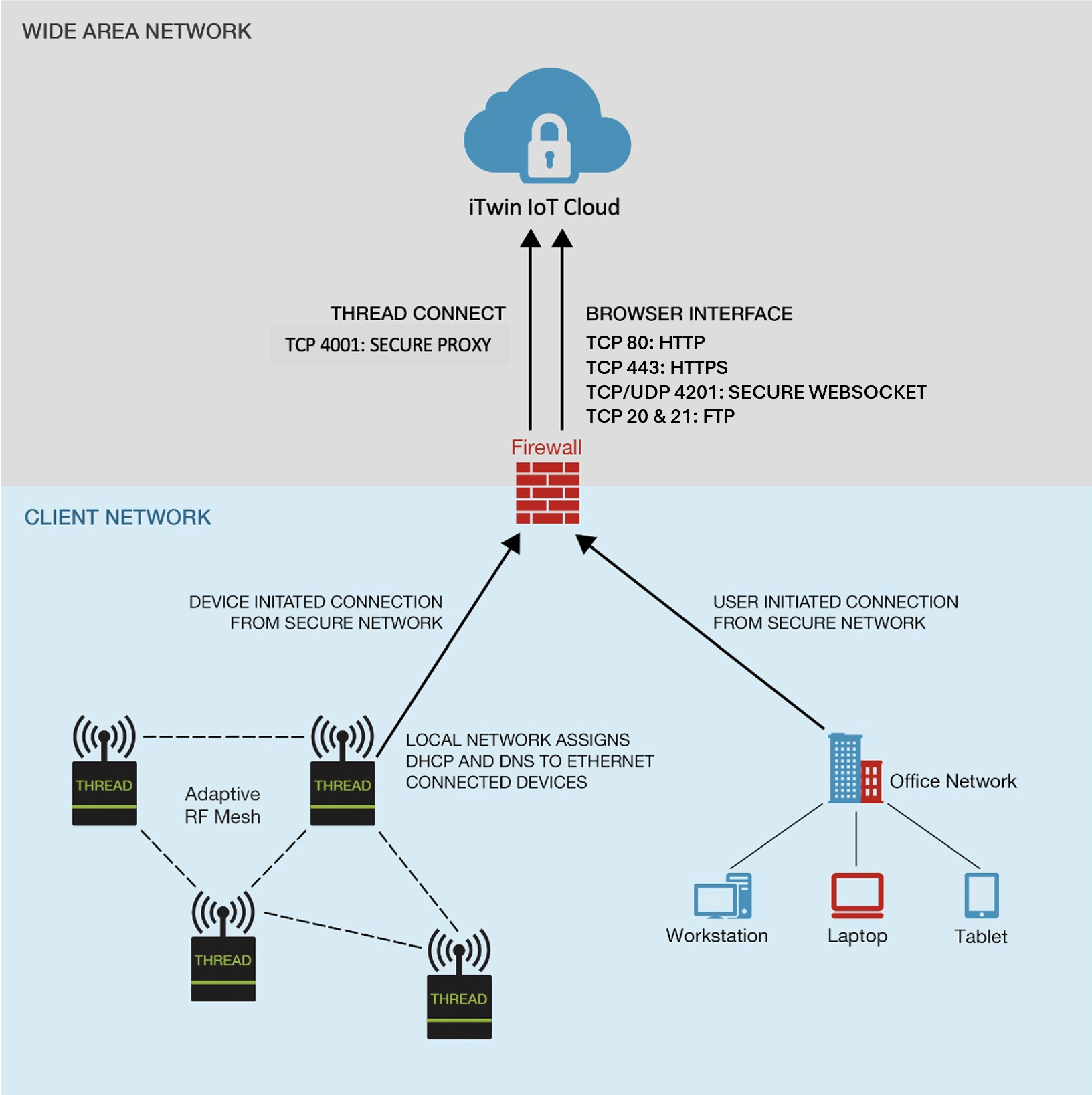

While most network configurations support the use of WebSockets, some networks with firewalls or proxy servers can block WebSockets from functioning. If your WebSockets are not enabled, try the following:
Browser Compatibility- Older web browsers do not support WebSockets, so it is important to keep your browser up to date.
Networks and Proxy Servers- If your network uses a firewall or a proxy server, ensure that it is not blocking WebSocket traffic on TCP port 4201. HTTP requires TCP port 80 to be open, and HTTPS requires TCP port 443 to be open. If Threads are in use on the project, TCP port 4001 must also be open. You may need to contact your organization's IT personnel to confirm this. Since WebSockets are a relatively new protocol, many proxy servers do not support it. Your proxy server may need to be upgraded to enable WebSocket support. Ports 20 and 21 must be open to enable FTP push.
TCP Port Function TCP Port Required
HTTP 80
HTTPS 443
Secure WebSocket 4201
Threads 4001
FTP 20 & 21
