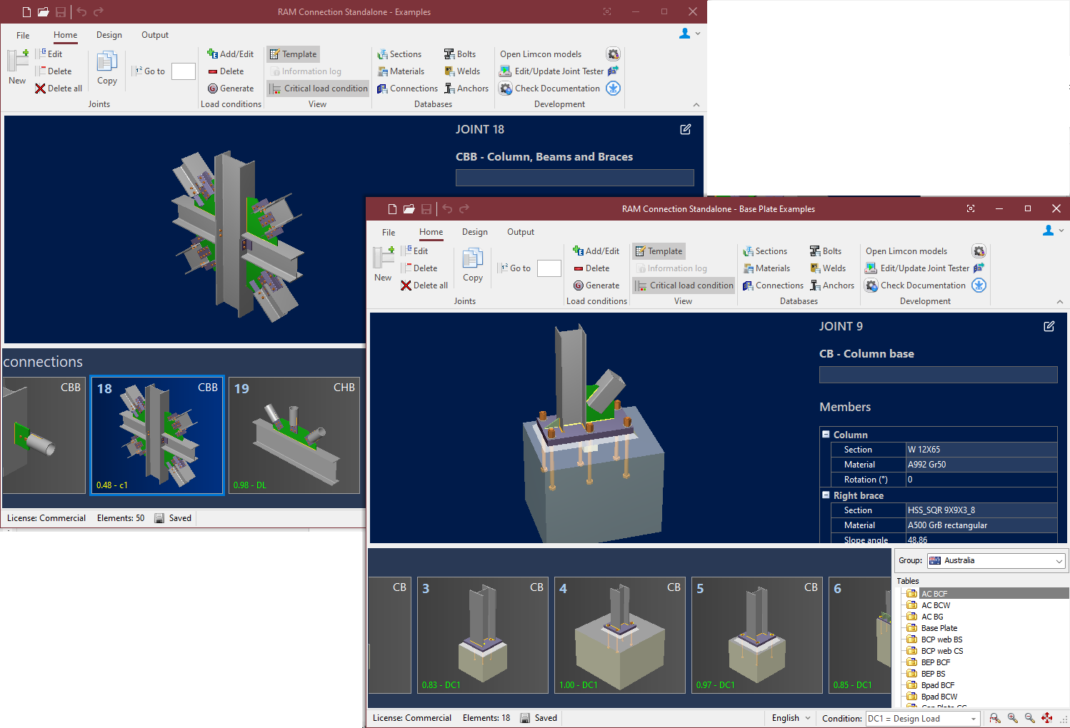

RAM Connection 2024 (v24.0.1) Release Notes
RAM Connection 2024 (v.24.00.01.237) Release Notes – Updated July 2024

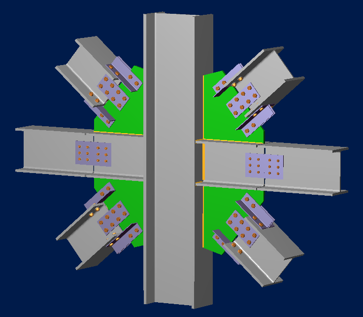

2New AISC bracing gusset with beam stub and splice connection including seismic provisions: Now the column-beam-brace gusset connection has the option to define a beam stub and a splice for both beam left and beam right interfaces, incorporating seismic provisions.
Figure 2. CBB gusset with beam stubs and splices.

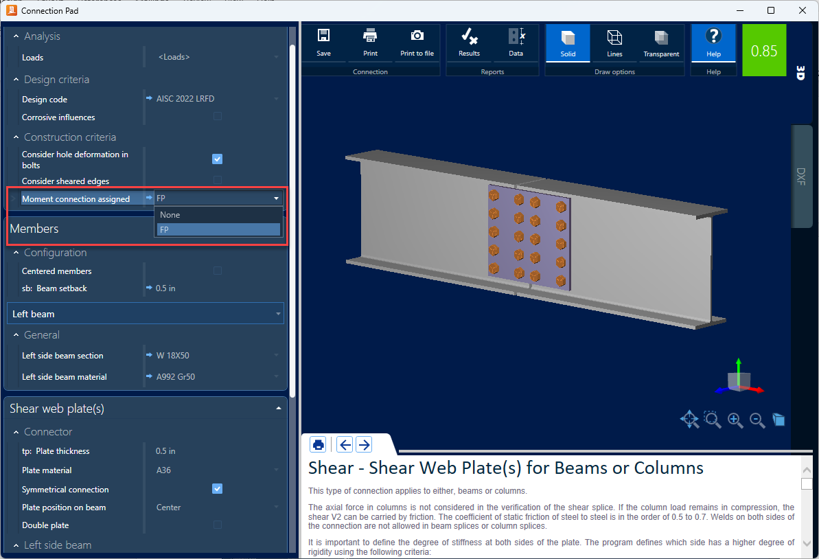

4Integration of moment connection information in shear connections to manage demands between connections in the same joint:  Previously, joints with both shear and moment connections were conservatively considered to have axial loads in both connections. Now, when a shear connection in a joint detects the existence of a moment connection, the axial loads are treated correctly, ensuring more accurate and efficient load management between connections.
A screenshot of a computer
Description automatically generated
Figure 4. Moment connection info in shear connection.

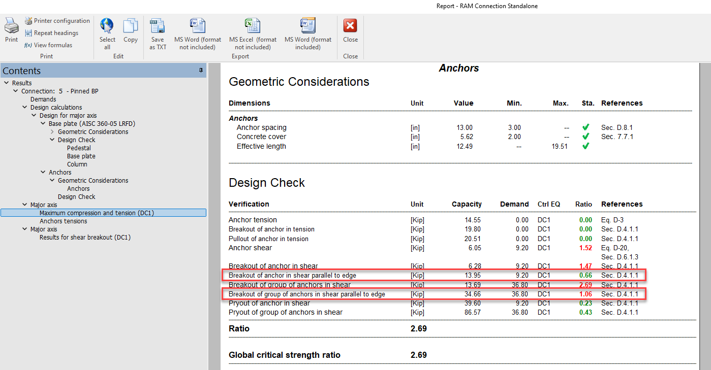

5ACI 318 anchoring to concrete enhancements to consider moment caused by shear lug and parallel shear breakout:  Several enhancements have been made for anchoring to concrete design using ACI 318. Now, the parallel shear breakout is calculated and reported for both axes. This is particularly important for anchors with a larger longitudinal distance to the edge than the transverse edge distance, as the parallel shear breakout can become critical.
Figure 5. Parallel shear breakout for single and group of anchors.
Additionally, for ACI 318-19, the moment caused by the column shear and the shear lug bearing is considered when determining the tension acting on the anchors.
